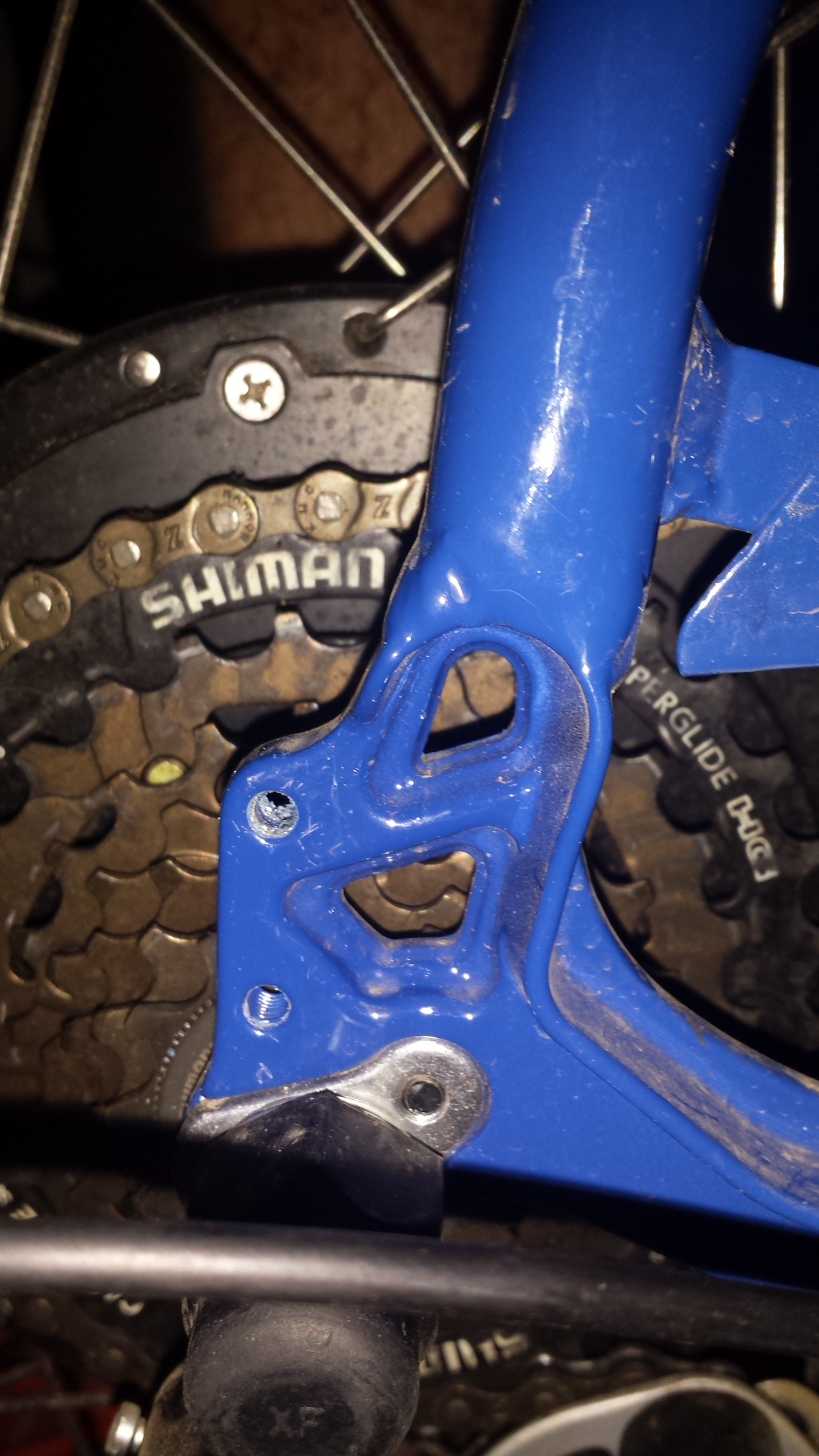

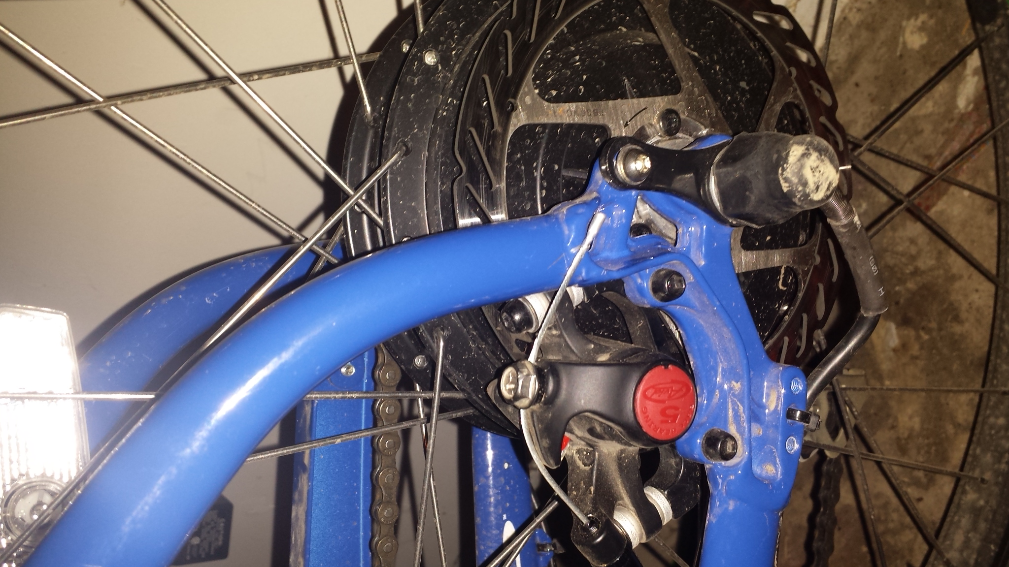

Part of the problem is the boss locations on the rear frame of the Zuma. I've included some pictures so that you can see where my problem is. On the left side of the bike, there are two holes that are side by side and they are right below where the brake caliper is. On the right side, the two holes are vertical (one on top of the other) and they are towards the rear of the bike where the frame curves down right above the axle. The holes on the left side are probably something like an inch and a half or so forward of where the holes on the right side are. So if I were to bolt it on, the rack ends up crooked since the holes on either side of the bike do not line up.
Every other rack that I have looked at seems to be identical to mine where there are basically just the two posts/legs (whatever you want to call them) that come straight down and bolt to the frame. I've only seen two people on the 'net with a Zuma who have a rack on it, so I know there has to be a way to get something to work. I don't know if they fabricated a bracket or what and I can't get them to answer my questions or post up pictures.
Here are pics so that you can see what I'm talking about:
Left side (sorry, I don't know why it's posting the pic sideways when it should be vertical)
Right side
Right side

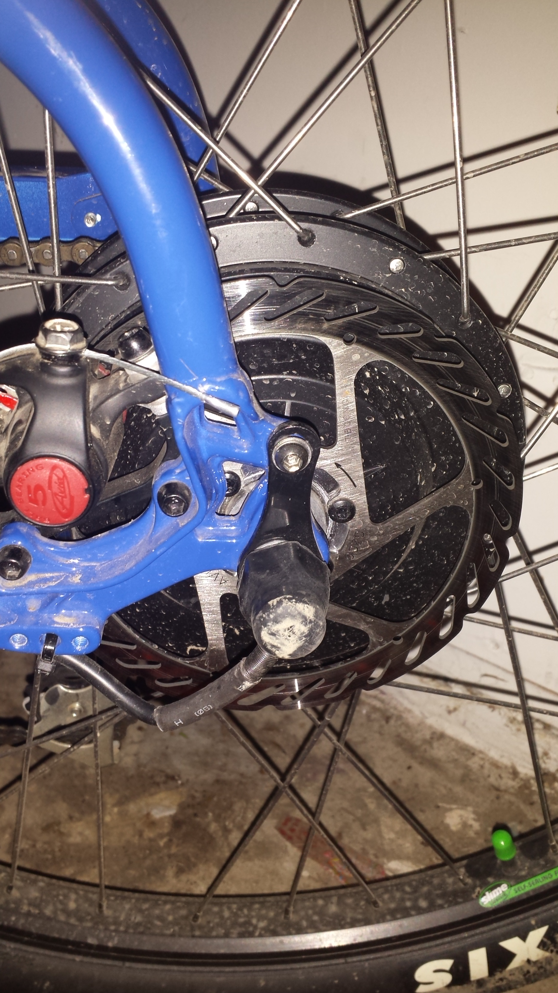

There is a bolt that I can take out (would have to replace with a longer one obviously) on the left side that is holding a bracket in place right above the axle. I went back and played around with it yesterday and I think it will work, I just don't have the right length bolt handy at the moment (short one is too short and the long one ends up sticking into the disc - I don't have anything to cut it down to size at this moment). If I use that point, it comes pretty close to lining up with the holes on the right side of the bike. I have to work all day today and tomorrow morning, so I will probably mess around with it tomorrow afternoon after I get home. If all else fails, I'll try to see how much I can bend the rack as you suggest.
Here is a pic showing the point I'm talking about (silver bolt on the black bracket right above axle - brake cable is pointing at it):
That screw/bolt looks like it is the torque arm. This anchor point to keep the rear axle from spinning needs to be relatively tight. The material of construction on your rack may be softer than the torque arm material?? You may not be able to tighten the bolt/screw to the proper torque without crushing the rack material. A thought might be to consider small washers on bothe sides of the rack leg. Another option would be to use a different hole? Another could be to drill and tap a small hole for the rack. Another would be to use a clamp round one of the frame bars?? Lots of options just take your time and look for the best solution and check the torque requirements for your torque arm.
Good point on that - I wasn't thinking about that being the torque arm. The bolt that holds it in place is TINY anyway and wasn't very tight, but good point nonetheless. Drilling out new holds is definitely a possibility, but I really don't want to do that and I really shouldn't have to. Definitely an option, but I'll keep that as a last resort.

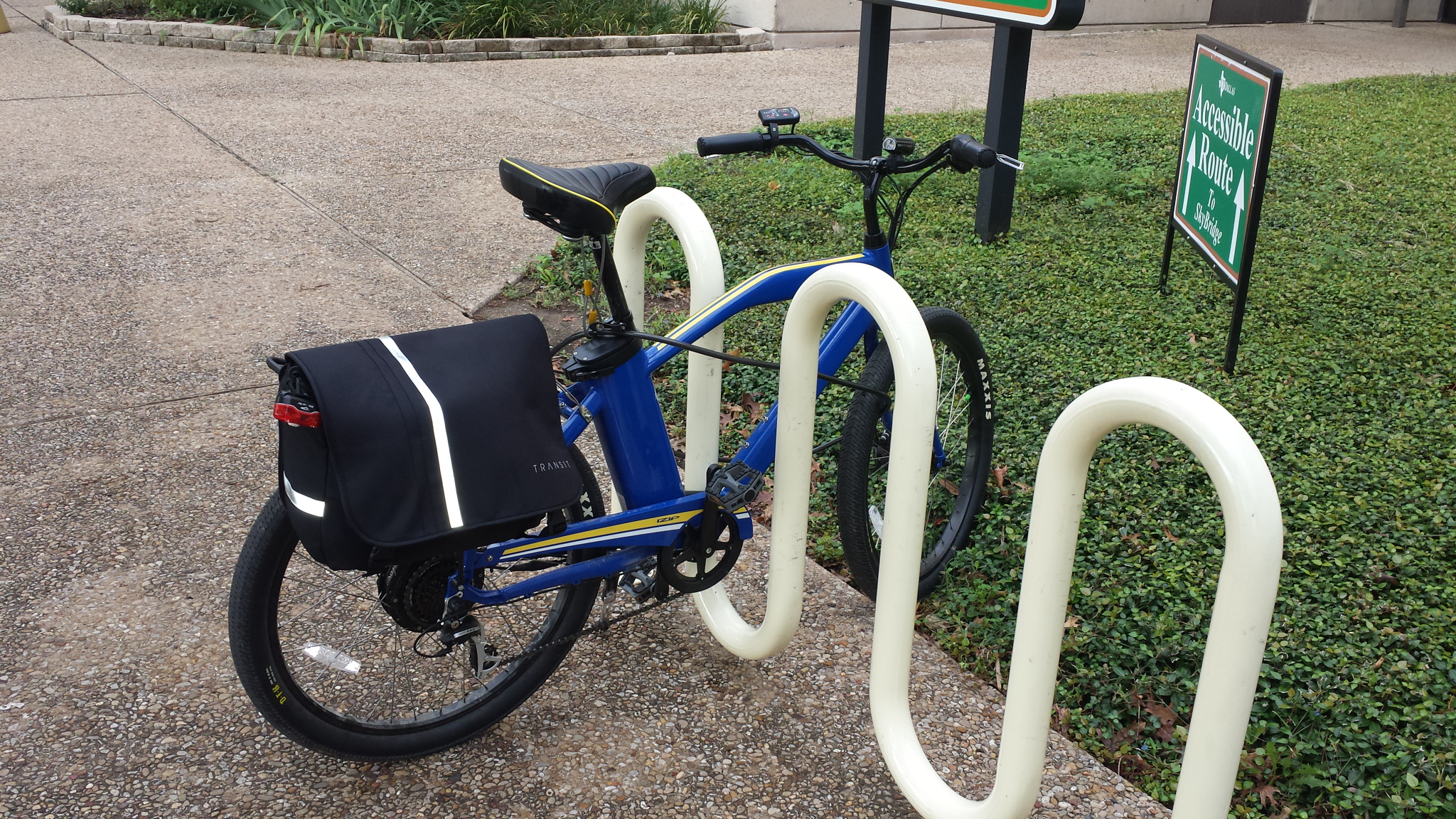

OK, so several trips to Home Depot later and some time sweating to death in the Texas heat, I was able to get this installed today. So all I ended up doing was this - I ended up using the shorter of the two spacers on the right side of the bike. With that spacer in place, the left side of the rack lined up where it was supposed to on the left side of the bike. A combination of appropriate length bolts, spacers, and nuts and the rack was installed. It's still not really 100% perfect, but it will do until I can find a better quality rack. I can actually pick the bike up using the rack, so it's sturdy enough. I took a ten mile ride to check out how it works and to make sure everything stayed nice and tight - did the trick and it was only $23. Pics:
No luggage yet, so I just used a bag and a bungie net. Like I said, it's not 100% perfect in fit and alignment, but it will work until I can get something better down the road.

Haven't done any updates in a while, so here's one. School started this week and I've been riding my Zuma to and from school (about 20 miles). It's nice because I get the exercise and I also don't have to deal with campus parking (which appears to be rather horrible this year). Anyway, here is a pic of my bike kitted out for the commute (need to find a better pannier system though, this bag is just too small for what I'm hauling).
