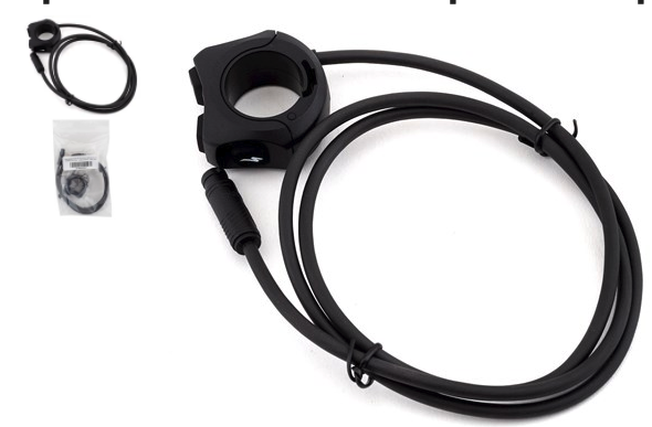

I think it's for a remote mode control (like the Levo SL).
I've wondered about that extra connection. It either had to be a connection for the TCD-W or a connection for a remote mode selection switch. If it is for the remote mode control, perhaps one can purchase the remote control and mount it on the Creo bars at a more accessible location.

I went and looked at my E5 and, yes you are correct about no port on the right but there is an unused port on the left of the top tube so I wonder if that is for adding the remote module? Would definitely be the wrong place for a dropper post.
Yes, that's the Turbo Levo SL remote with the wire built in to attach (we think) at the TCO (the one available port). The pic is a bad angle but there are +/- buttons on it.
