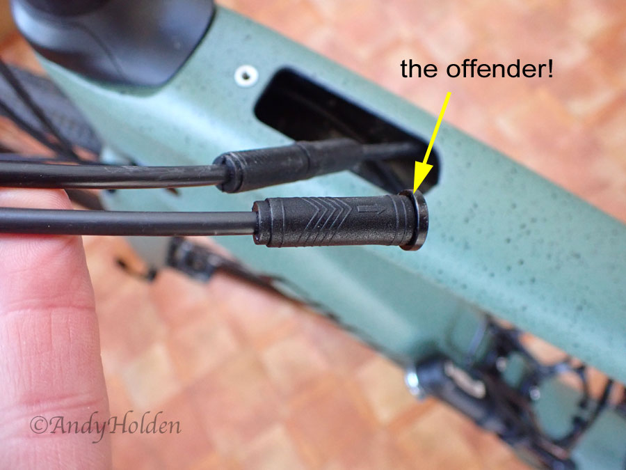

2. Squeaking Futureshock cover [FIXED]
This is SUPER annoying! And hard to troubleshoot. If I turn the handlebar left and right, there's no noise. But the moment I ride the bike, the noise will pester me throughout the ride. I grabbed the entire cover and the noise disappeared and the moment I released it, the noise comes back. The local Specialized technician argues that the lip part maybe rubbing the frame but it does not. I can put a sheet of plastic and paper between the lip and the frame and they don't touch (maybe when riding, which I still have to test.
