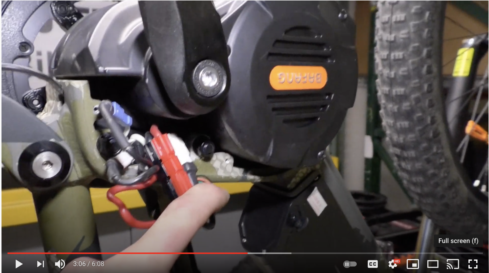

Here's a still showing the setup. Note the bike is upside-down on a stand. On the good side the wire connections are towards the back of the motor, away from the front downtube, so maybe not as bad as I initially thought.
Thank you very much for the replies. Looks like it still shares the cavity where slushy salty water will / has gotten in. I’m swinging your way. Maybe give it a day to dry out and slap some flex tape on there.
