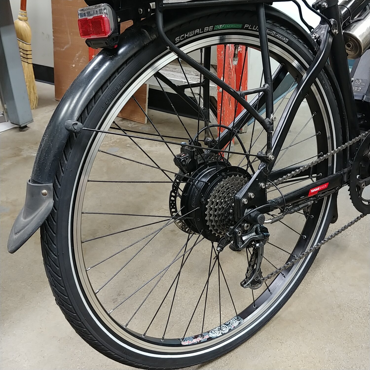

Pretty certain the same style clutch. I think there is only one other type for bafang gear hub motors which looks different enough to not mix up. In my case the clutch internals seem to have broken & started slipping (the gear grind noise) to eventually seizing (acting like a direct drive motor).

I actually just loosely assembled it 2 days ago since the rebuilt wheel I'm using from my original CC is on the verge of failing itself. Have to see if I can manage without a wheel build stand or dishing tool on hand. A little worried the spokes I bought might be a bit too long as they already poke through the nipple slot without the wheel tensioned yet.
I tried looking at wheel build guides, but ended up assembling it to match the pictures of the spare wheel on Juice's site.
It doesn't use the same spoke length since the DM24's profile is lower then the OEM rim.

Since Juiced has been out of stock of rear spokes for ages I’ve been buying replacement spokes from this eBay seller. He sells silver or black Sapim Leader 12g or 13g spokes and can cut them to any length. The stock length for Cross Current rear spokes is 232mm. But if you use a different rim I guess it could impact what spoke length is required. The clutch on my rear motor started slipping at about 18k miles. They are supposed to get a shipment of rear wheels this month according to support but my backup option, if that doesn’t pan out, would be to build a replacement wheel myself.

I on day 3 now with the new DM24 rim & name brand spokes locally bought from Yojimbo's shop that Dunbar linked. So far the rebuild is working, but I haven't fully rechecked tension yet. The spokes were a bit long by 1 to 1.5mm, but I was still able to tension them. Just slightly concerned that some of them are flush with the inside spoke holes. Put extra tape over those ones.

13g Sapim Leader spokes 238.5 & 237.5 for the drive side. I got these lengths off a calculator, but as mentioned it ended up longer then needed.
How did you know that you were supposed to order two different length spokes? My god. The things I don't know.
Online spoke length calculators. To accomodate the cassette the hub flanges are not centered with the rim so one side of spokes is more angled the the other. To have the same reach the side with more angled spokes needs to be longer.
