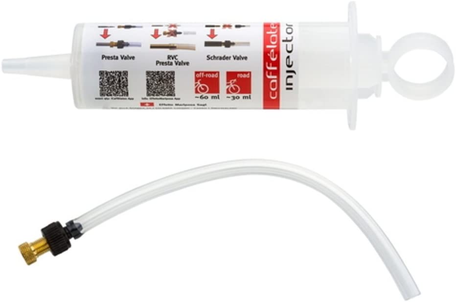

flat out wont go through a syringe. its just too thick. the tubes that come with them are too lose on presta valves. so its easy to make a mess. much off fills well not sure how well it works it likes to plug the valves or make them leak.
It goes thru a syringe just fine. Thats how I apply it. You're right the tubes that come with the bottles are too wide as they are sized for a Schraeder valve, but if all you do is put a Presta-to-Schraeder adapter onto the end of that factory tube, it works perfectly on a presta valve whose core has been removed. You just press it to the open valve and squeeze the bottle.
But thats not quite using a syringe. Look at the video I posted earlier in this thread about how to 'slime' presta tubes with non-removable cores. You can see in real time the guy successfully uses a meat marinade syringe and thats what I used as well. Only once in a blue moon will the slime clump up at the hole in the marinade syringe. You can clear it and apply the slime/flatout more gently and it won't clump.
Nowadays I only occasionally use a syringe if I need to for some weird reason (FlatOut will not go thru tubeless valves with an air flap at their bottom so uyou need the metal 'needle' to poke it open). I do it with a Caffe Latte sealant syringe. You can see right in the product pic they have a fancier version of the presta adapter on the end of the hose. I just stuff a generic ten-cent one on and it works fine. Funny thing in the product pic shown below you can see them describing visually the method I did above with a removable valce core (RVC) Presta.
