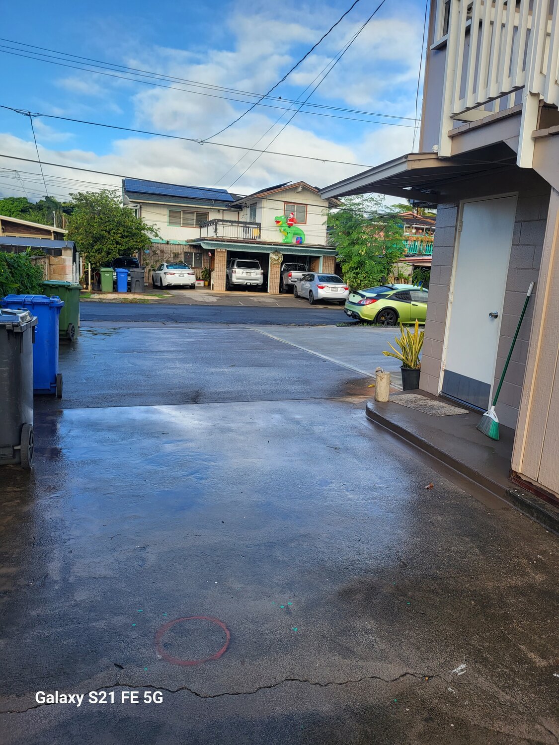

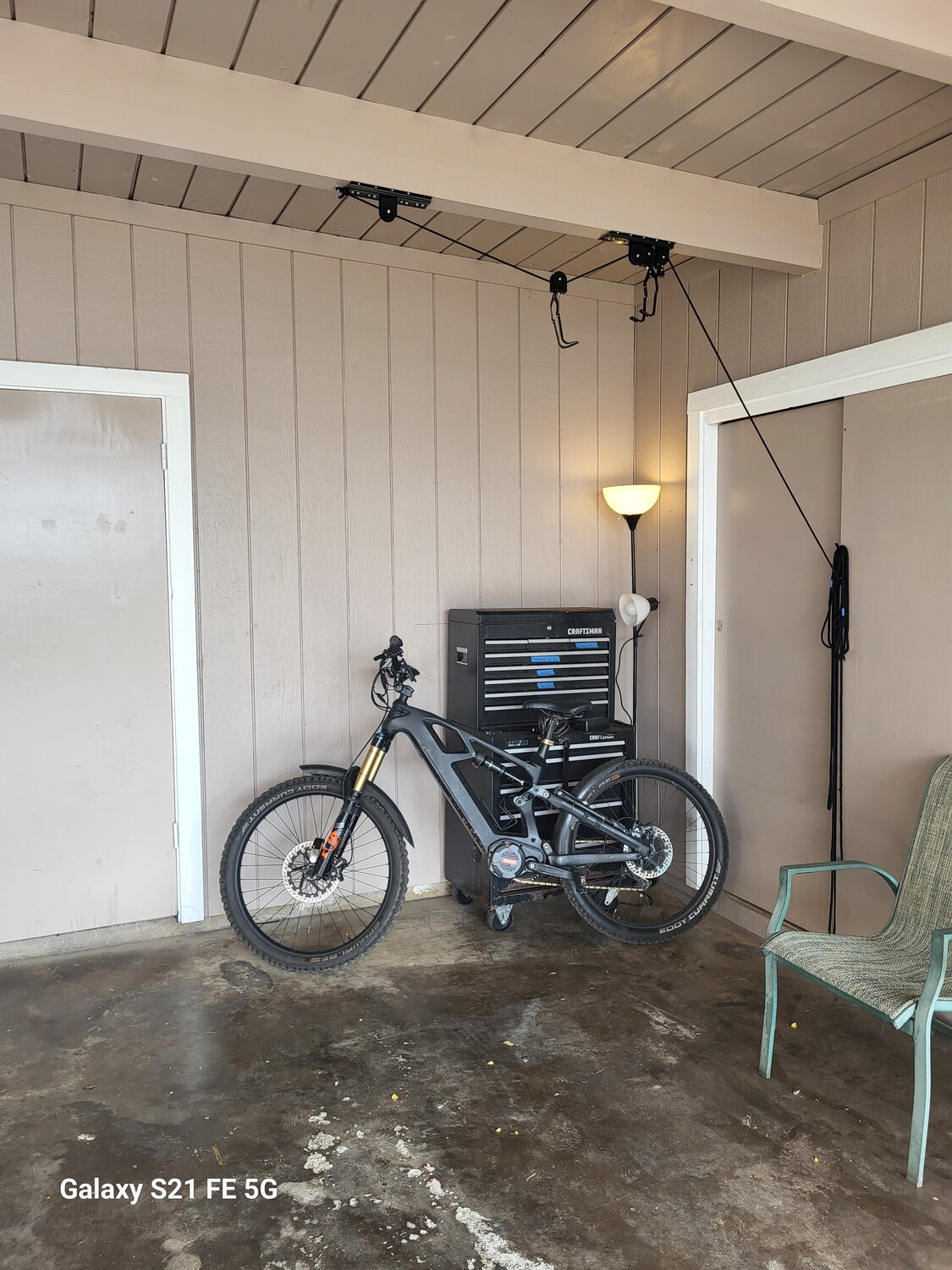

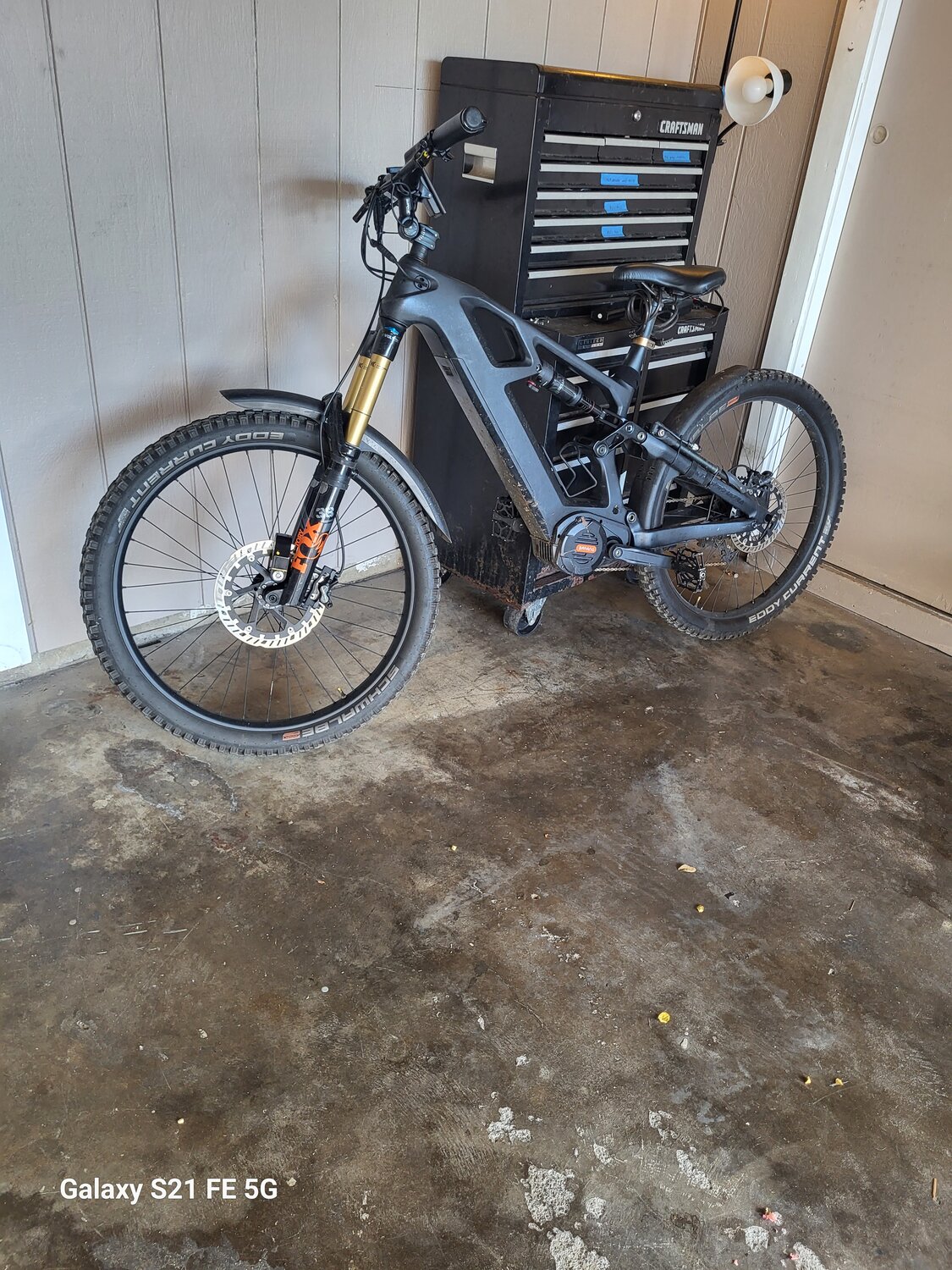

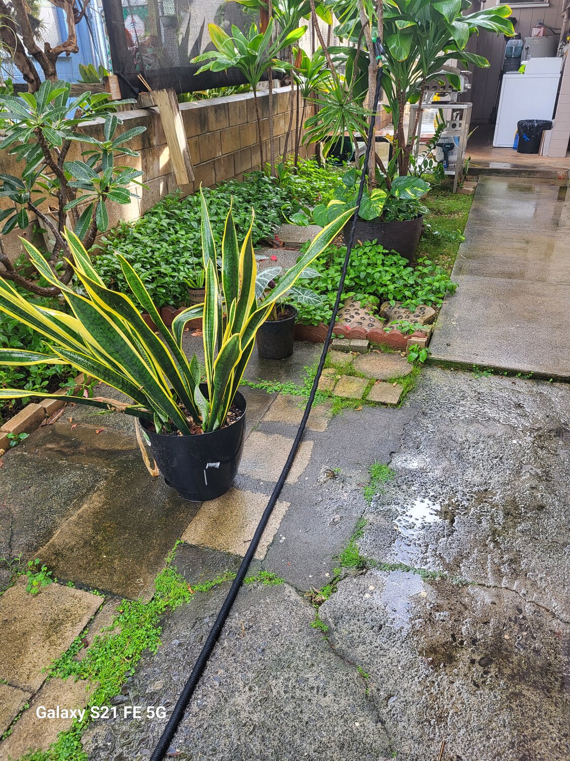

It's wet here raining sunshine and rain.
Zoom in at downtube that's a lot of road slime. I put a peel off sticker underneath.
Asphalt slime is difficult to take off when it gets stuck to your bike.
