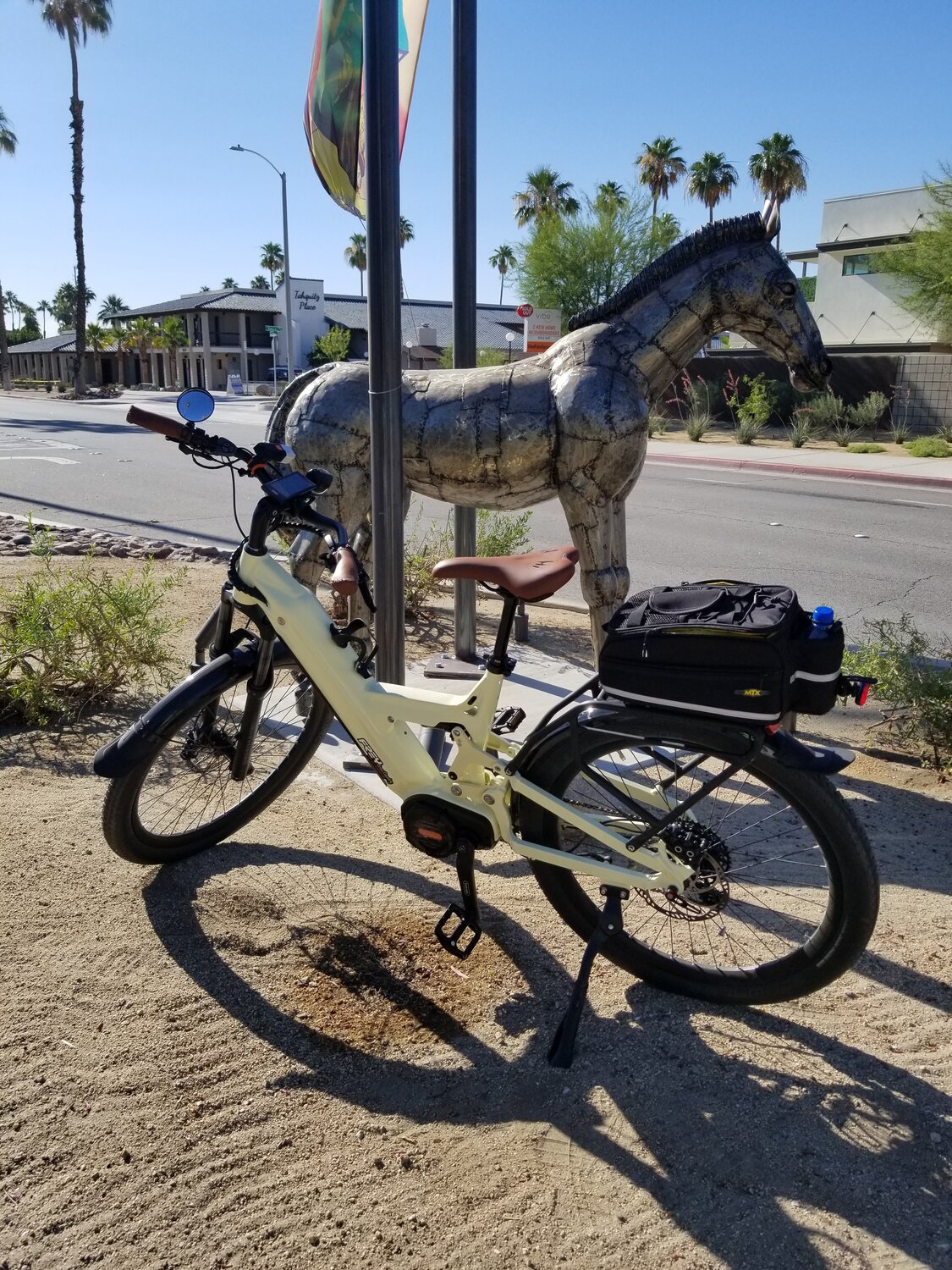

I only went full throttle only a few times on my Frey CC. 38 mph is way too fast for a daily commuter! I would not hesitate to use the CC as a commuter though. Very solid, great suspension and well balanced. It was just a little too heavy for me on my pleasure only bike path and sidewalk cruising. I think it weighed 72 but felt like 172 with my Topeak bag on the back...

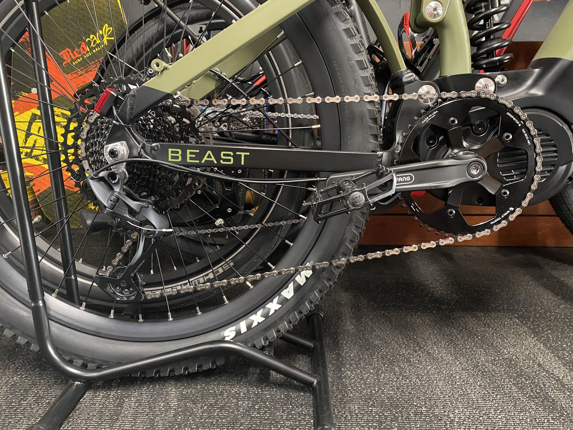

I use my Frey Beast to commute to work and love it after fitting a 48T chainring, but wasn’t a fan with the stock 40T chainring. Plush ride and dropper set post is handy. Magura brakes are awesome.
I can‘t comment on the top speed with the throttle as I’ve never tried it as I don't really use the throttle, but have seen 60klms/hr pedalling which is the speed cutout.
Range is surprisingly good for a bike with this much power (remembering the Beast M620 controller uses more volts and less amps) where the lowest PAS will generally get me around 40+ klm/hr on flat pavement with the Maxxis tyres with circa 30/24 psi front/rear. Cadences of 80+ will see the best out of motor in my opinion.
Pic after fitting the 48T chainring (and longer chain).

What was the problem whit the 40T chainring?
Too small. Change into the next gear and you immediately need to change again. Also mismatched for the top speed of the bike - virtually impossible to maintain top speed pedalling. You’re in top gear most of the time which is going to result in the smaller cogs wearing out sooner rather than later.
