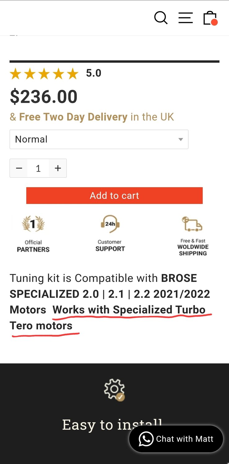

you wrote to or called twowheels to ask which kit would be suitable for your bike model
It says right on their website it works with Turbo Tero.
