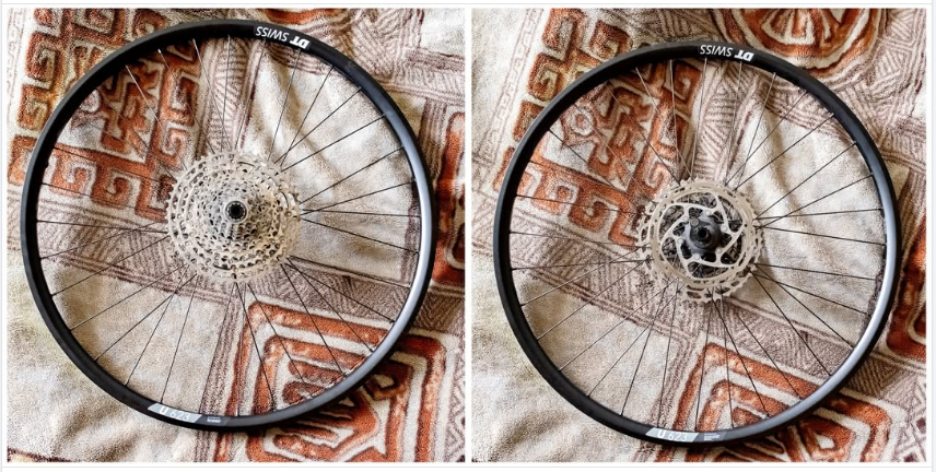

The custom rear wheel I ordered from a wheel builder for my Vado SL 1 4.0:
  • Hub: DT Swiss DT 350 Classic 12x148 mm, Centerlock (for the brake rotor and the speed magnet bracket), originally DT Swiss HG freehub for 11-speed later replaced with DT Swiss Microspline freehub for Shimano 12-speed cassette. 32 spoke holes.
  • 29" DT Swiss U623 rim, 25 mm internal rim width, 32 spoke holes
  • 32 Sapim Strong spokes.
I didn't order the front wheel. The problem here is the 12x110 mm Road Boost Axle. (My builder would have such a hub if needed).
Note: The U623 is the strongest DT Swiss rim, designed for e-bikes.
