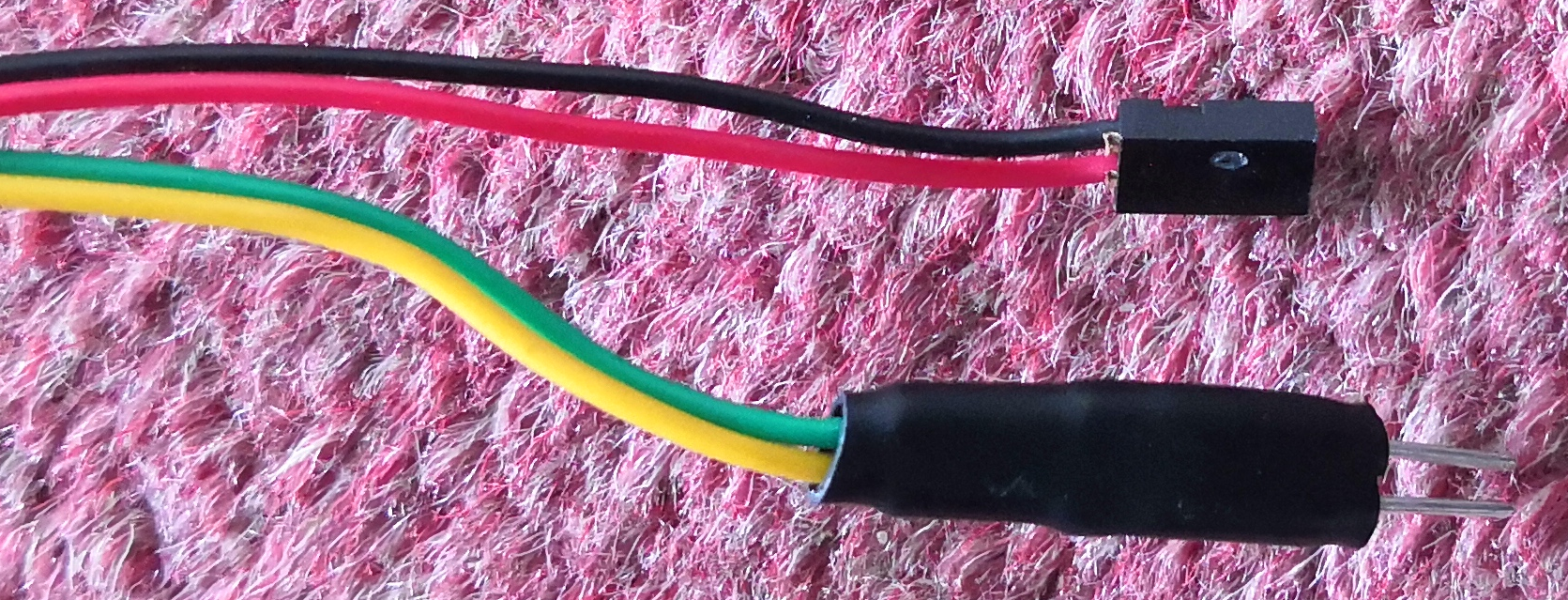

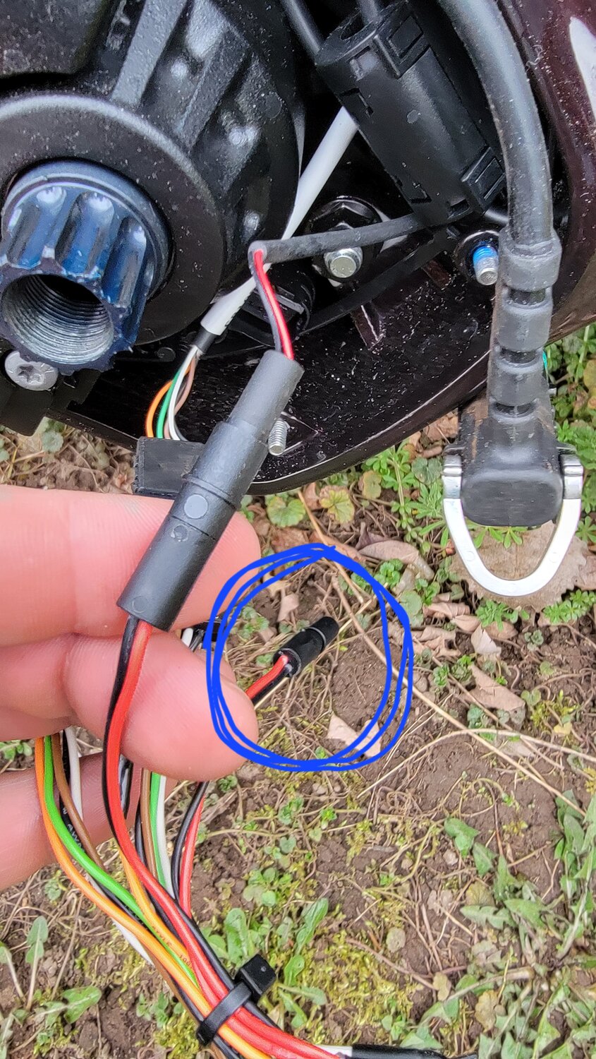

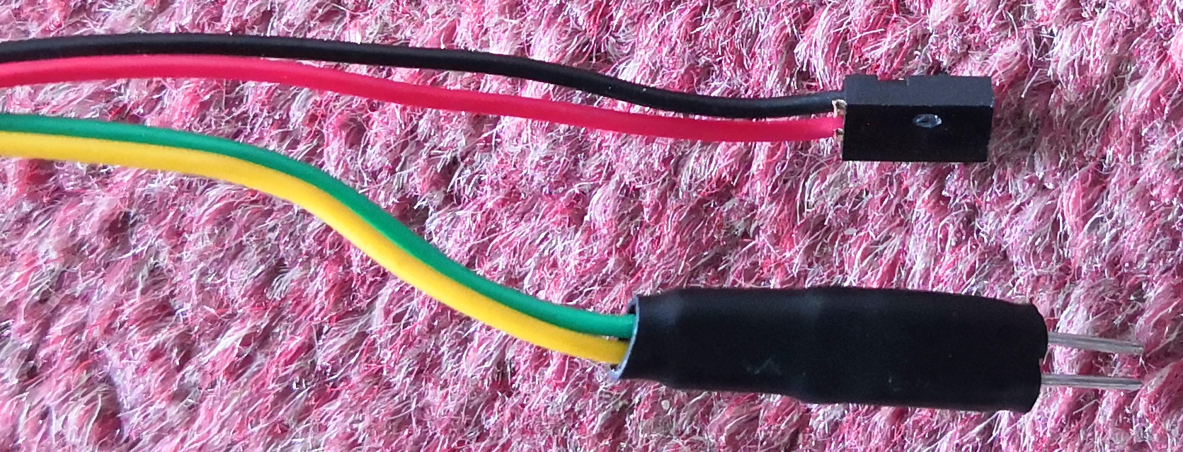

Yes, I'd seen that. Once of my concerns was that the motor speed sensor wire colours didn't match what was shown on the instruction sheet (which shows red+green & red+blue for the 2 cables - clearly my wires are not the same colours!). I'm awaiting manufacturer feedback on all this!
[the red+black connector goes onto the motor and the green+yellow pins push into the speed sensor connector (which was previously directly connected onto the motor) ]

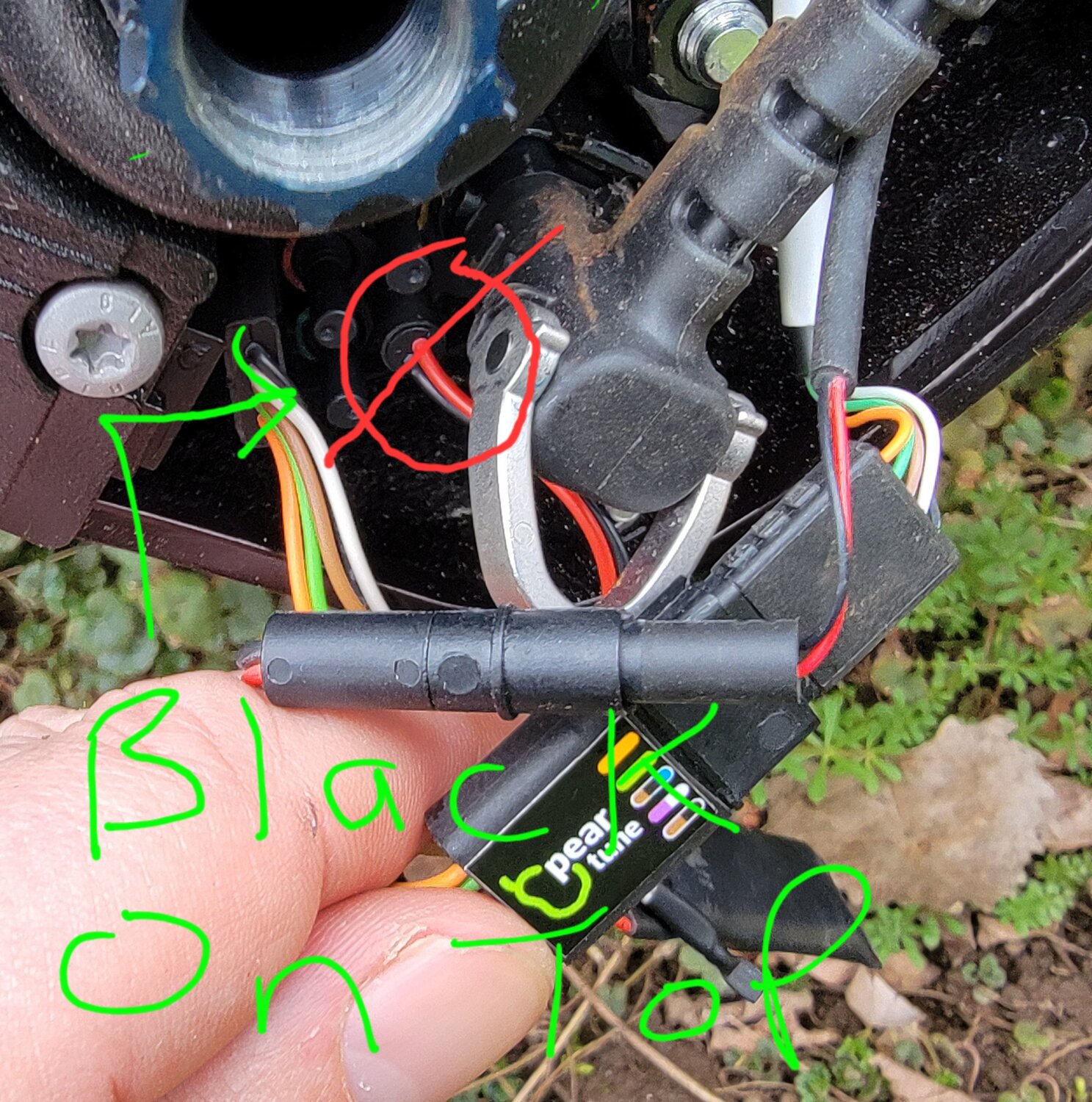

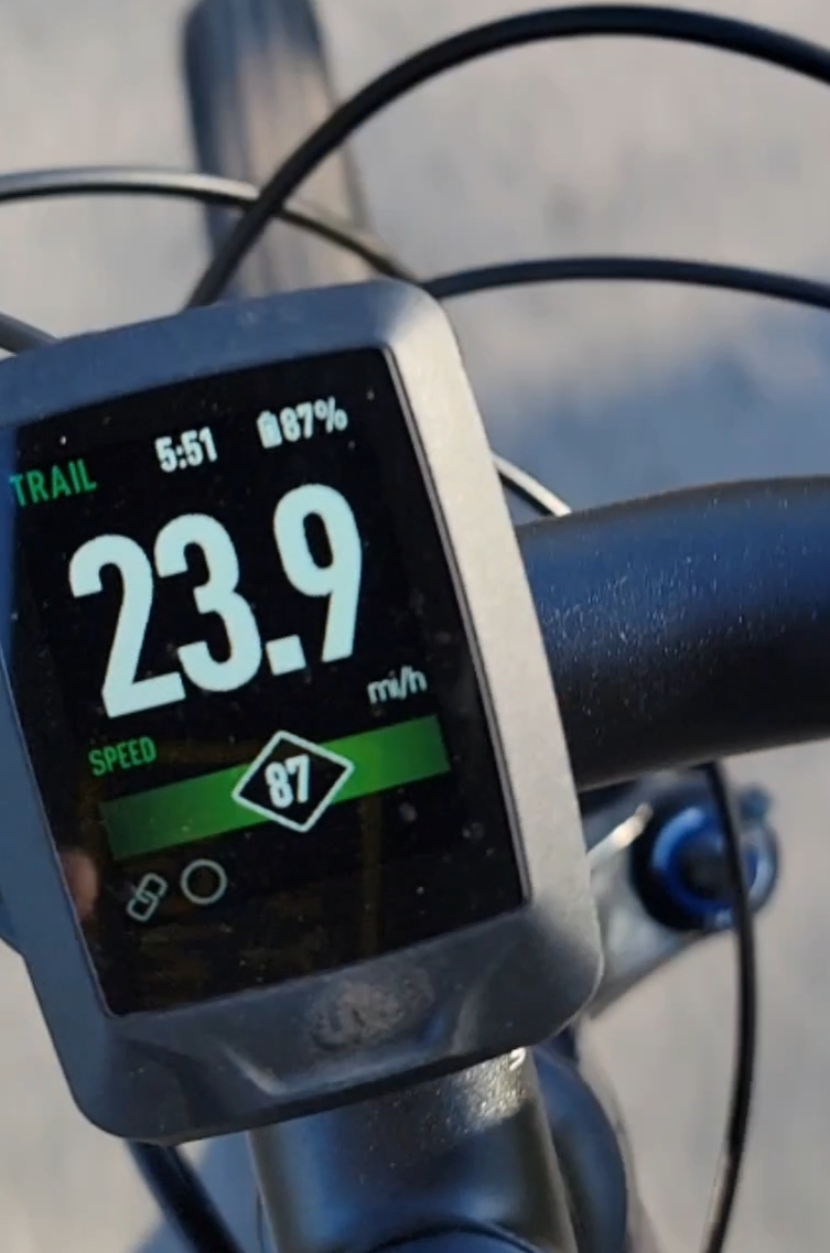

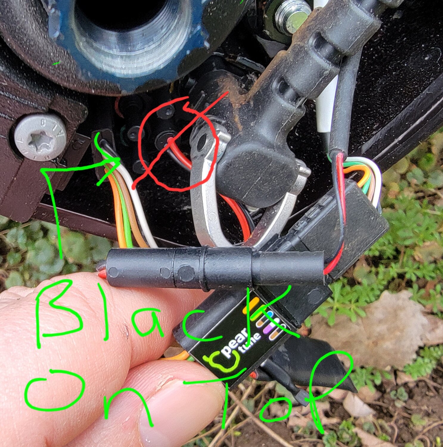

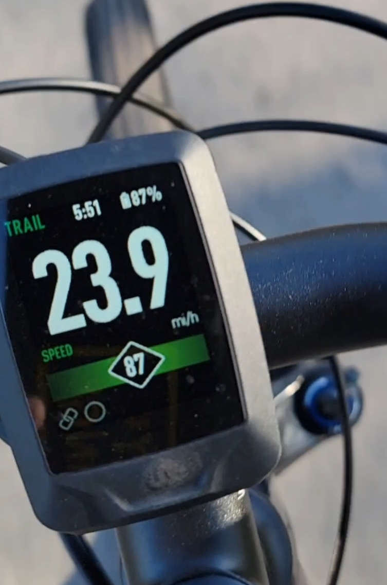

Big news! The PearTune 3.0 works! I had an epiphany while driving home from work today.

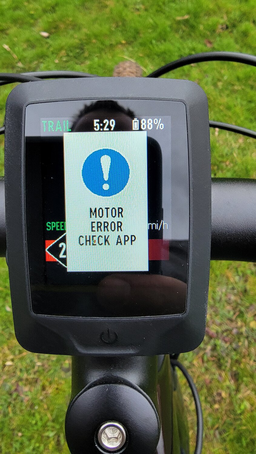

All of the connectors are made to only fit together one way... except for the very last connector! The round connector from the tuner to the bike motor can actually fit upside down. I installed this tuner 4 previous times and all 4 times I plugged it in upside down. I assumed it was correct and only fit one way like the other connectors. That was a wrong assumption. As soon as I figured out it would fit the other way I knew it would work.
They really need good instructions for this... or completely dummy proof the connectors so they all fit one way only.
So if you install this tuner and get a speed sensor error message, plug in the round connector with the black wire on top, NOT the red wire.
View attachment 119867View attachment 119869View attachment 119871View attachment 119872
