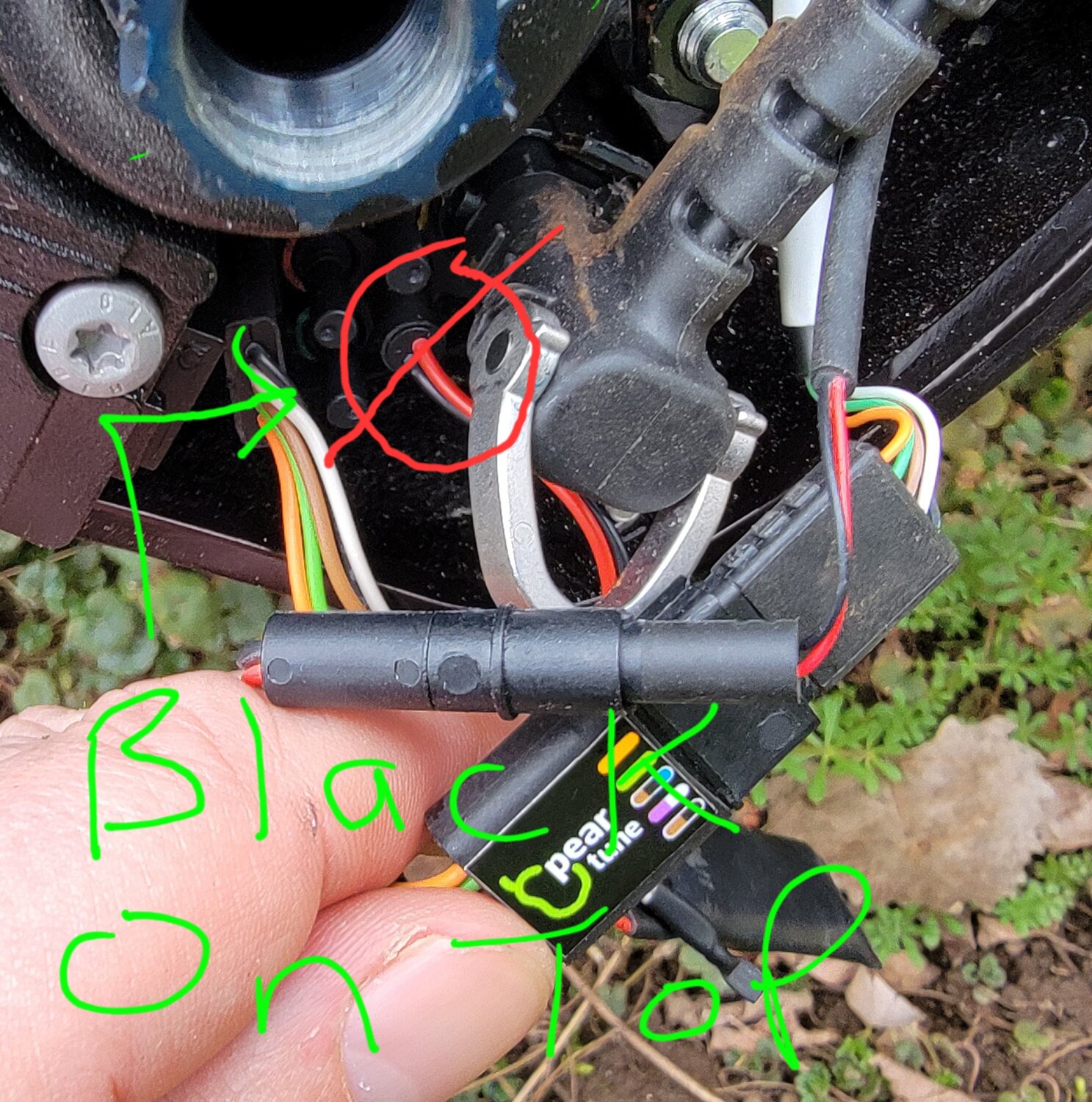

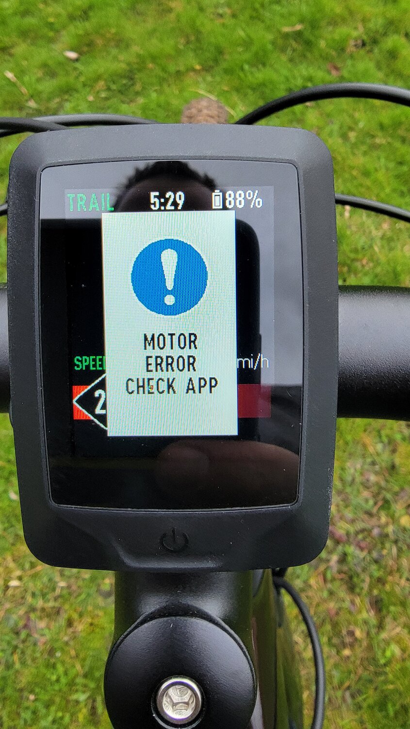

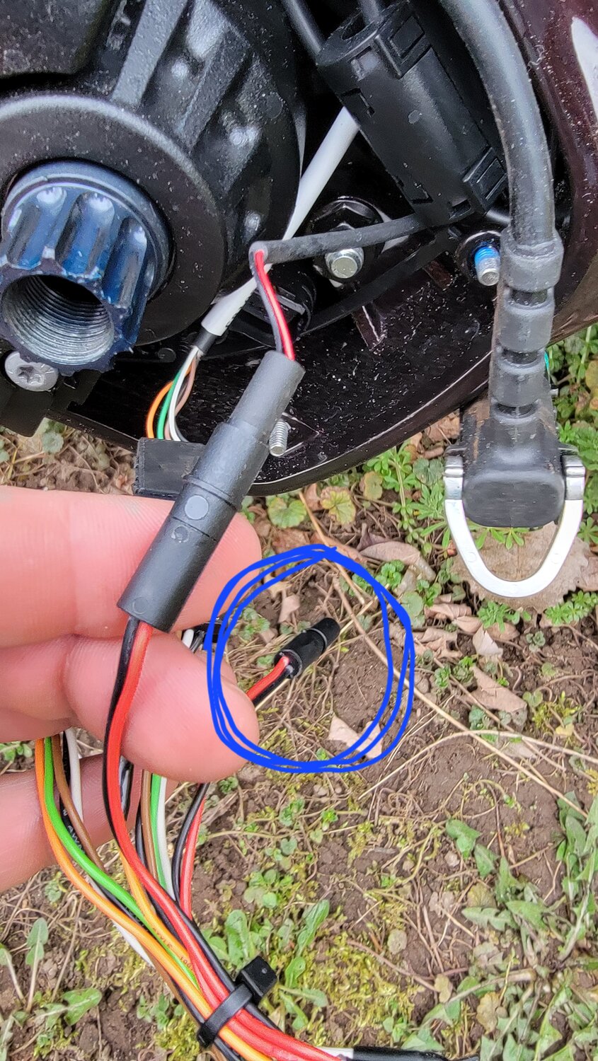

Big news! The PearTune 3.0 works! I had an epiphany while driving home from work today.
All of the connectors are made to only fit together one way... except for the very last connector! The round connector from the tuner to the bike motor can actually fit upside down. I installed this tuner 4 previous times and all 4 times I plugged it in upside down. I assumed it was correct and only fit one way like the other connectors. That was a wrong assumption. As soon as I figured out it would fit the other way I knew it would work.
They really need good instructions for this... or completely dummy proof the connectors so they all fit one way only.
So if you install this tuner and get a speed sensor error message, plug in the round connector with the black wire on top, NOT the red wire.
Hooray is right! I literally lost sleep over this last night. I knew it had something to do with the speed sensor. I was thinking maybe PearTune had wires backwards.
Then in one last desperate attempt, I flipped that connector around and it fit.
The problem is always in the last place you check.
Glad to see you got it working. They really need to add a high quality closeup like yours but showing the correct orientation. I remember when I watched the install video for the first time it looked like they were doing a number of twists and turning of the assembly - but it wasn't clear why. And can barely tell that the black wire is on the top. If you did it 4 times the wrong way - the normal as received orientation must favor the backwards install. Good catch to figure it out. Let us know how you like it.

Yes you're right about the normal received orientation favoring the backwards install. It was naturally twisted into that orientation and it fit, so I thought it was correct.
I noticed all the twisting in the video as well.
Also I have the "always on" version and I was thinking maybe there was something different I needed to do to activate it that wasn't shown in the video.
Now in hindsight it seems like something simple I should have figured out right away. It was either an ah hah moment or an oh duh moment... either way it worked out.
This really is a 10 minute job now that I know how to do it correctly. Getting into the Brose motor is way easier than Bosch.

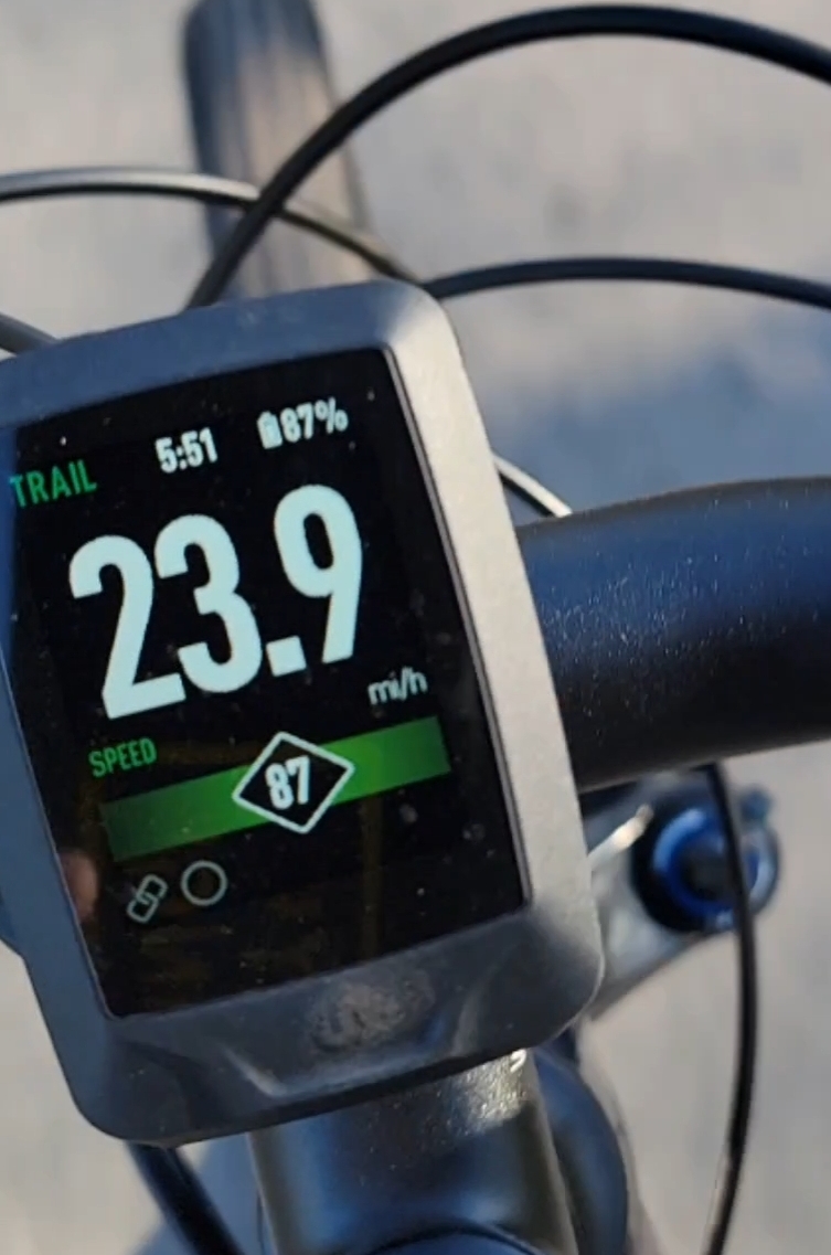

Per BikeCalc.com it would seem the Tero with its 36T/11-42 gearing and 29x2.35 tires would get you ~25.6mph at 90rpm cadence in top gear, as compared to the Vado's 32.2mph at 90rpm with its 44T/11-42 and 650B x 2.3 tires. (edit: cassette is apparently 11-42, not 11-50. this isn't material for top speed but changed for accuracy)

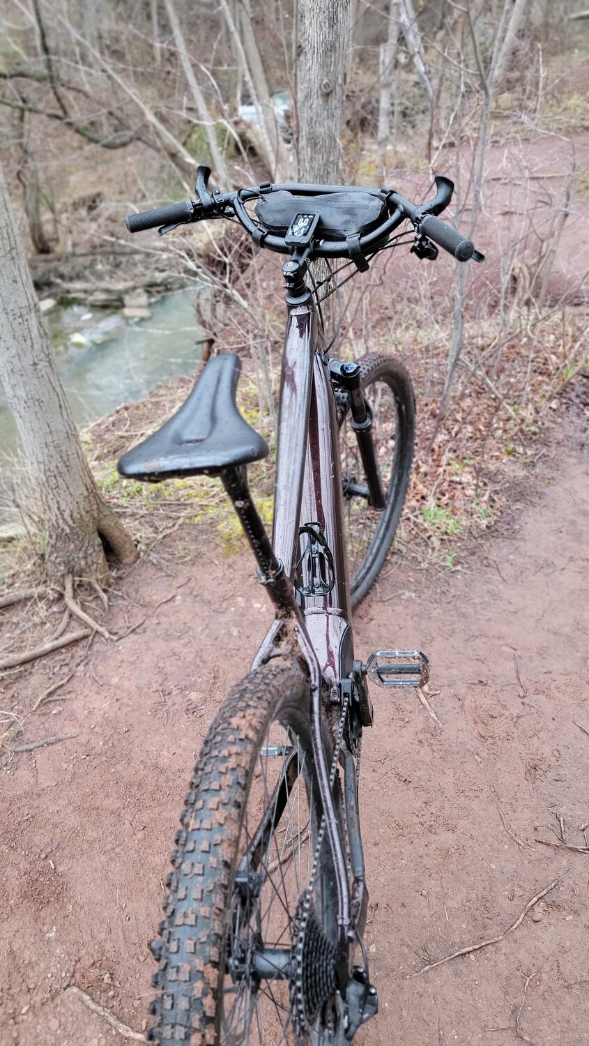

I put on my Jones loop bar setup and Redshift suspension seatpost, and went for a 12 mile test ride today (windy, cold, and a little snow). Mixed terrain. I have a steep incline gravel trail that helps me compare bikes. This Tero 5.0 is definitely more powerful than the Giant I mentioned previously. This is a great bike!
You were spot on with the 25mph calculation. It was hard to get over (or maintain) that speed because of the small chain ring. I'm going to look into getting a larger change ring. On trails I didn't really need the lowest 2 gears. I would rather have more top-end like the Vado.
Looks great, @giantkn10

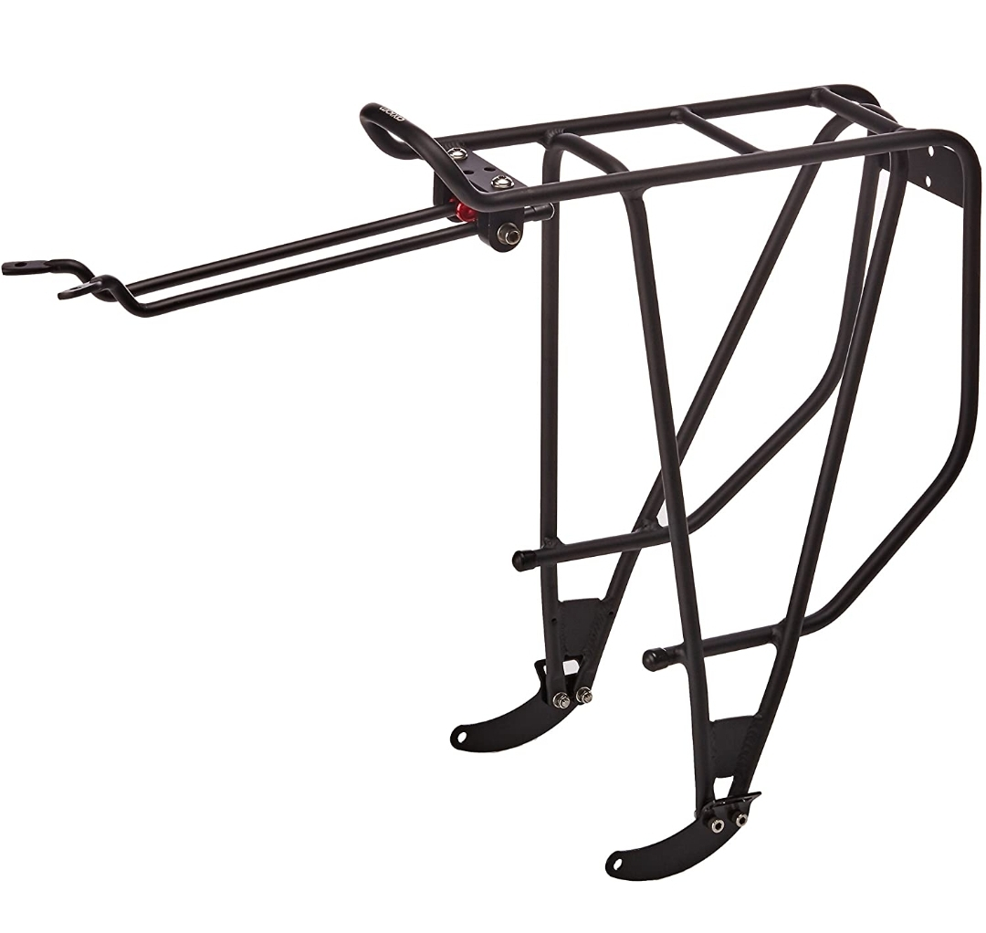

Random suggestion, if you consider a rear rack the Topeak Explorer Disc MTX effectively acts like an ass-saver due to the MTX plate catching stuff. Have it on my hybrid. Also happen to like the MTX trunk bags, I have the one with the fold out panniers.
I actually have the Axiom Streamliner. I love this rack because it fits every bike, it's super adjustable, and sits back a little bit so your feet never hit your panier bags. I just didn't have time to install it today. I also have new Ortelieb gavel bags to try out on it (gray, not black).
