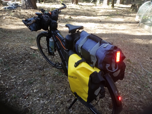

Would you happen to have a picture you can upload so i can see?
No pic of the battery in the pannier, but here's my ebike outfitted for a bikepacking trip;
I usually put the spare battery in the left pannier as it's outfitted with an extra rear light for oncoming traffic when I don't need the volume of the other bags.
Appreciate it def helpful will be creative in worling with what you showed me thanks a lot

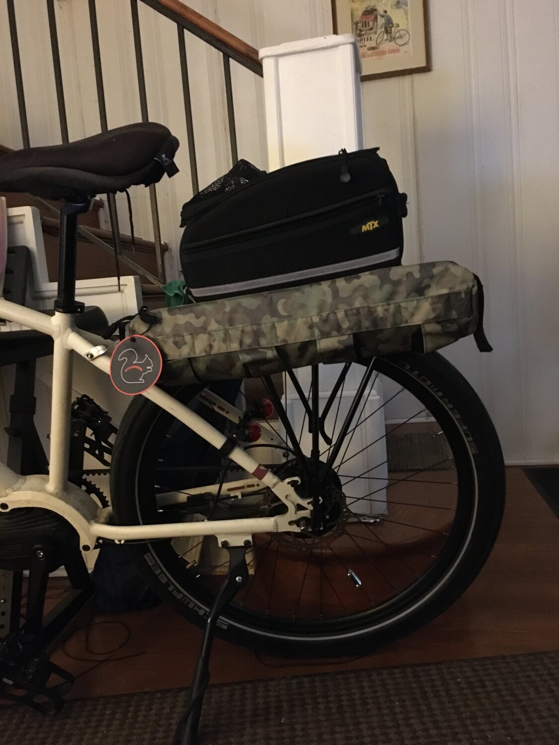

V Volt Sirius, Topeak, Stashers bag long battery solution. Stashers bag has big wide velcro straps that secure bag to rack and don't interfere with the quicktrack Topeak system. Rock solid.
