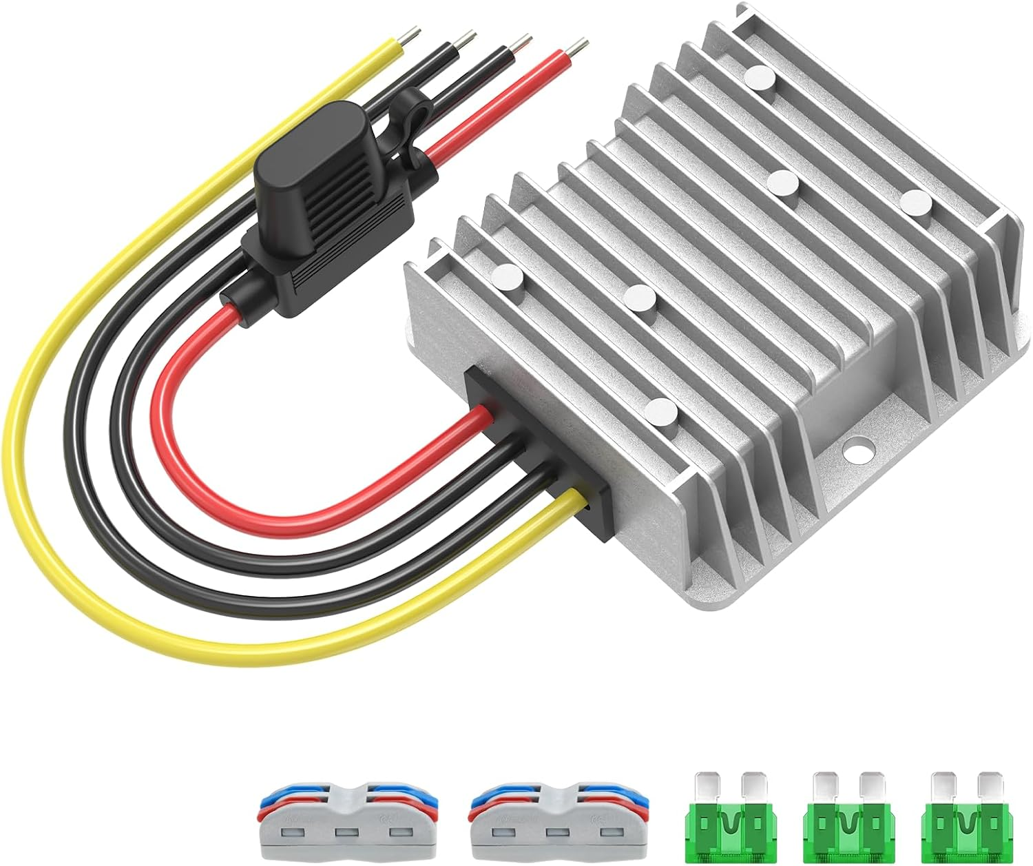

Unfortunately I've left lithium batteries fully charged for months unused. Lately I've discharged them like you mention using a buck step down converter (17-65V to 12V) to power a 12v appliance - in my case a small cooler that I use on road trips that I power with ebike battery when car isn't running. This wouldn't work with proprietary ebike batteries that require a signal from the controller to release full amperage (like my Yamaha mid drive).

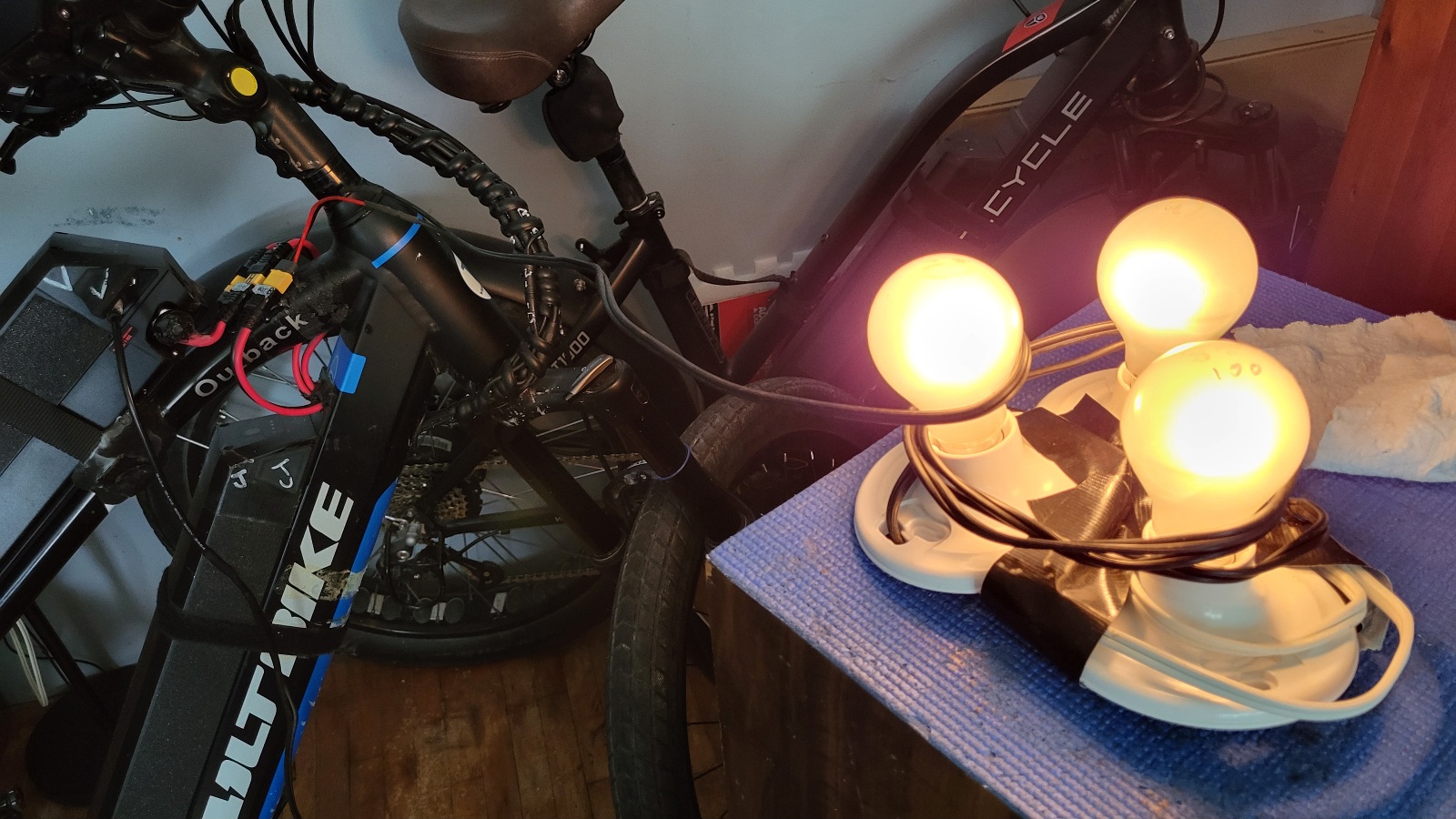

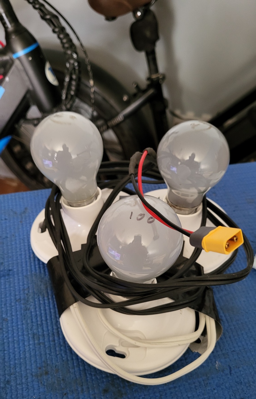

I made a battery discharger using three 100 watt incandescent lightbulbs after hearing about it from @6zfshdb ,..

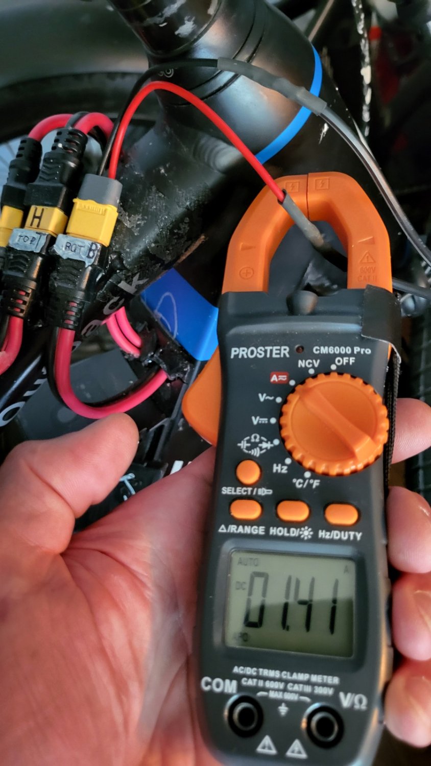

The three bulbs are drawing 1.41 amps and the battery is at 52.6 volts, so just under 75 watts, with each bulb dumping just under 25 watts of heat.

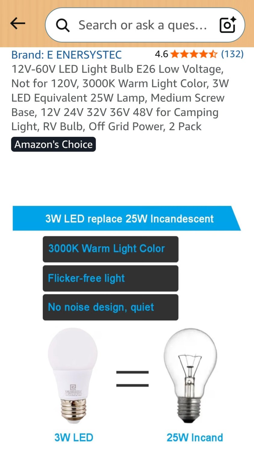

The guy in the video was using 48 volt LED💡's similar to these on Amazon,..
$20 for two 3 watt bulbs.
That would cost $250 for 75 watts worth.

The bulbs don't get as hot as they would running off house current, but they still get pretty warm.
