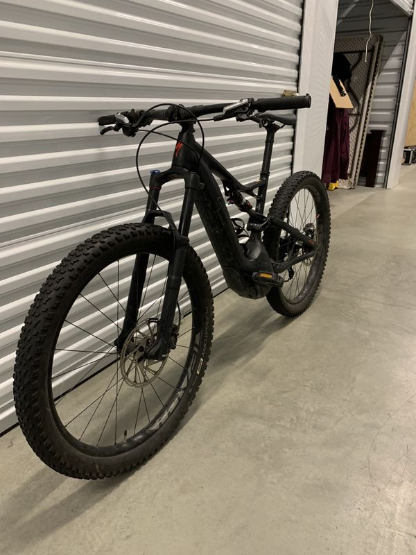

If you really want a FS mountain bike, here's one on Offerup that's a decent deal.
2017 Specialized Turbo Levo for $2500. You can get it for $2200 since I already tried haggling it down to $2000 and he said $2200 is the lowest. I believe this bike retailed for around $6000 new.
