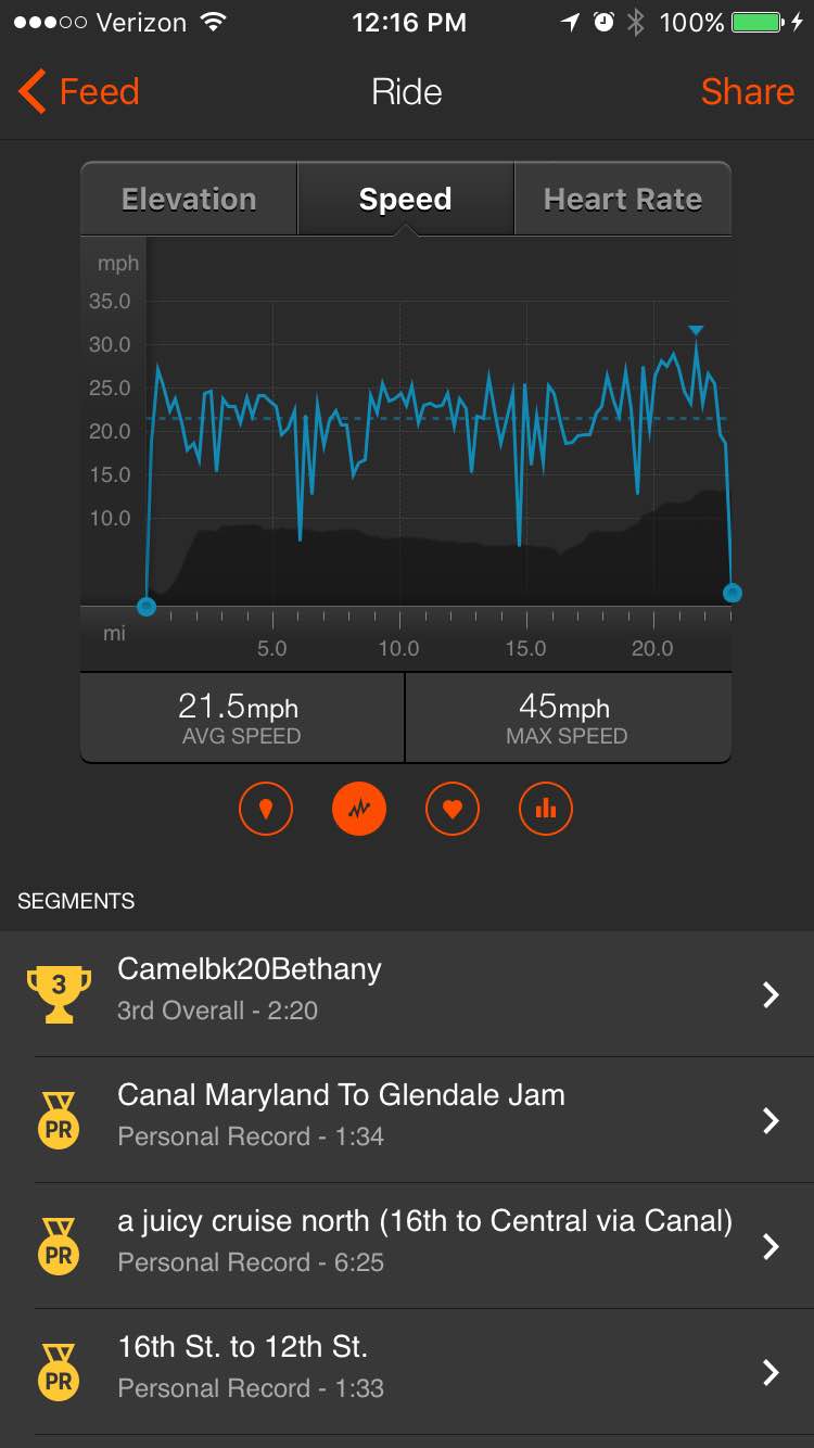

I rode it 23 miles home from work yesterday, at an average of 21.5 mph. I cleared 30 mph at least once, but mostly took it pretty easy to make sure the battery would last the whole way. The display still registered 2 miles of range left when I got home, despite a nasty headwind and 500' overall elevation gain. I left it on Sport mode until the last few miles, and then put it into Turbo once I knew I was really close to home.
You must be in great shape!
25miles range at 22 mph avg is a decent range.
