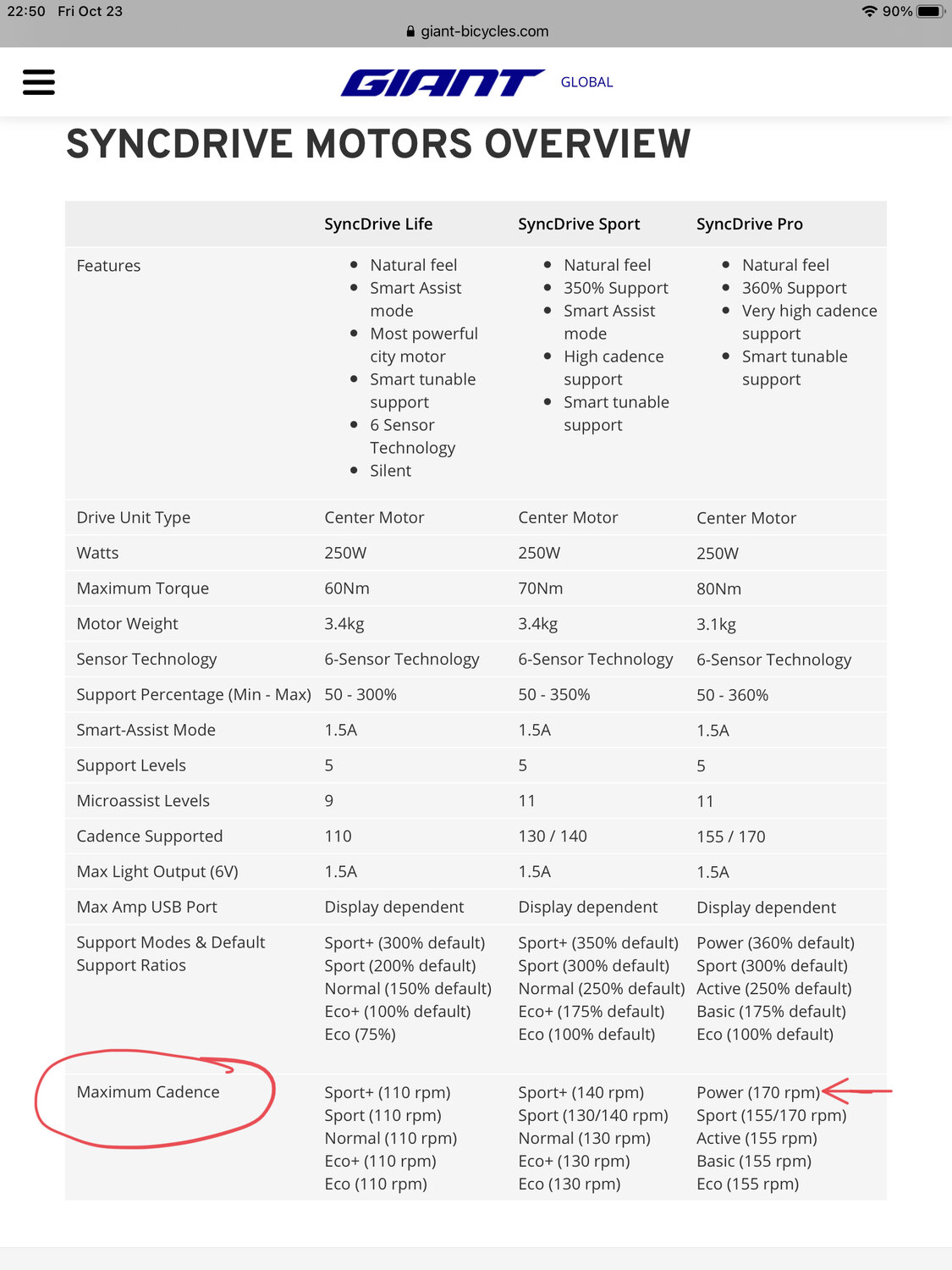

The Yamaha PW-X motor is limited to 120 rpm... If you want to go above 120 you will need the PW-X2 for pro-level support. ;)
You could also go with the PW-X2 45 for higher speed limits... it was designed for use on speed pedelecs up to 45kph / 28 mph.
As I do love your posts @FlatSix911, try not to show the "Automatic Support Mode" of the PW-X2, which is just utter rubbish, at least with Giant tuning :) (Been there, done that).
