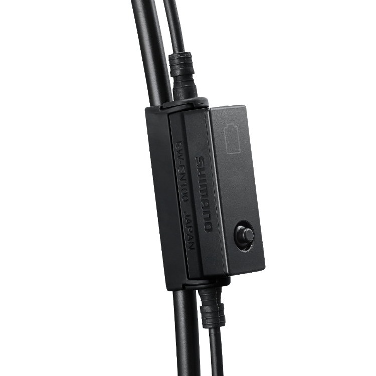

Is your bike equipped with the Di2 shifters and GRX?
My 2022 Giant Revolt E+ has the Di2 shifters and GRX.
The Giant SyncDrive software doesn't do much on this model, most of the hardware on this bike is made by Shimano, except for the battery, what you
have to do is bypass this by accessing the E-Tube project software from Shimano, for this you will need some kind of bluetooth device to connect.
I went with the EW-EN100 which I connected to one of the empty Di2 ports on the shifters, by doing this you'll be able to update firmwares for all components
including the EP8 motor. You do not have to leave the EW-EN100 permanently installed on the bike, I connect to the Di2 wire I installed under my bar tape occasionally
to see if firmware updates are available.
Hope this helps
