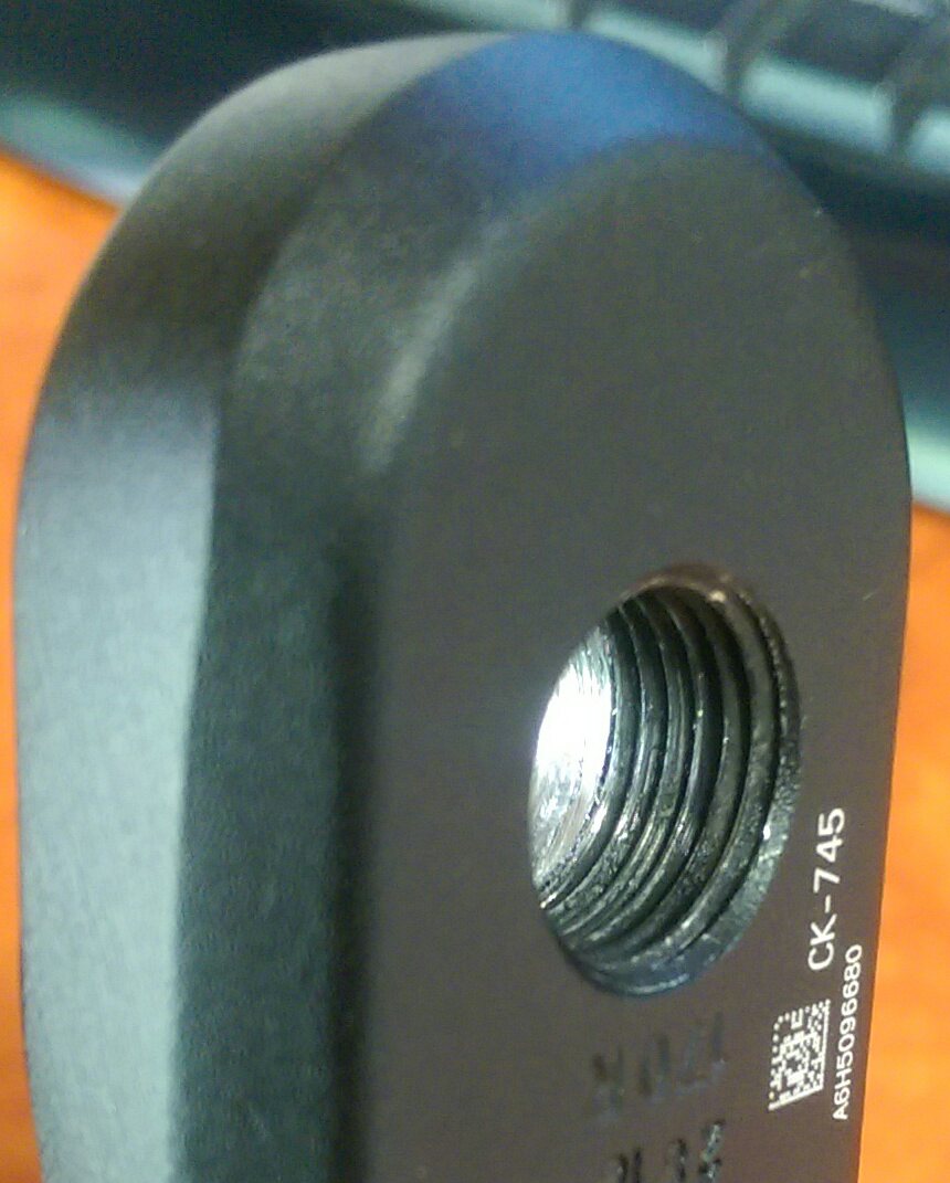

After a thorough check-over to eliminate the standard shop assembly issues (under-torqued bolts, no grease or washers on the pedals, chain with only storage lubricant on it, etc), I took it out for a first ride. Minutes after starting the first downhill trail, on an innocuous 60 cm drop over some rocks to a smooth, downhill-sloped landing (shown in the photo), my brand-new Spank Spike pedal ripped completely out of the drive-side crankarm.
I was very lucky that the pedal provided just enough support as it came out that I didn't lose control. As I skidded to a stop, my immediate thought was that the square taper interface must have failed, but only the pedal was on the ground. The failure had nothing to do with the pedal, it was the crankarm internal threads that had failed catastrophically.
The cause of the failure was simple: Giant made a choice years ago to partner with Yamaha for their motor technology. Yamaha only makes a square taper interface for their power unit (until the 2018 model year). Giant chose not to specify and procure a proper crankset for the intended service of the bike (i.e. enduro mountain biking). Instead they specified an FSA CK-745 crankset. I have no idea what testing Giant did at the time, but that crank is designed for a different market (commuter ebikes that are used to buy groceries and ride around in the city). And it is made very cheaply - full retail is $38 on FSA's website. The design of the crank is probably fine, but I believe that the material is not. I didn't have the resources to have it tested, of course, but I strongly believe that the aluminum used would not come close to the strength required by the 6061-T6 specification, which is the standard aluminum for an MTB crank of this type and application. The FSA webpage on the square taper CK-745 just says the material is 'alloy', which is meaningless and likely indicative of the very low quality aluminum used.
Beyond the quality of the part is Giant's misleading specification sheet. You'll remember that the crankset was supposed to be a Praxis Works according to Giant's website (quoting Giant Canada’s website when I bought the bike: “Crankset: Praxis Works Custom Forged, 38”, where 38 is the number of teeth on the chainring).
In reality Praxis Works had nothing to do with the crank at all. They had provided only the chainring. So Giant was using Praxis Works' name to mislead consumers, by suppressing the FSA part number to hide the low quality of the crank. When I confronted Giant Canada on this, they said it was a simply a mistake.

• First, keep in mind that all the photos were taken after the trail-side incident was over. At the time the pedal came off I was stranded on the trail, and the crank was clearly destroyed. As darkness was falling, I tried to screw the pedal back into the deformed threads so I could limp home. However, the first few threads just ripped out completely. So the photos show the outer section of the pedal thread in the crankarm torn out, but this did not happen at the same time as the crankarm failure.

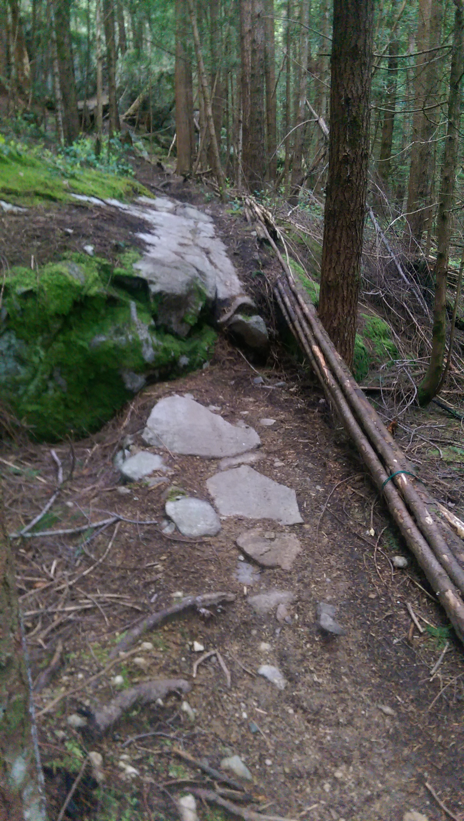

• The Full E+0 has 140 mm travel with a Rockshox Super Deluxe shock, which was pressurized to 190 psi. It did not bottom out on the small drop, and neither did the Lyrik fork. I did land the drop with my weight biased to the right side (probably 80%) when the crankarm failed, but there is nothing unusual in that. The drop is tiny by enduro mountain bike standards.

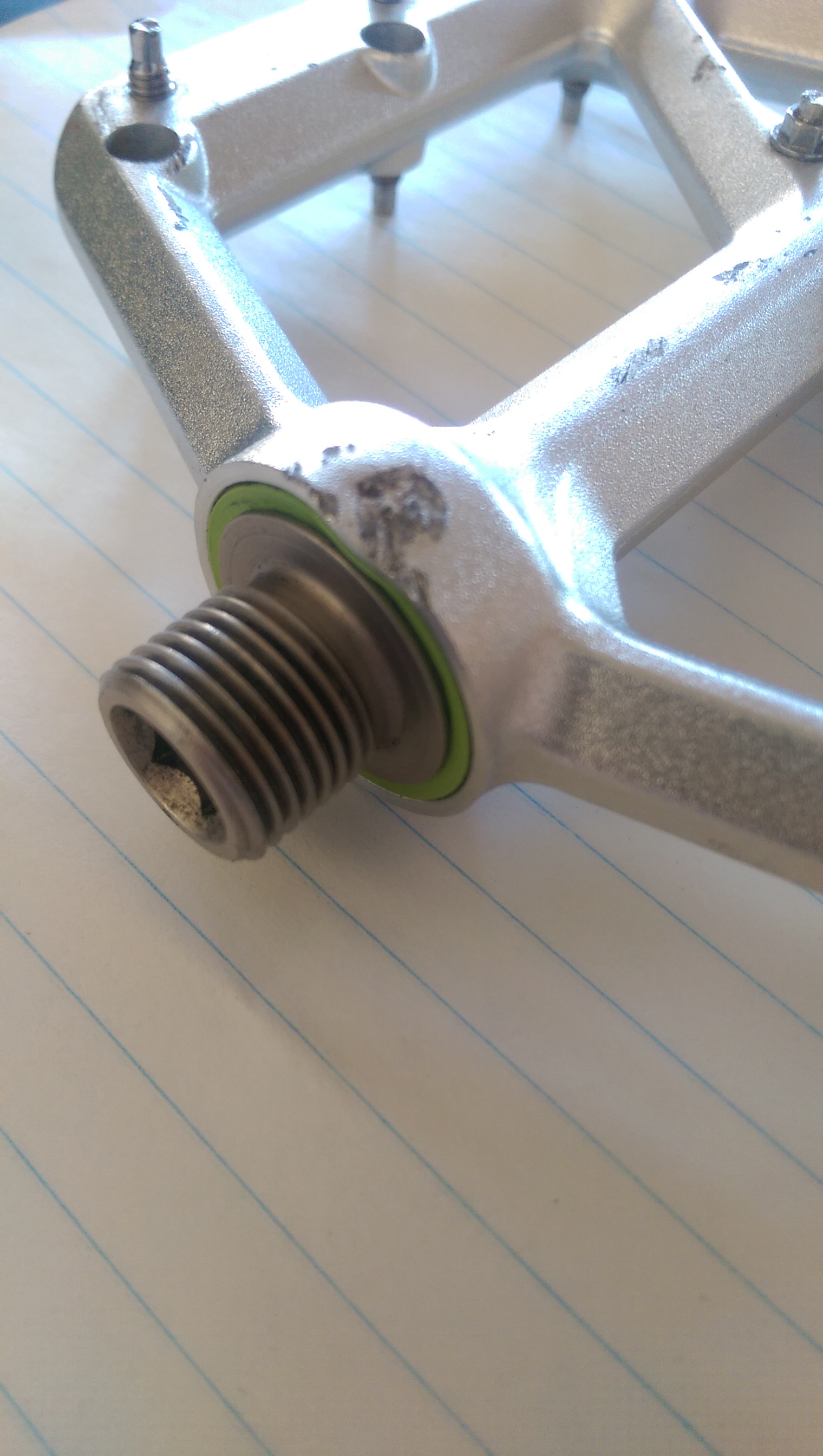

• Many of you are probably thinking that the most likely cause of such a failure is a pedal that has become partially unscrewed. However, I installed them myself to 35 ft*lb (with grease), and pedals are threaded so that precession acts to tighten them, so the probability that they were partially unscrewed is already extremely small. But evidence inside the crank arm proves the failure occurred when the pedal was fully threaded into the crank. With the Spank pedal and pedal washer in place there are two unengaged threads inside the crankarm.

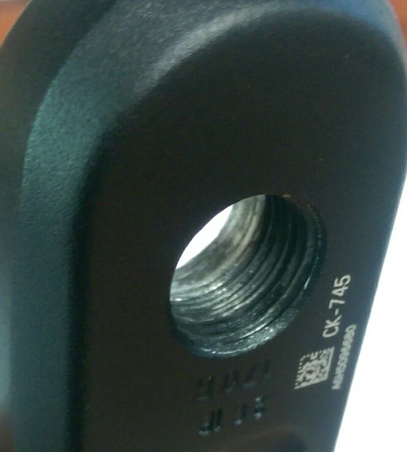

The photos attached show that the damage starts at the third thread (subtle damage, paint is missing), which is the first internal thread that engages with the pedal. And there is progressively more damage on each successive thread, moving from the inner side of the crankarm to the midpoint. The fourth thread is clearly deformed. From the midpoint on the threads are stripped away completely as I described earlier.
The pattern and orientation of the damage to the crankarm threads is consistent with the back of the pedal thread levering itself up into the top of the crank threads as it came out, with the crank at the 4:30 position (looking at the drive side of the bike). This is consistent with my right foot being forward as I rode over the drop. At the time of failure, vertically upward corresponded to the direction from the pedal centerline toward the ‘4’ in the ‘CK-745’ logo printed on the crank.
4  - Damaged threads 1.jpg 5  - Damaged threads 2.jpg 6  - Damaged threads 3.jpg
In contrast, the other side of the crankarm thread (which was facing down as the pedal ripped out from the opposite side of the crank) appears to be undamaged.

• For completeness, the OD of the pedal thread on the Spank pedal exactly matches the stock Giant pedals (14.0 mm on my cheap micrometer, nominal is 14.022 mm). So there was nothing wrong with the pedal. The pedal threads do not appear to be damaged but the dent in the bearing housing has effectively destroyed the pedals. And no, Giant did not offer to replace them. Spank, however, has offered a crash replacement at reduced cost.
