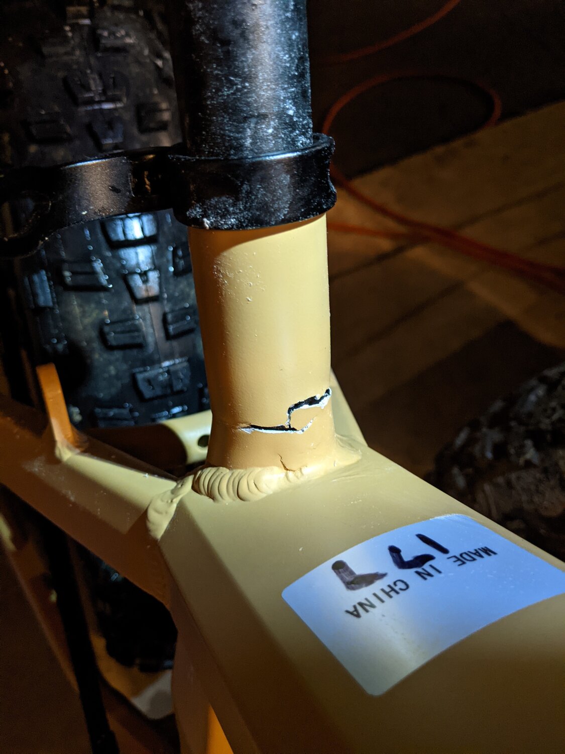

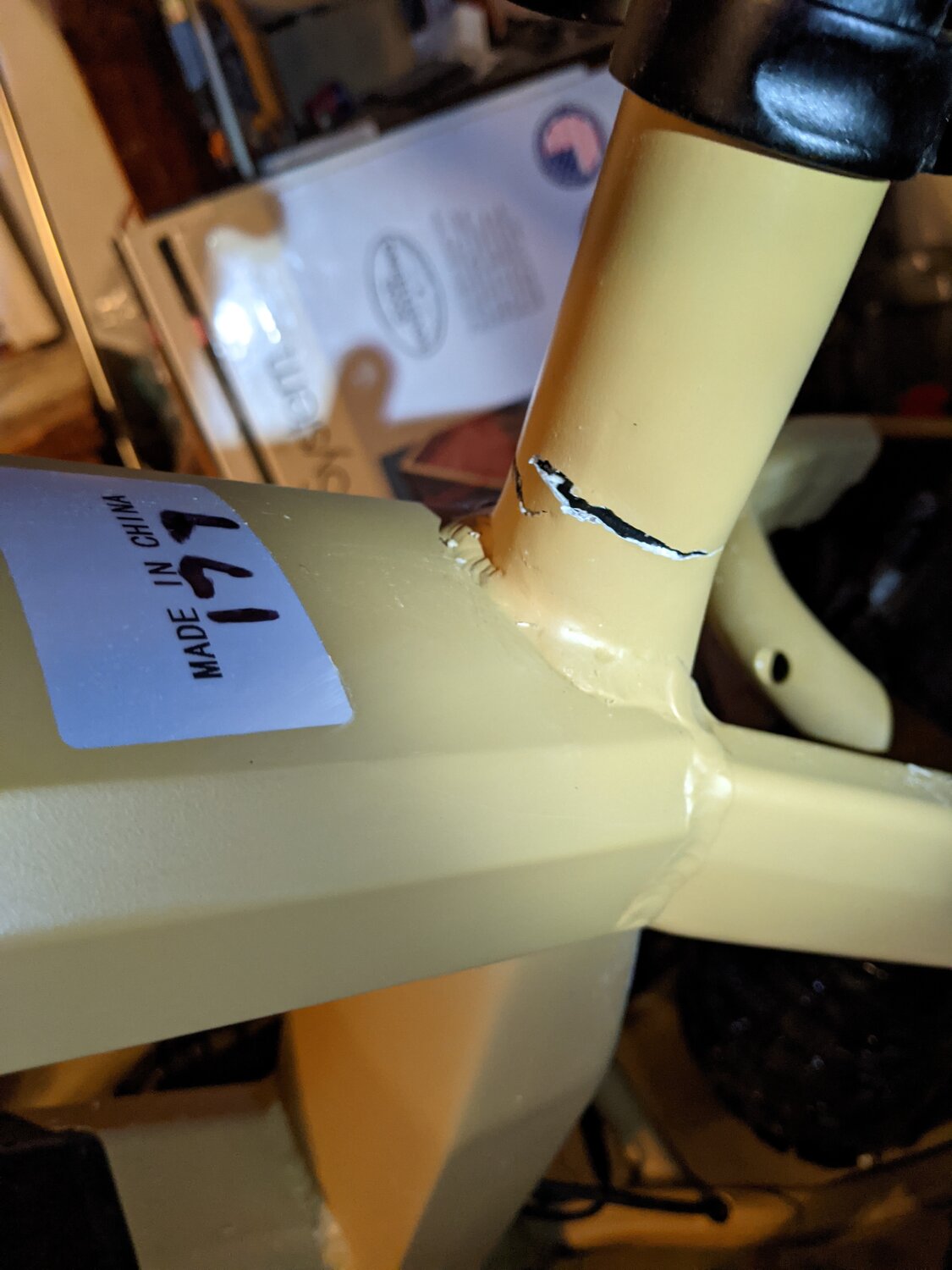

So is this a design flaw that will eventually happen to all the bikes over time and would a seat post shim as stated above help reduce the chance of it happening?
It has happened to exactly 1 bike and can't be correctly characterized as a design flaw. I have the same bike and have put over 1000 miles on it in 2 months and the seat tube looks as new.
I am hoping this was a quality issue at the factory, it was the first time I took this bike on a green level trail, the other times is just on the street. I'm trying to get an opinion from a welder. Maybe the metal got to hot, maybe their is too much play in the tube on this particular model. So far the frame builder argument is I had my seat post to high which isn't the case cause I have a short inseam then they implied I must have crashed it which wasn't the case either. Just trying to blame it on me.
Leili is trying to make it right by offering me a frame for free, but I have to pay for shipping. I am hoping I can gather more evidence so Leili can present that to the frame builders. It will be nice if the welder can work some magic and fix/improve the design. I had a couple ideas on how to that. Might just become an expensive parts bike...
Those are incredibly lame excuses. This is a catastrophic failure of a structural component of a very powerful machine that could have seriously inured the rider had it broken off while riding. Leili needs to stand by their product, not share their negotiations with subcontractors. The welds on your broken nearly new bike are beyond substandard. How did that pass anyone's QA process? It could also be as you stated a problem with either excessive heat on the seatpost tube or a manufacturing flaw with that alloy extrusion.
IMO, Leili should:
1. replace the bike free of charge and pay the return shipping on the defective one.
2. Send you a new frame and cover the cost of completely rebuilding the bike from the parts on the original bike.
You purchased 5 bikes from them and that should be additional motivation to make this right but really, it casts a long shadow on other brands using this frame. I'm talking about Bikonit and Biktrix and they should be supportive of this issue as it could very well have been one of their bikes that had this serious problem. Good luck with this and I know I will be checking my seat tube religiously ...
