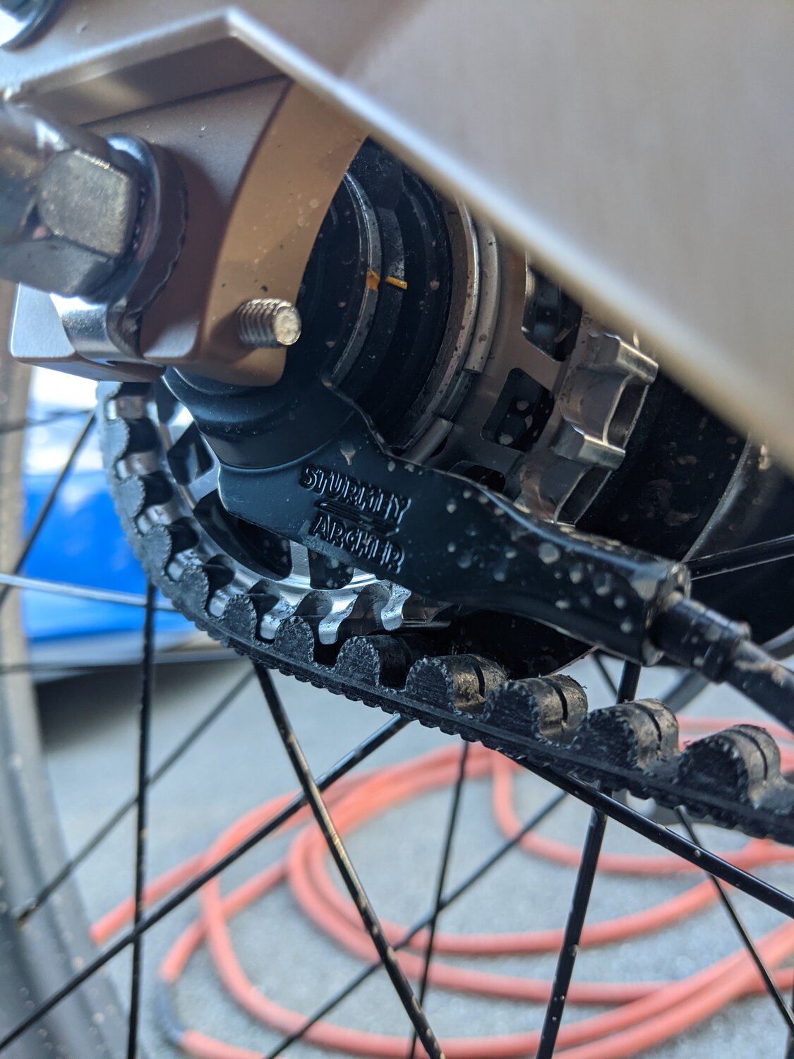

I’ve been messing with the gear selector cable on mine since my cable snapped and I renewed the whole trigger shifter and cable. On mine the yellow lines are around 3/4 of an inch apart for the gears to be perfect with no random clunks or crunches. The yellow paint on one side has fallen off and it’s just a etched out line now. This is a pic of how they line up in 2nd gear. Strange!
Yes it is strange. That yellow line misalignment must due to the original setup. Mine has a gap similar to yours. When I have tried the IGH adjustment I put the bike on my stand and it shifts all gears fine. I assume this is due to no load on the drive train. When riding 5th and 4th gears work fine, 3rd is unusable while 2nd and 1st seem OK but I almost never use them. I'm going to try and get it sorted out at my LBS.
When I first made the change I was getting random clunks in certain gears and as I adjusted the wee nut just where the cable enters the trigger shifter the clunks would change to different gears and how much it happened would also change. I was trying to stick to using the yellow marks as your supposed to. I got fed up going round in circles and getting no where fast so thought “phuk this” and tried just doing it by ear and feel and ended up with the yellow marks quite a bit out but now I get no clunks and it shifts smooth as butter. I was heading home as it was starting to rain when it sounded the best it has since the change so I only got around 20 mins to test in all gears. I’ll get out tomorrow weather permitting and give it a proper run through all gears at all different stages of making the motor work. It seems it can all sound fine then when you “ring it’s bell” it starts making noises or vice versa. I’ll post what results I get after a proper test. Fingers crossed.

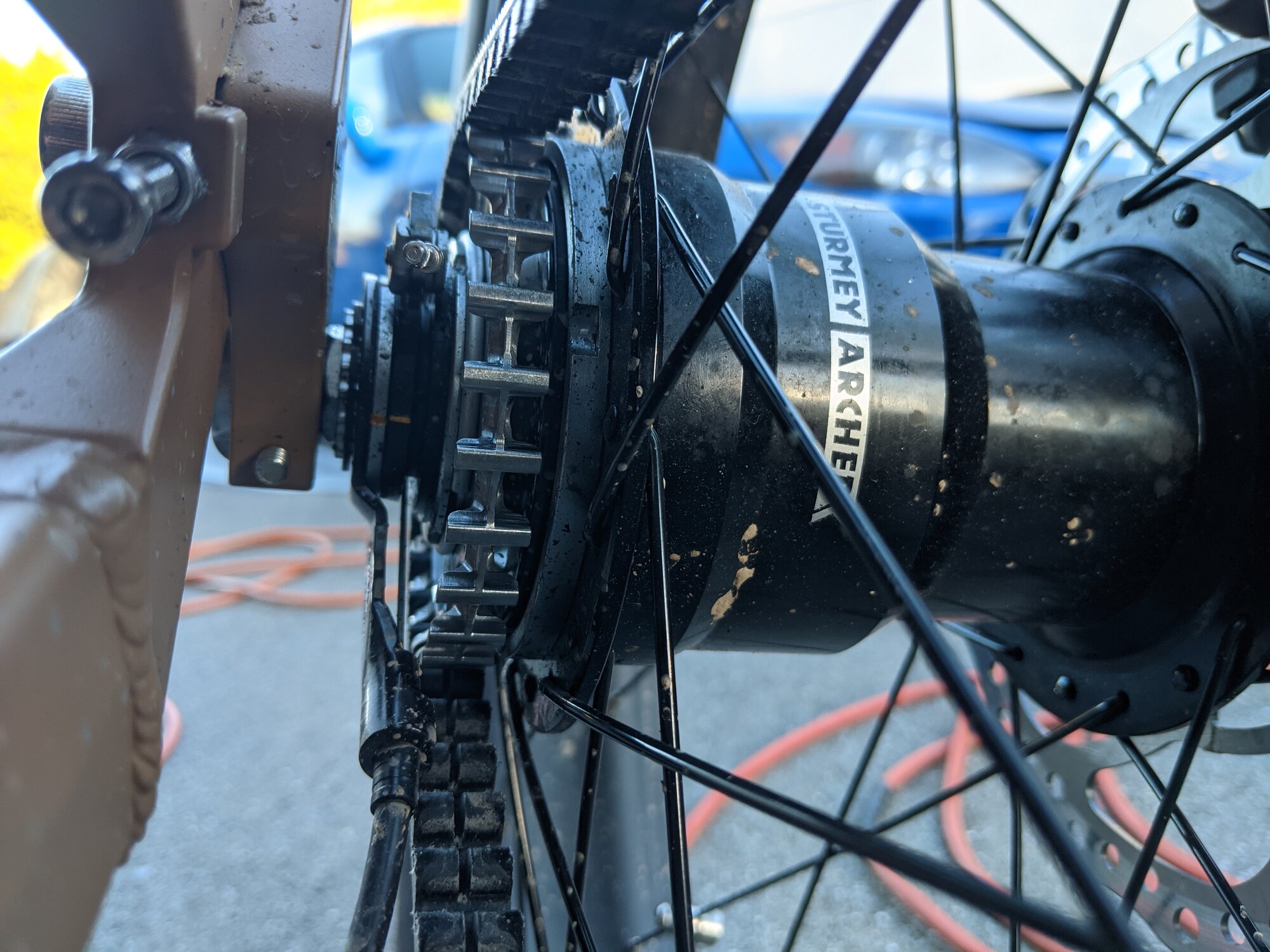

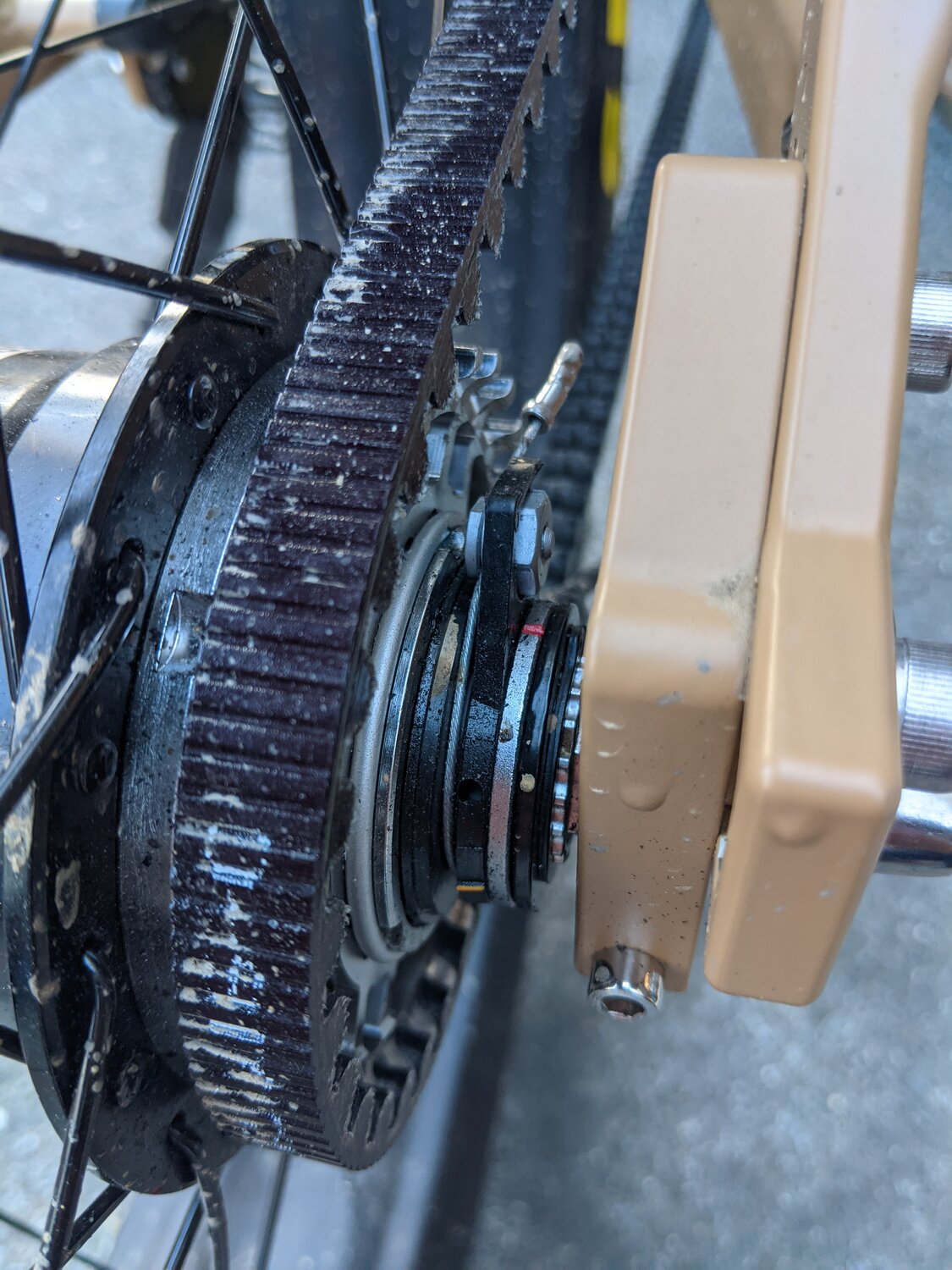

My two yellow lines are on the other side of the igh.
How do you mean “the other side”? The non drive side or more towards the front of the bike? There must be different IGH’s and different ways to set them up.
“I see, I see” says the blind man to his deaf brother... 🤪
I hadn’t noticed the lines under there!! Now I look the adjustments I made on my own were quite near those lines underneath by pure luck. I’ve adjusted mine a little to match up properly with those but it’s late here now. I’ll get out tomorrow and test and let you know how I go. How did you see those under there? I was right in about there when changing the cable and never saw them! Lol
Well spotted bro! 👍
Well spotted bro! 👍
I knew there had to be two yellow lines somewhere, took me awhile to find it lol I knew I could get the yellow and red line to line up, plus that is for a vertical dropout. We have a standard dropout
