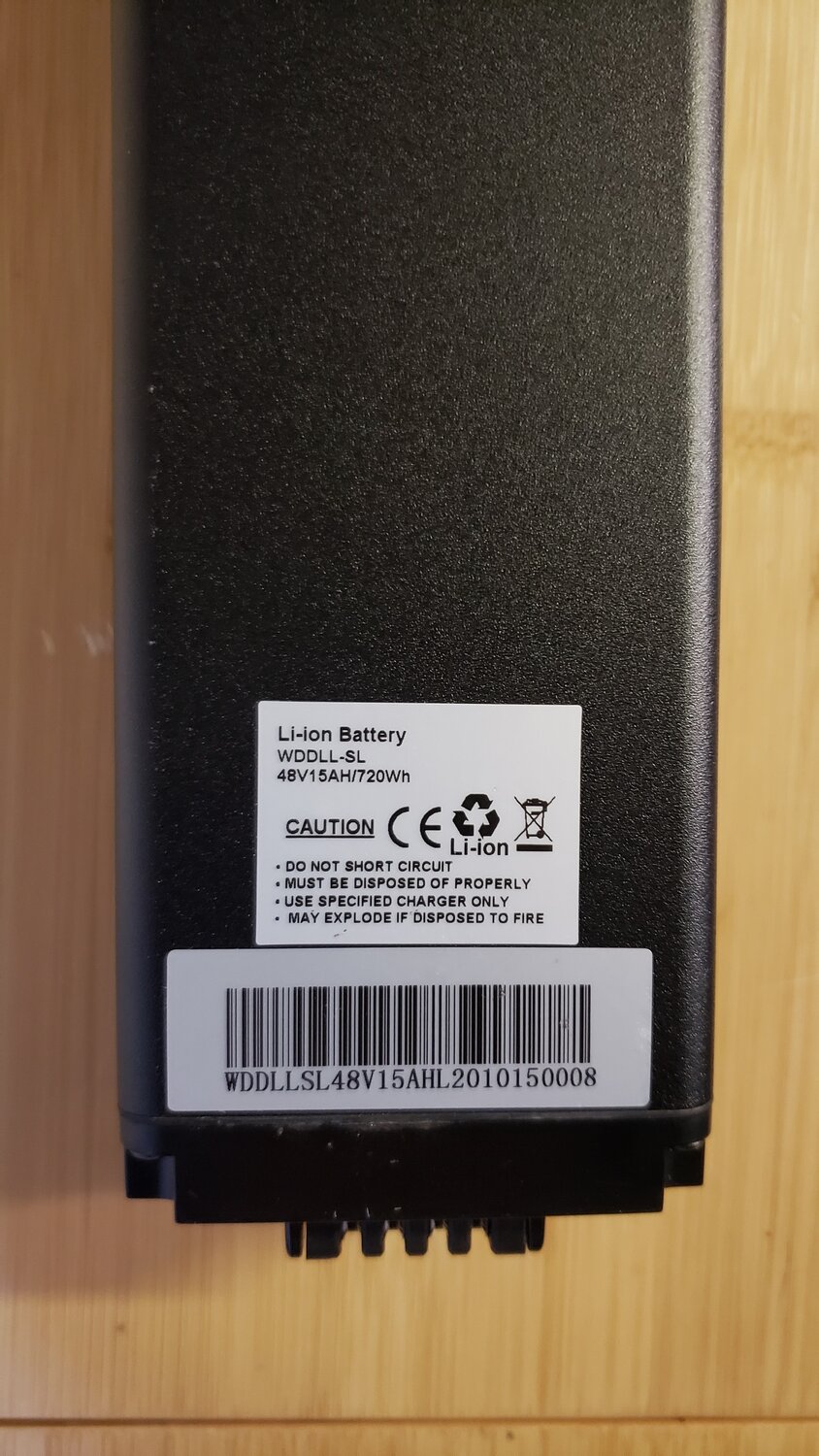

EDIT 15) Didn't photo my batteries, but the label looks just the same as what RMK posted.
