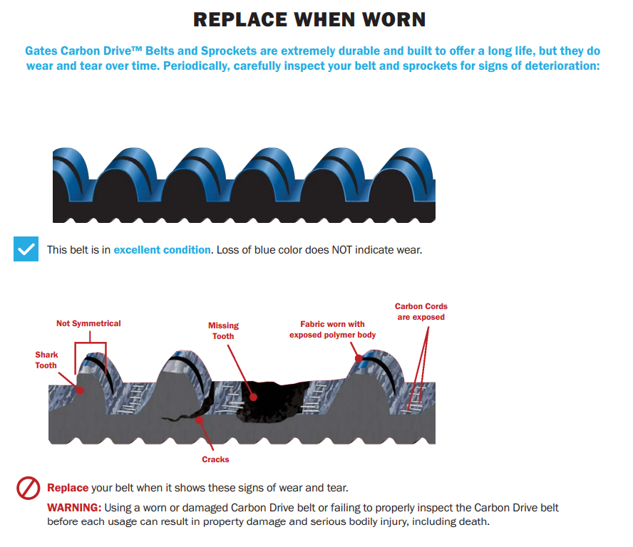

Today my R&M Homage's Gates Carbon Drive failed without warning – none that I was aware of, anyway.
As far as I could tell, one moment the belt was perfect, the next utterly useless. Many of the 'teeth' were missing and the blue nylon 'facing cloth' was shredded. The belt had come off both front and rear sprockets and, given the length of the sections without teeth, there seemed no point in attempting to get it back on.
The 'evidence'…
  1. Before failure: just under 15,000 km travelled.
  2. At time of failure: gentle acceleration from traffic light; Tour setting (PAS 2); 'senior gent' not contributing too much effort.
The bike had been serviced at 14,000 km just fifteen days ago. Did we miss warning signs? Should the belt have been replaced at a set interval (10,000 km?) irrespective of obvious wear?

I was also told that you should replace the Gates chainring and pinion ring. Please check with your dealer and also Gates. It is not ideal to use a new belt on a worn chainring.
With the extra torque of the motor, things wear out faster, whether it is a chain or a belt.
These approx numbers are for a 175lbs rider + 19-20 mph avg speed (30-32/kmph).
E-bike chain + Derailleur = 2500 to 3000 miles
E-bike chain + Rohloff = 5000 miles
Gates belt + Rohloff = 8000 miles
It's odd that if R&M has service intervals that they don't address the belt drive as recommended? I would wager to say there aren't many 175lb. R&M riders so that would make increase the wear.

David,
I had a catastrophic failure of my belt at 17,000 kms, but pretty sure it was due to the my use of the wrong silicone belt conditioner the day before half the teeth sheared of. Normally use a CRC brand but grabbed a WD40 instead, not noticing that it has petroleum distillates.
Will find out when I get a replacement Tuesday.

@Ken S
You might want to conduct your own experiments with DOT 5 before trying it on your belt. It is pure silicone oil and used in race car brake lines. It restores and lubricates rubber. Try some on a old tube and on an old tire. It is pretty amazing stuff.
