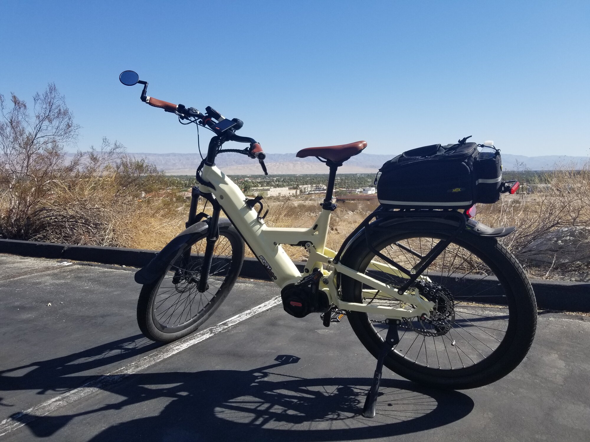

186 miles on CC as of 11am today. Took her out for about an hour. 10 miles or so is my guess. Flat, bikepaths and sidewalks. Tried to avoid the street as much as possible. 75 degrees F and sunny. Our weather has returned. Went from 100% battery to 89%. Not too much throttle. Mainly in PAS 2 or 3 and seemed to be going 17-20 flatground. Picture is overlooking Palm Springs. PS Airport tower in the background.
