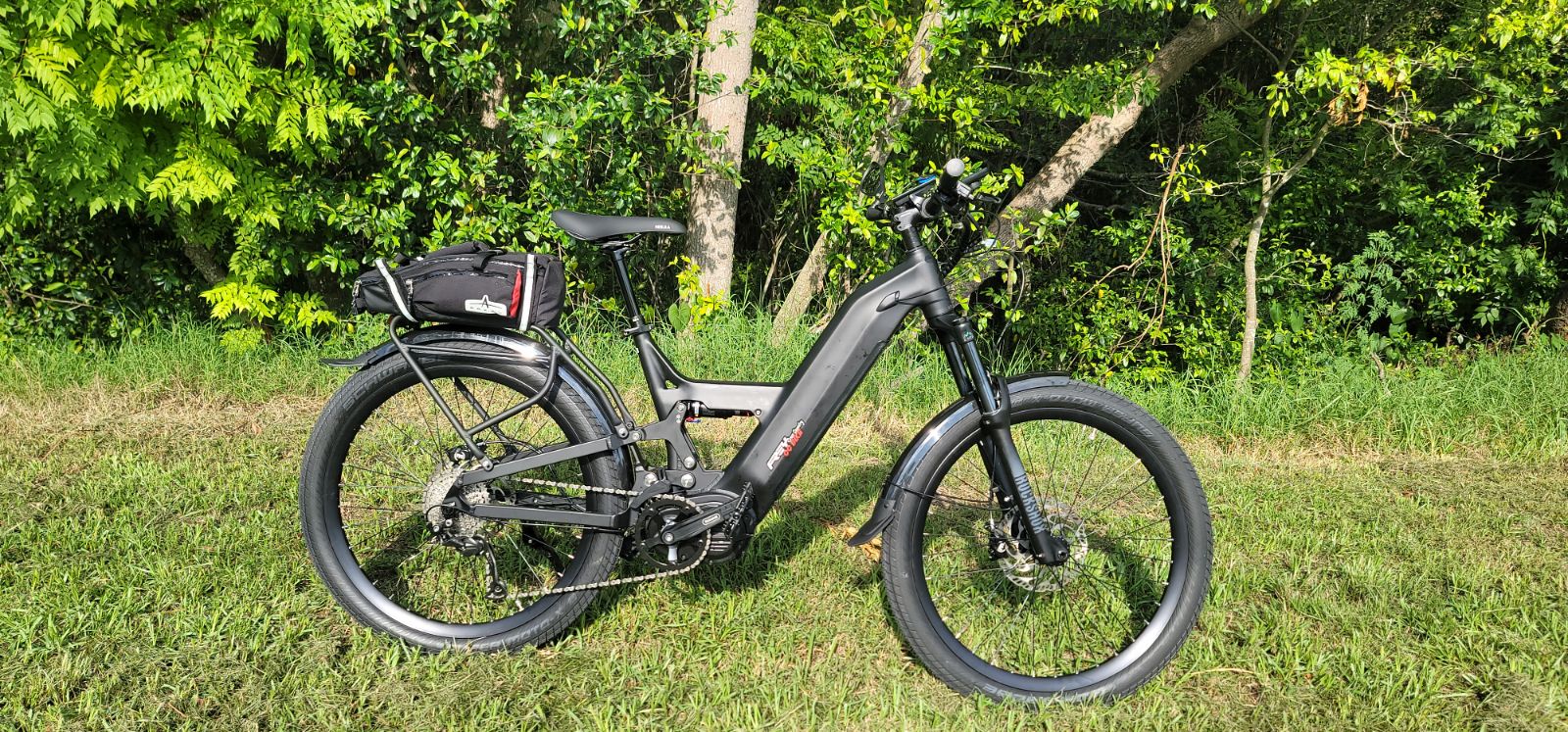

Got mine today. Only reason I knew it was coming in was a chance look on ups site yesterday. the tracking from the company sucks when it hits the port.
I will need to change out the chainring. Flat Florida does not like the gearing. Spent too much time in top gear.
Will start in on the programming and setting up for comfort this weekend.

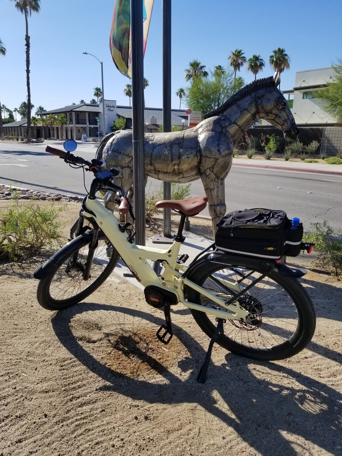

I switched out the 40t for the 46t Wolf also added swept bars, grips and a riser
Did you have to use a different chain? Also was it the wolftooth 130bcd/cx/road drop-stop b chainring?

With a larger front chain ring you’ll need a longer chain to maintain derailleur performance.
