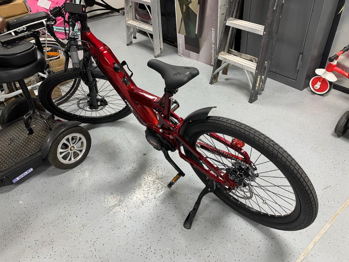

Ordered some stuff from Frey 6 days ago to use up the credit I had with them, including a drop down seat post. All arrived today. The cable for the post is very long, I take it it goes down the tube to the motor mount area then back up to the bars, can you confirm?
Mine was allready installed as well...
Tom probably knows.
Thanks, I'll try that first, it'll be very busy in the motor mount area so may have to remove fir tidy job. Keep you posted..
Also, the dropper post is longer than that supplied which gives a bit more height to min mark which will suit me..

I didn't order a dropper. I'd ask Frey to advise since they install them. Probably going to need to remove battery lock and wiring plate above battery. Hopefully you can route without removing motor. Here's what it looks like with lock and plate removed.
I have a problem with my factory installed dropper post. The system works as it should with the post fully inserted in the frame; however, the cable that connects to the lever on the handlebars is jammed preventing the post itself from being raised for a new rider. I traced the cable and it runs through the motor housing and up the seat tube. I think it will be very difficult to fish a new one around the motor and up the seat tube if the clearances are so tight. My LBS says that the motor will have to be dropped to fix my problem but I'm going to continue to push and pull and see if I can release it. Hope that helps.
Thanks, just about finished the outboard, so the bike will be next, projects project's. Keep you posted..
It isn't that hard to drop the motor, just pull 3 bolts. You'll actually be pulling the motor out (remove it with the bike upside down, otherwise will be next to impossible to put it back fighting gravity). Hopefully you can pull out the motor just enough to route the dropper cable while keeping all of the other wires in place to make it easier to put back. Its crowded in there and can be a challenge if you don't put the wires back the way they were.

Turns out the dropper cable was pinched by the metal wire cover in the battery housing not by the motor. 10 minute fix. Good Luck
Boxing Day, ideal time to get the dropper post in. The 3 allenbolts holding the motor on are verrrry tight. 5mm Allen head, any tips?, don't want to break anything. Needs to be removed as cannot push the cable in tween motor and frame..
All good, thanks to YouTube, now just got yo get all the wires back in..
