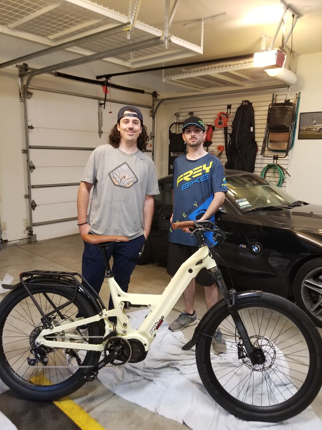

I think it is a fine bike, just a tad heavy. If somebody would give me 3500 I would give them the whole kit and kaboodle including Topeak bag and Kryptonite Ulock and Cable. ( I think I have under 300 miles on it) I over-estimated my riding desire and my kids are busy working...
I might be interested. Can you describe the bike. I'm new to the forum and can't suss out the details. Thanks.
This bike above.
