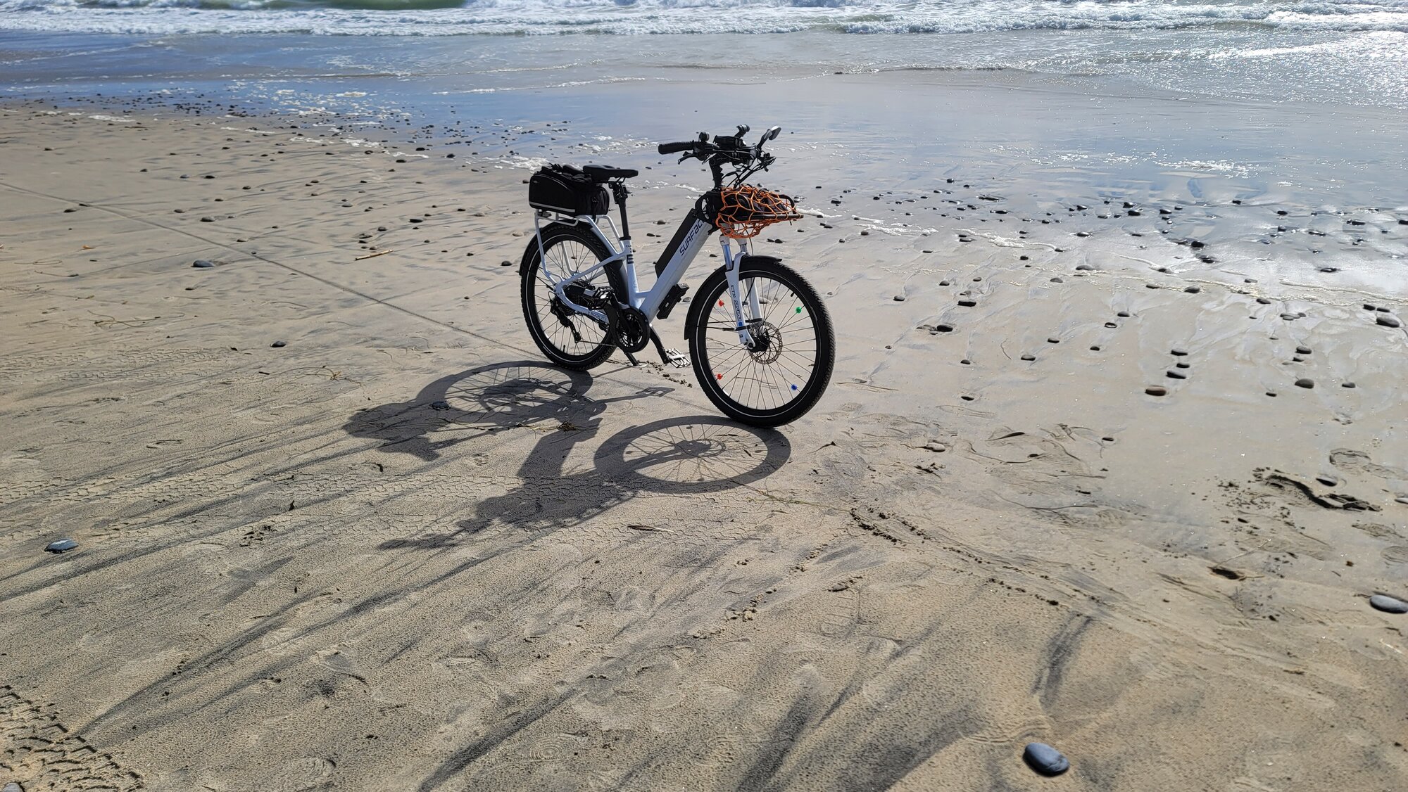

A 500W, 65 Nm torque-sensing hub-drive with progressive over-riding throttle and 2.3" hybrid tires has served me well on low-tide sand, but I stay well under 20 mph. Your beach commuting may call for higher speeds.

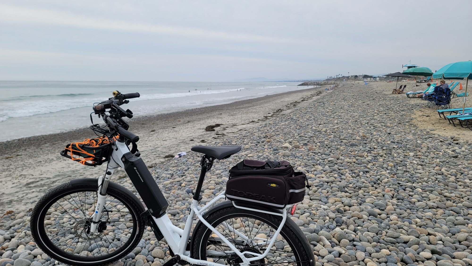

Riding on loose beach cobbles is like riding on ball bearings. Treacherous. Not sure if fat tires help with that.

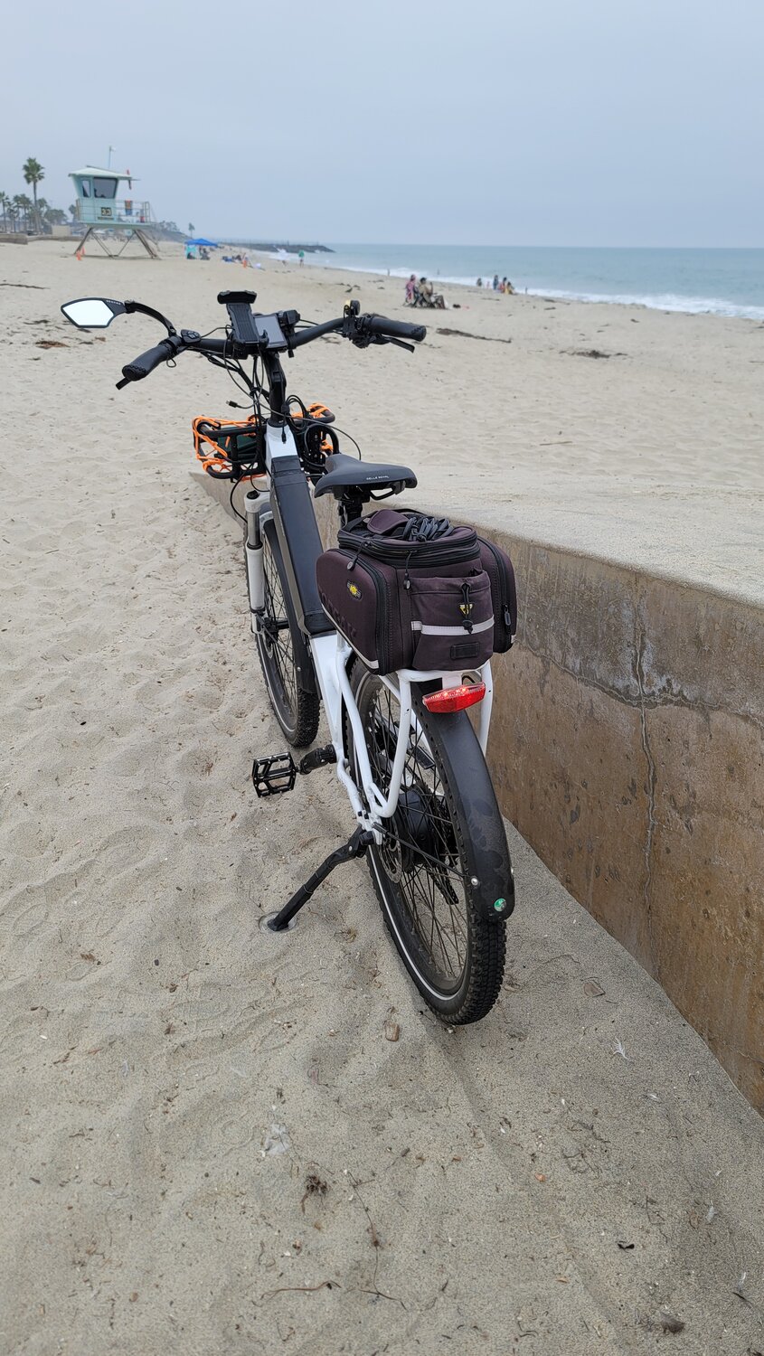

As the OP well knows, beach sand always has unexpected soft spots. Agree with @mrgold35 that a quick blip of the throttle can be a very handy tool in this setting. (I always pedal. The throttle just adds assist now and then.)

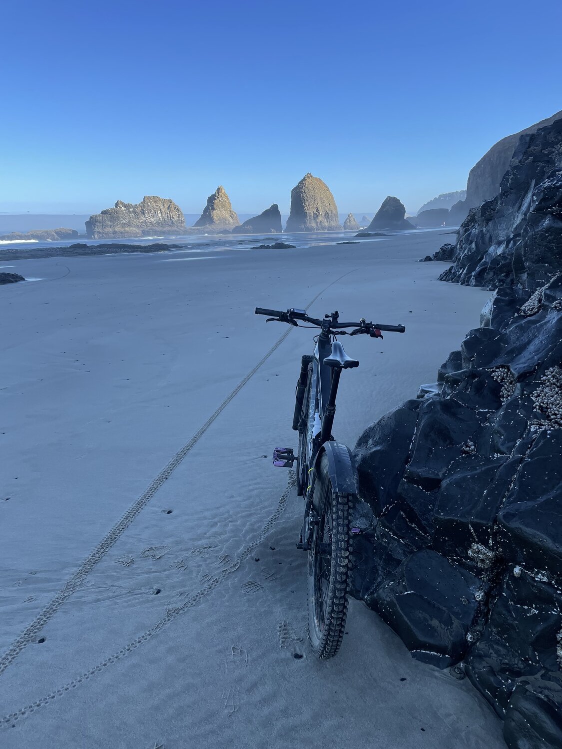

I have ridden miles of beach south of you on the north OR coast on a drop bar bike with 45c tires so the idea that you need a "fat" bike is not exactly necessary as long as you stick to below the tide line, however sometimes getting across the beach to that can be a bit of a struggle but I was able to do it most of the time with my front hub motor type setup that effectively got me 2wd. I have used both mid drive and hub motors and I have never had much issue with corrosion as long as I rinsed the bike off regularly. If I was going to make a bike specifically for beach use I would use a direct drive front hub bike on a frame with 2.5 tires and an IGH and belt drive. You will want fenders for sure if you ride in the rain and as full coverage as possible front and rear. Being able to keep the bike inside when not in use and out of the sea air is also a good plan. Also consider tidal effect as high tide can push you up into the tide line where it will be softer, still ridable but will use more power to get through.
