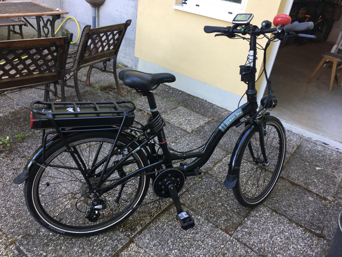

My wife's preferred bike is a Dahon Briza 24" folding bike. The lower protrusion of the seat tube would probably need to be cut off and the hinge might get in the way towards the front and the kickstand would probably need to be removed.

I may say that I am in the same boat (my wife also has knee problem, and we also decided to use Dahon Briza + TSDZ2 350W motor). Now about the motor - Last year I put 750W TSDZ2 on my city bike and I don't feel it is anemic. With 8-speed casette I can climb the steepest hils with ease, and I am not exactly lightweight myself (about 105 kg). On flat terrain, when derestricted, it will go a bit over 40 km/h, but it will require some effort on the rider as well. Optimal cruise speed is about 30-35 km/h, with minimal effort from the rider.
People often feel it anemic (compared with BBS) because it is torque sensing, and it always requires some pedal pressure to make it work. On the plus side, the battery range is better, for the same reason.
So I don't think that 350W motor will be too weak either.
For the Dahon Briza - I have differerent recomendation - just say "NO" :) (at least when TSDZ2 is concerned).
Dahon itself is nice, lightweight, it rides better than 20" folders, but the bottom bracket design is really not suitable for this conversion. It is still the same standard 68 mm bottom bracket, but to fit the motor, I had to cut the bottom tube, remove the kickstand, also cut and remove pieces from both sides of the plate where kickstand was attached. Ewen with all this, it is not possible to fit the motor in one piece (I had to remove the lid on the left side first - and throw away the warranty for the motor :-( ). So i lost both warranties - for the motor and for the bike. Also the chain line is problematic, due to awkward geometry of the rear fork, the first gear cannot be used. And I had to design special torque arm, because standard arm does not fit.
And after all this trouble, my battery (ordered from Aliexpress) is stuck somewhere in the middle of the Corona crysis, so I was not able to test it yet :-(

Hi again!
The update - yesterday i finally got my battery (ordered battery and rack from Aliexpress back in January).
I had to use the rack mounted baterry - there is no other place to put it on this bike.
Was it worth it? I would say - yes.
And yes - it was expensive (Dahon is not the cheapest bike around), it was lot of work, and no guarantee of success.
But here it is - lightweight foldable bike with central motor and torque sensing.
I tested it and the bike feels very solid (Allthough is rated for 100 kg max, It handled my 105 kg, plus about 8 kg for the motor and battery, without any issues).
Also I was pleasantly supprised with the motor - TSDZ2, 36V / 350 W. It doesn't feel much less powerful than my 750W version.
On the flat terrain, with restriction removed, it will go 30 - 35 km/h with ease, and, more important,
it can climb my hilly street with minimal effort.
Battery is 14 AH and seems to hold the charge pretty well.

It is still working fine. I wouldn't worry about the power too much - there is not much difference between 350W motor that I put here, and my own 750 W version. But I would not recommend this build anyway. First of all, it was very difficult and with great risk of failure. Meanwhile, my own 750W motor failed and revealed some serious design flaws. I had to dismantle everything and replace the torque sensor, and it took 3 months for parts to arrive, and it was pretty expensive too. So I wouldn't recommend this motor for any projects any more, let alone Dahon Briza.
