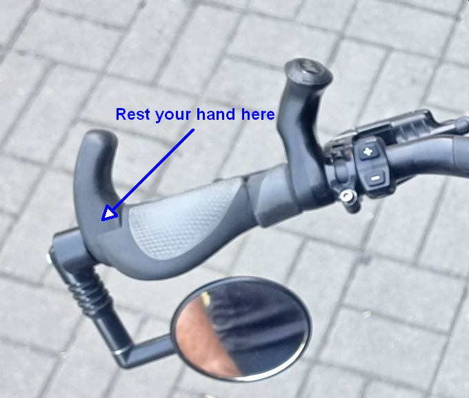

I am fond of Ergon GP2 grips in size S with small bar-ends on my Vado 6.0. (I chose size Small because of precious real estate on my handlebars).

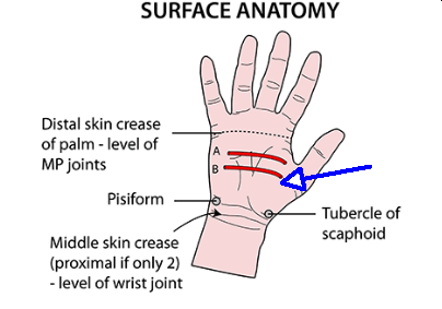

I don't know the English anatomy terms. I rest the part of the palm as indicated by the arrow on the GP2 junction of the bar-end with the grip and even do not hold the bar-end. It is very nice for riding a long distance with the tailwind.
I have completed the Vado 6.0 setup with Innerbarends 411, which work with any handlebar grip. I owned an older and heavier version of 411s before and was happy. Later, I had to replace the old 411s with a new lightweight version and am not 100% happy.

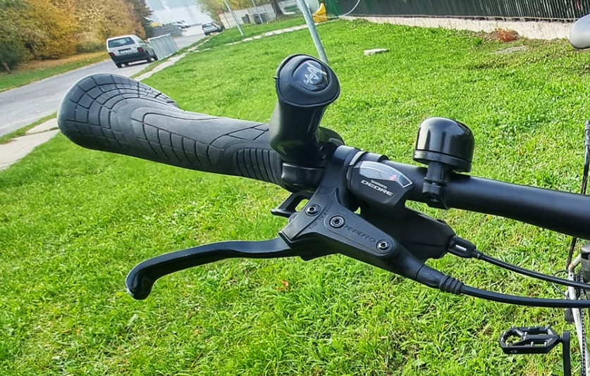

I use the SQLab 710 together with Innerbarends 410/402 on my Vado SL. The grips are very comfortable and the version of Innerbarends is perfect for me. I only regret I cannot have a small bar-ends with the 710s!
Again, you do not hold Innerbarends; you rest the part of the palm between the thumb and the index finger on them, and the fingers may freely rest on brake levers.

SQLab 710 with Innerbarends 410/402.

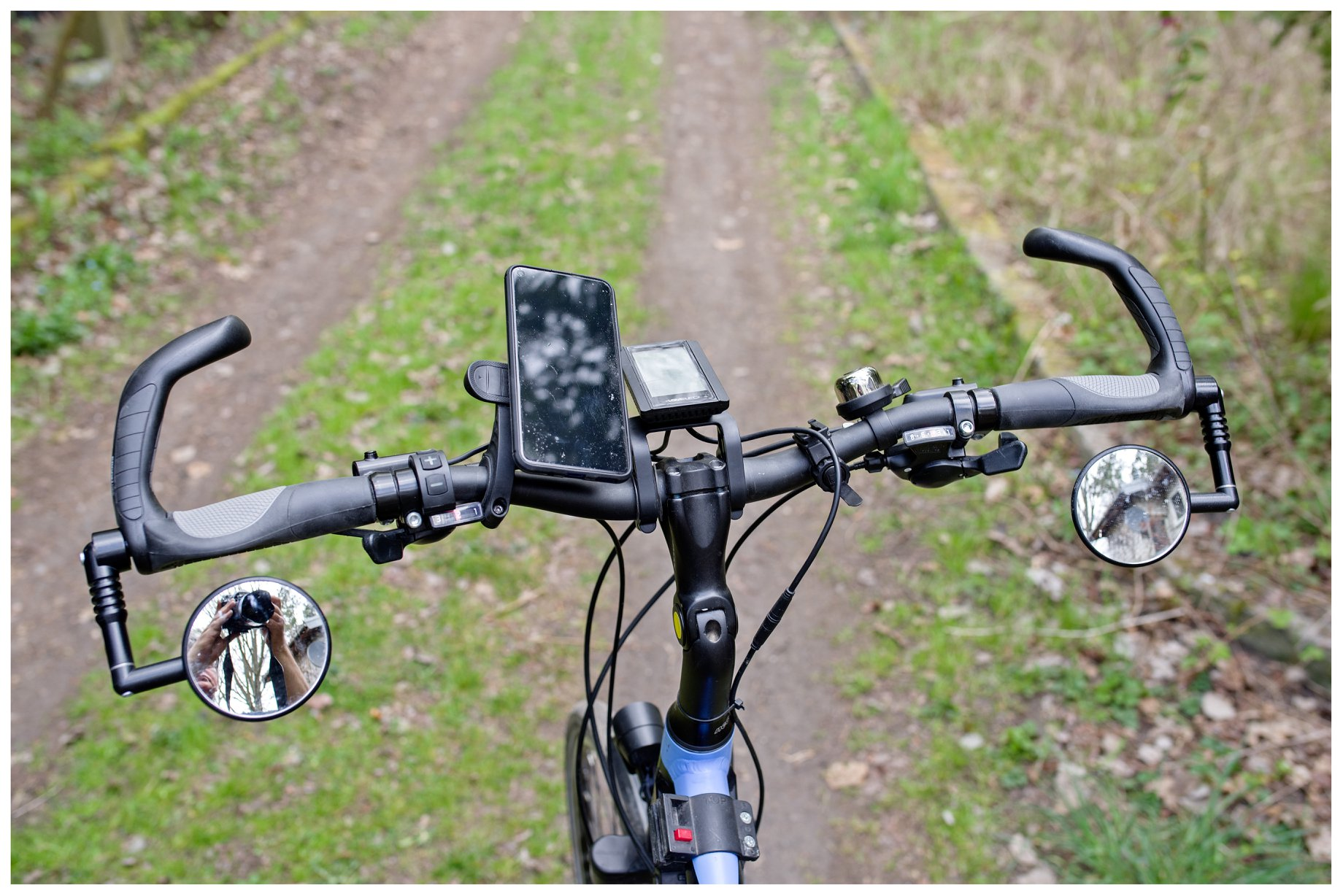

Ergon GP2 with Innerbarends 411

It would be very hard to convince you to use IBEs. I was almost hostile towards them when tried them for the first time. However, there were several respected Forum members trying to convince me I should persist a little to get hooked. After several rides, I discovered I was not using anything else but Innerbarends! Riding with them has become my second nature. That's why:
  • Innerbarends shall be installed at such an angle the hand properly resting on them feels neither "vacuum" nor "back-pressure". It is the sweet point, the neutral position
  • You never hold Innerbarends. You just lay the part of the hand between the thumb and index finger on them; big part of the hand near to the wrist is still supported by the handlebar grip
  • Your fingers naturally rest on brake levers. Even if you are the most surprised by a situation, the access to the brakes is instant. It is as instant as it saved me or others around me from an accident
  • Your arms are spread exactly as if you were a road cyclist (44 cm). Still ensuring a great control, you feel like you were resting your hands on the road bike "hoods".
  • Your body position becomes relaxed yet sporty, relieving several body parts, especially the butt.
