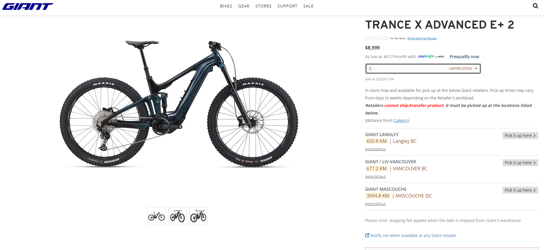

Their website shows zero stock in any sizes - that means there aren't any in the system, at dealers or otherwise. Did someone indicate there would be any to order? Maybe next year?
Think about Orbea Rise - some arriving early 2022. Or maybe even what might be coming in at YT Industries. You could be waiting a long time.

FYI, I also contacted several Alberta dealers with respect to allocation on the ’22 Trance X Advanced E and only one shop was expecting shipment around May at the earliest on strictly the base model. The BC shop where I acquired my Trance X E (2) had been allocated all models of the new Trance advanced and could potentially ship out as early as April with a refundable 20% down payment.
There is a 3 in stock a long ways away from me but want the 2. they havn't hit the market here yet they put them on there site you just can't buy them yet and really no one has shown me anything that comes close to that bike price and spec wise that's in stock.
FYI, I also contacted several Alberta dealers for their allocation on the ’22 Trance X Advanced E and only one shop was expecting shipment around May at the earliest on strictly the base model. The BC shop where I acquired my Trance X E (2) was allocated all models of the new Trance advanced and could potentially ship out as early as April with 20% down.
So - when are you putting 20% down?
I’m waiting to hear back from the sole AB dealer with regards to wiggle room on current pricing but not holding my breath. BC dealer was only willing to provide a 15% discount on parts/accessories. There has been some local interest with respect to my current ride but I'll likely wait until Spring to better gauge the used market which might bode well in my favor. One dealer that had 0 allocation did have Levo CC's coming in that were unsold at the moment but not in my frame size.
