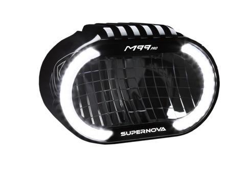

Hi Mark,
Yamaha PW system can't accept most of the M99 series. (M99 Pro or M99 Pure+) and it will take only M99 Pure which puts out only 500 lumens.
The new PW-X system can't even accept the M99 Pure. So, the latest 2017 systems can't accept any of the M99 series.
I have confirmed this with Supernova. The Yamaha system is not designed for such high power draw.
Your solution would be to try smaller lights like Supernova V521S or V6S.

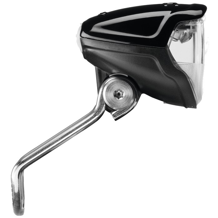

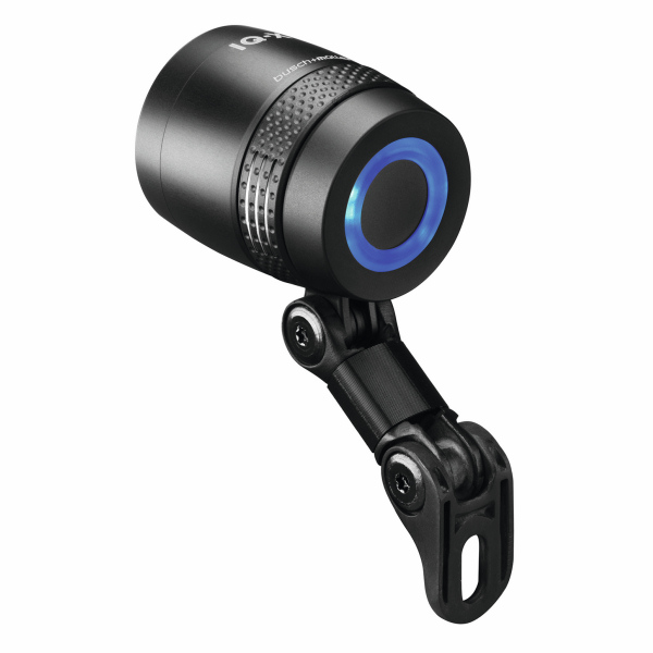

Busch & Müller IQ-X - A new introduction from B&M with a similar design to the classic Supernova Ebike light at a slightly lower price point. I think we're going to see this light a lot more in the near future. Currently there are a couple of Riese & Müller bikes that spec this light. (Note: their website doesn't show the ebike variety currently, but it is available)
Busch & Müller Lumotec IQ2 eyc - Nice mid range ebike light at an affordable price.

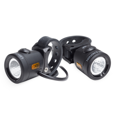

Light & Motion Nip & Tuck Set - Recently introduced. Comes standard with a 500 lumen headlight, but they have a 800 lumen version and a 1200 lumen headlight available.

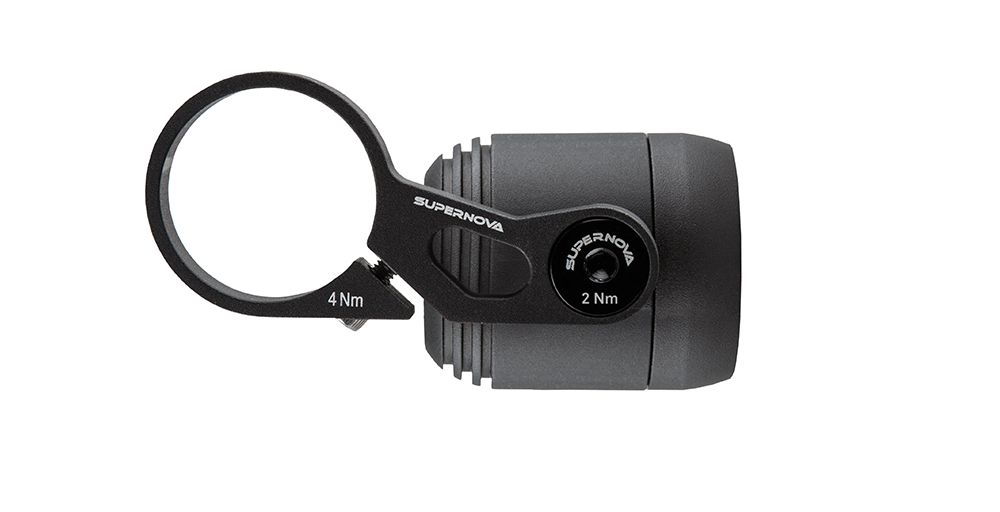

Supernova Ebike Light- Available with different mounting options for handlebars and forks. Most work with 6 volts, but they have some that will work with 12-60 volts if your system doesn't have a low voltage output and you want to connect directly to your battery.
Supernova M99 - Available in three varieties M99 pure (6 volts 500 lumen low beam only), M99 pure+ (6 volts 1100 lumen low beam), M99 Pro (24v-60v 1100 lumen low beam, 1600 lumen high beam). This is the best ebike light on the market at the moment coming standard on many high quality bikes like the ST2S, Riese & Müller Delite GX and the Bulls Dail-E Grinder.

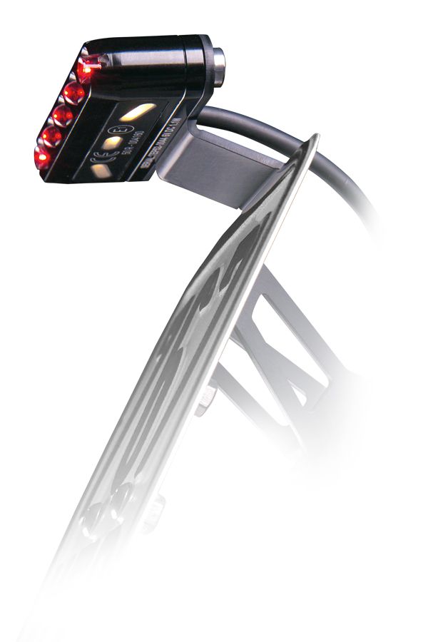

Tail lights are a little simplier, but there are several varieties available. We mainly work with Busch & Müller and Supernova. The most recent development here is the integration of brake lights which we're starting to see with the Stromer ST2S and the Supernova Brakelight shown below.
