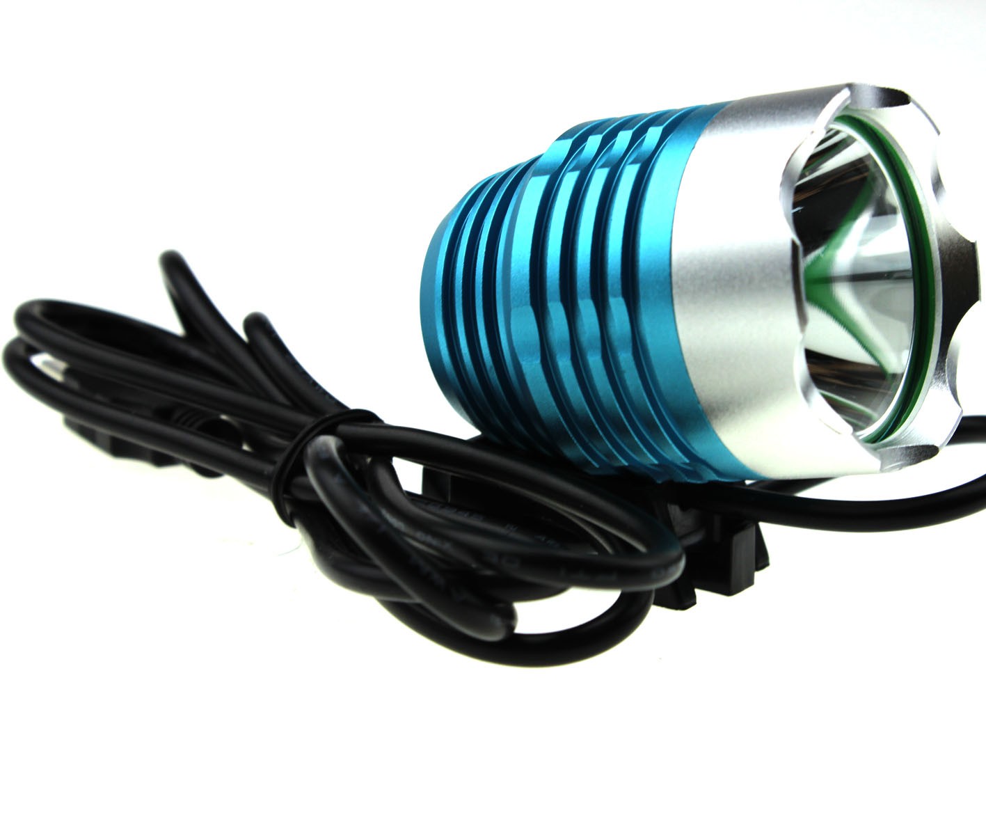

usb_bike_light_1cree_xml-t6_usb_4.2v_3_modes_1200lm_led_headlamp_headlight_bike_bicycle_light_4_.jpg
You're experience's are a bit outdated, some of today's E-bike lights that run off the bikes battery are extremely bright, and compare favorably with motorcycle lights.
Inexpensive, sturdy, rechargeable, detached battery, very bright!!! Many Cree lights from China work great at a great price. Plus you will not get this lumen level with an integrated light. You are better off with a light that has its own rechargeable battery...no wiring changes, no main battery drain.

In my experience, those tethered flashlights are a poor bargain,, and find lumens to be a poor measure of a lights actual worth. I rather make the minor effort to have my primary lights fully integrated and permanently mounted rather than a jumble stuck on rubberbands and Velcro.
