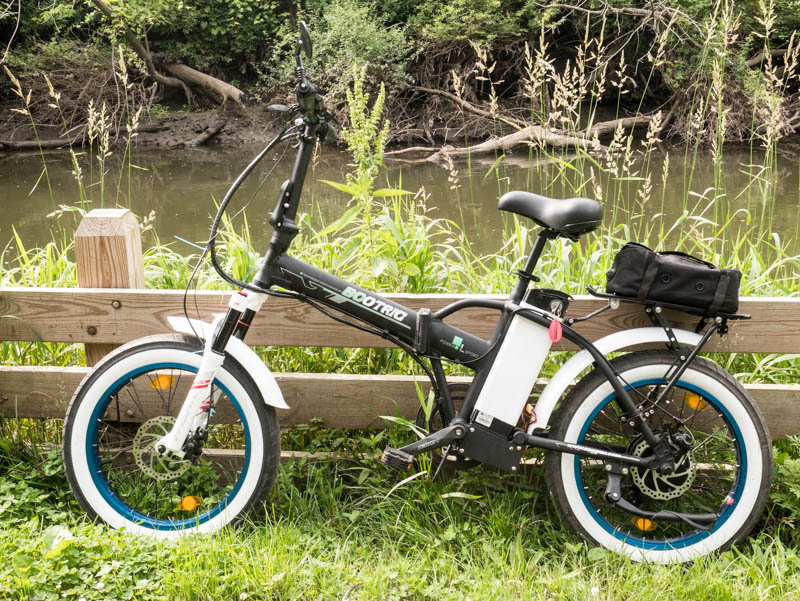

I can say unequivocally, our Ecotric's have surpassed our expectations in both value and performance. I have the 26" snow fattie and my wife the (both are 36/500) fattie 20" (folder). I do find myself daydreaming about the full suspension Hai Fattie but love having the simplicity of a rear hub. Anyway enjoy your new Ecotric :)
Yes. I really wanted the white. We're partway there.
