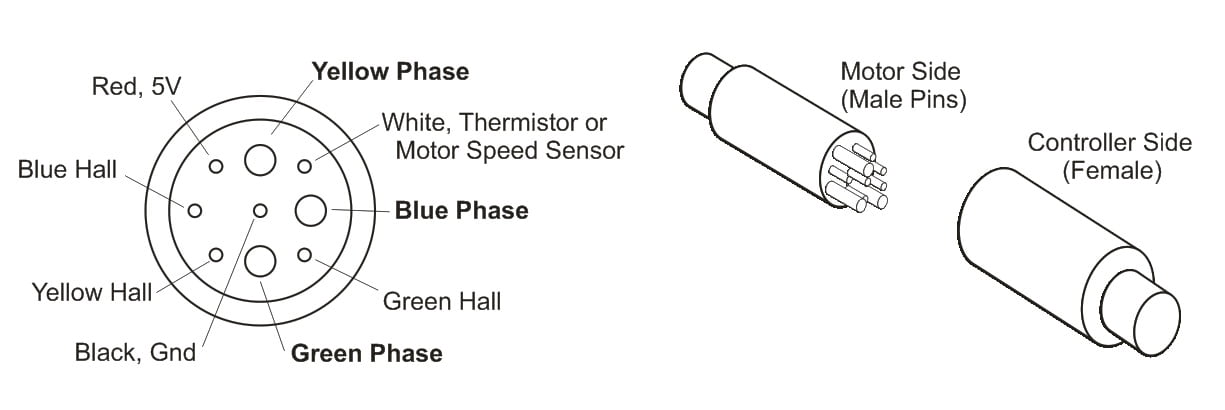

The first time I spliced together a 9 pin motor cable nine years ago, my display told me I screwed up by announcing a Hall error, I unwrapped all the heat shrink and found one of the phase wire solder joints had cracked when I did the heat shrink.

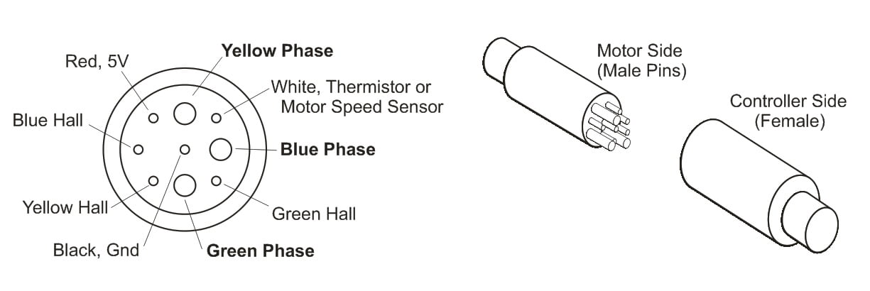

Checking continuity won't tell you if you crossed a wire during the splice. You probably didn't do that, but you may have bought a cable that had different color codes. I've purchased close to a dozen 9 pin motor extension cables and never seen them vary. One was so cheap that the alignment arrow was molded off by 30 degrees. Bummer, but it worked. Here is the pinout by color. Check it against the half cable that you didn't use.

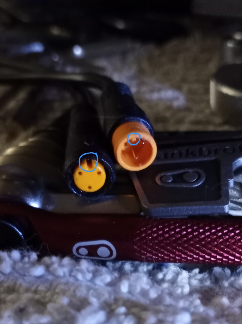

alignment arrow
Why do they put the black 5HIT on the black 5HIT? I did a trike controller yesterday. You are connecting upside down in a dark hole and where is the friggin' little black arrow?
On some builds I have gone through and touched each connector arrow with a yellow ink pen before starting. And it is more accurate to mark at the notch and rail because the arrow can be off by the amount of one pin and then you wreck the connection.
Yeah, that sucks. 😀
I just look for the alignment pin and notch and line them up.
They're a lot easier to see than the arrows.
The pins are recessed a bit so you can rotate the connectors slightly until the alignment pin goes into the notch without bending the pins.
I pack all my connectors with dielectric grease to seal and protect the connections.
It makes the connectors easier to connect and disconnect as well.

Found my mistake, what a dummy. I used the female end of an extention cable to splice in and didn't take in consideration that the wiring would be just the opposite when the two cables are connected. 🙄
A classic mistake. I've done it many times myself.
