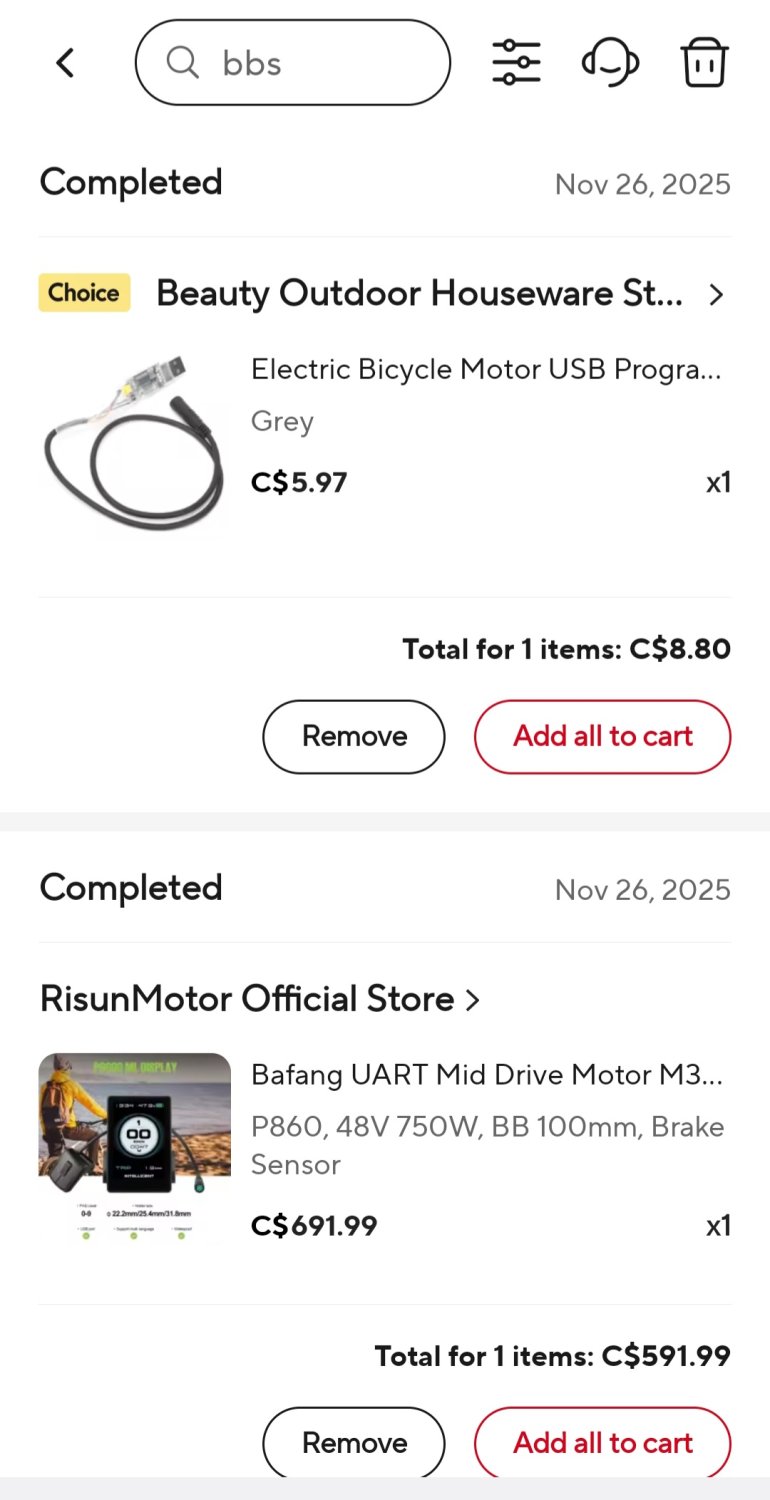

  • EggRider also cannot read/write the controller
  • Programming cable also cannot read/write the controller

Have you tried a new 1T4 cable?
If so, might be easier to just replace the controller, about $150 USD
