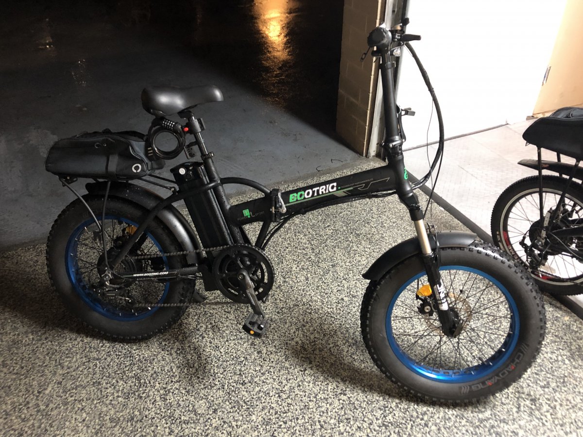

I have the first one. Here it is on ebay for $120. I wanted an air fork, if I was going through the trouble to change.
(Link Removed - No Longer Exists).

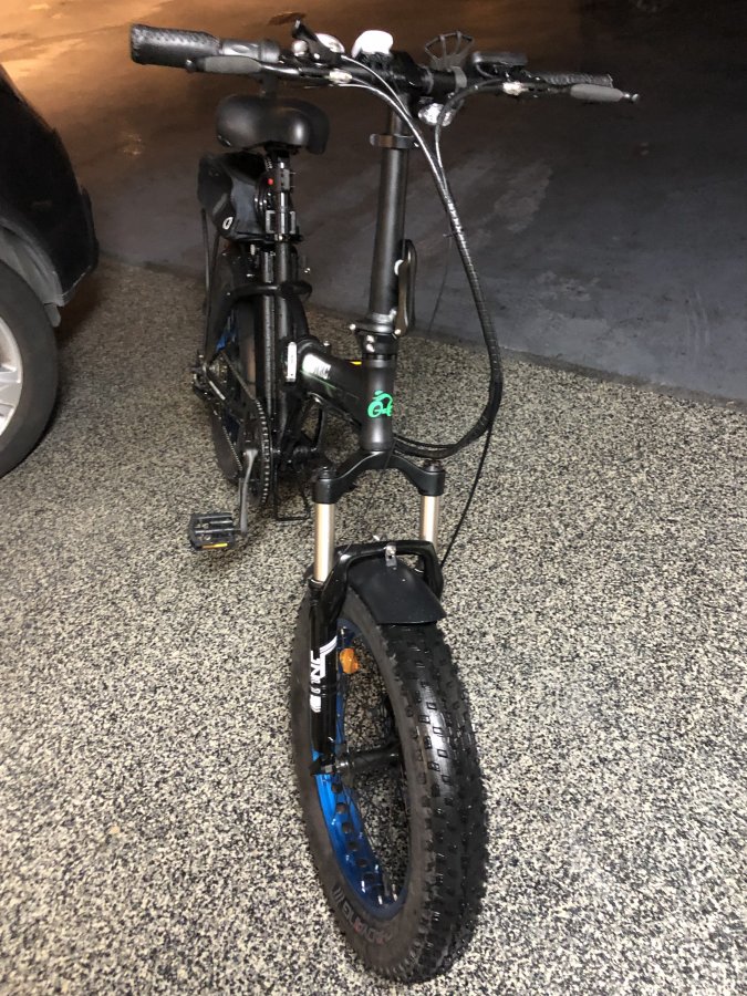

Your second one is mislabeled. It's really a 26" fork. I have seen this style of non-air 20" fatbike suspension fork on ebay for about $89-$99. I believe it is the same caliber of suspension fork you might find on the Radmini, Scooze, or XP Lectric, but I could be wrong.
I got the ($105 on EBay) suspension fork installed per your suggestion. Not too bad. I’ll figure out how the hell to set it tomorrow.
It’s a different ride with the front ~3 inches higher. Not better or worse per say. Just different.

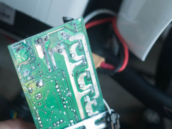

Got caught in a 2" rain a mile from home on Monday night. Made it home completely soaked, but I wiped down the Ecoctric and removed the battery before I went inside. However, the next day it didn't run. When I opened the controller compartment, water came out. Uh Oh. I could feel the controller shaking slightly because water was inside bubbling away, so I cut the power and opened it up. The bottom of the board had grey sludge all over it. I hit it with some rubbing alcohol and let it dry for a day, not having much hope.
Well, I was lucky since I only powered it for about a few minutes. It worked the next day. I put it all back together. By the way, it's a little tricky to re-attach the heat sink plate if you take apart the controller. Water is going to get in there. Maybe we should apply a second layer of silicone seal around the controller end plates.
This same thing happened to me when I got caught in the rain on the way back from a vacation with the bikes on a car rack. I had taken out the batteries and wrapped plastic bags around the display panels, but there was really no good way to cover the Ecotric controller box, which looks water tight, but is not. (The X-Treme E-Rider Mini Bike avoided all water infiltration.)
Well, the Ecotric bike started intermittently crapping out a day or so after I got back, and I couldn’t figure out what was going on until (after many less drastic steps first) I finally cracked open the controller and it was still moist inside. I used a powerful leaf blower for a few minutes until all perceived moisture was gone. It immediately started working fine (consistently) again. In the meantime, I had contacted Ecotric (or E-Go) through Amazon email, and they immediately responded telling me would send me a new controller. All they asked was they wanted to confirm my mailing address. That’s pretty cool and comforting for the future.
(I searched the Internet for a replacement for this controller and literally zero came up.)
I realized I didn’t install the fork correctly the first time. The (screw cap thingy) in the fork was lose (as I tried to re-use the one from the Ecotric) creating a loose steering wheel feel.
I finally figured out what it was called (headset Star Nut for fork - pic below) and ordered more of those parts on Amazon.
Also, using the same tension (wheel) locking mechanism that came with the rigid fork on the suspension fork put so much “squeeze” pressure on it that it locked the springs and the fork would not “unlock” or “bounce.” Thinking the fork was broken (or just a piece of crap), I felt it release tension when I took the fork off the wheel. I then realized I had to use the big wheel screw that came with the fork instead of the spring wheel lock that came with the bike. I got into the ball bearings and everything to get it replaced. Definitely a bigger and messier project than anticipated, but it all worked out. Now it rides really nicely on the fork. I tested it over a speed bump at ~10 MPH and it felt like riding over a garden hose... A week ago I hit that bump accidentally at 5 MPH and it almost sent me flying off the bike.

I was also able to remove the (Chinese branded) decal stickers on the fork. I was thinking about buying some RockShox stickers on Amazon and sticking them on the fork, but I’m not (quite) that vain or lame. 😉
FYI - Air fork on ebay for $229 + $29 shipping. I think it’s compatible, but I’m in no rush to try this again anytime soon.
Ecotric seems to be pretty supportive. That controller is probably only a $10-15 part wholesale though. To replace it on our own, probably impossible to find. It's really a fairly high current unit in a small box.
On my other ebikes (DIY), I put the controllers under the rear rack, where they were exposed to water spraying up from the tires. However, I also ran a bead of silicone seal around the seams. Also added a dollop of silicone where the wires enter the controller. After my Ecotric incident, I added fenders to those bikes.
I do need to go back inside my Ecotric and seal the new controller in a similar fashion. I didn't do that yet. I just wanted to get it working. The hole for cables in the front of the bike's compartment is probably where the water enters.
