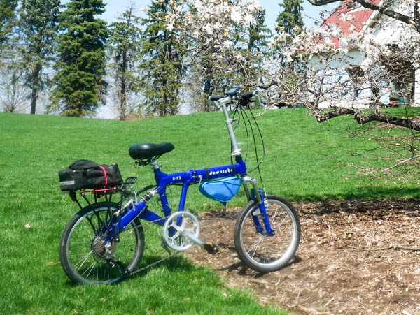

Nice folder. It's hard to find third party rear racks for full suspension bikes. especially folders. Does Bikeberry have them>
My wife stuck with her full suspension folder with 20x2" wheels. They used to be 20x1.5", but I changed them over to wider tires for packed gravel (Illinois Prairie Path), but we haven't been back on gravel for months. I hear you about the riding season ending in about 8 weeks. I haven't brought my bike down to the Lakefront yet this summer.

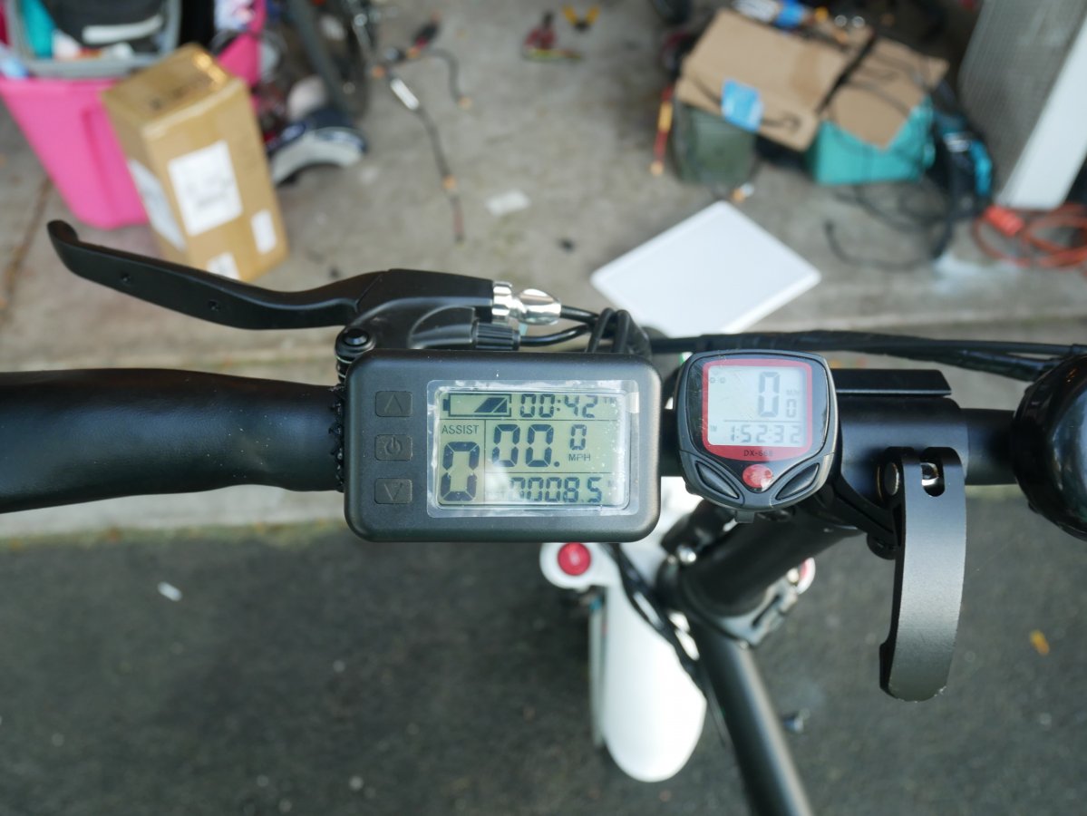

I changed out the Ecotric controller for a LCD/controller with 5 level PAS ($55 from PSWpower.com in CHina, but they take paypal). The connectors differ, so there was a lot of splicing., but the replacement fit, and I took the opportunity to shorten a lot of the cables. I chose to use the smaller LCD1 display, although there is a larger LCD3 on my wife's bike that is much better (same price), I kept the little bike computer as the LCD speed is about 5% optimistic,

Is the PAS on that new 5-speed controller very smooth on level 1 and 2? My main beef with the OEM Ecotric controller is that PAS 1 has too much acceleration and speed.
Do you have the product name/model info for the 5 speed controller used on your wife’s bike? (Is it this one? http://www.pswpower.com/ven.php?cargo.2019-3b-fpj2) Also, where is the controller hidden?
I attached an inexpensive speedometer on the Ecotric (link below) that has a sufficiently long wire to work even when the handle bars are fully extended. You just have to update the wheel circumference on the inputs (in MM), so I finally was able to apply my high school geometry skills. 23 inch diameter wheels x25.4 (1 inch = 25.4 MM) X Pi (3.14159) to calculate tire circumference, so the Ecotric’s 23 inch diameter tires have a 1,835 MM circumference. The linked speedometer (and bike computer) below has MPH and KM/H.
DREAM SPORT Cycle Computer Wired, Accurate Speedometer for Bike with Trip Distance and Timer, Waterproof Durable Bicycle Computer https://www.amazon.com/dp/B07HGX61WM/ref=cm_sw_r_cp_api_i_0HAwDbNARGQPB
I use this one. Only need an LCD, I used the Ecotric's throttle, brakes, PAS sensor and speed sensor (in the motor). I chose the basic LCD1 but could have had the LCD3 (which I already had on other bikes) for the same price, and that displays temperature, voltage, and wattage, and according to the manual (never tried it) allows the power to be set anywhere between 50-100% . Assume the color 850 display is similar. The display/controller will have the right plugs, but one has to splice in the other five connectors. I've been doing this for a while, it's probably not for someone who hasn't soldered. Maybe I'll describe that sometime.
Without the advanced LCD, The sinewave controller has a more basic two level setting like the Ecotric via a jumper. Set at low, I can ride slowly at 10 mph in PAS 1 vs 12 mph in the high mode with the newer controller. As mentioned, with the right LCD, it's much more adjustable.
Actually, I already had the controller as a spare for my other ebikes, so I might not have done the conversion. I had installed the microswitch on the Ecotric controller jumper wires for low/hi power and that tones down the PAS1 response.
