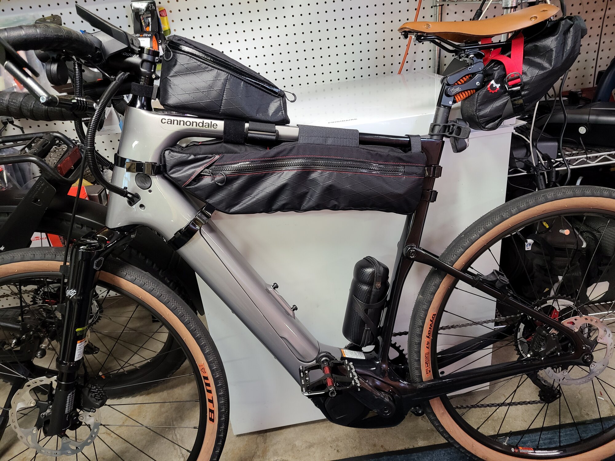

The Cannondale Topstone Neo 2 is a carbon fiber frame gravel bike with a Shimano GRX group set with a 2x13 22 speed drive train. It has the Bosch speed motor that assists up to 28 mph and a 500 watt hour battery. II have the Neo 3 version with a lefty front fork and a 1x11 drive train. At 190 lbs I get close to 100 miles in Eco assist mode, around 65 miles in Sport mode. The bike weighs 37 lbs.
Although it is a designed gravel bike, these bike have impeccable road manners. They are hard to find but there are some dealers that have a few in stock. Also they come up late model used on the Pros Closet web site.

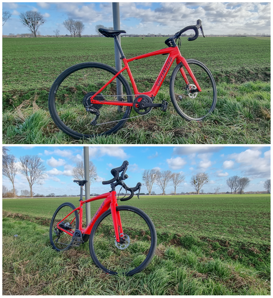

First of all, the OP asked for a road e-bike. Topstone is a gravel e-bike and that makes a difference for a roadie. Although the Topstone is pretty lightweight as for an e-bike, Specialized Creo SL is even more lightweight. The Specialized SL system is unique in the sense it is not only lightweight but it also ensures a long range provided the cyclist is ready to get some workout. I could say a lot about totally natural riding experience of the SL e-bikes that feel traditional e-bikes but add some steroids to the ride, which is vital upwind and uphill. An SL e-bike can be easily ridden without any assistance.

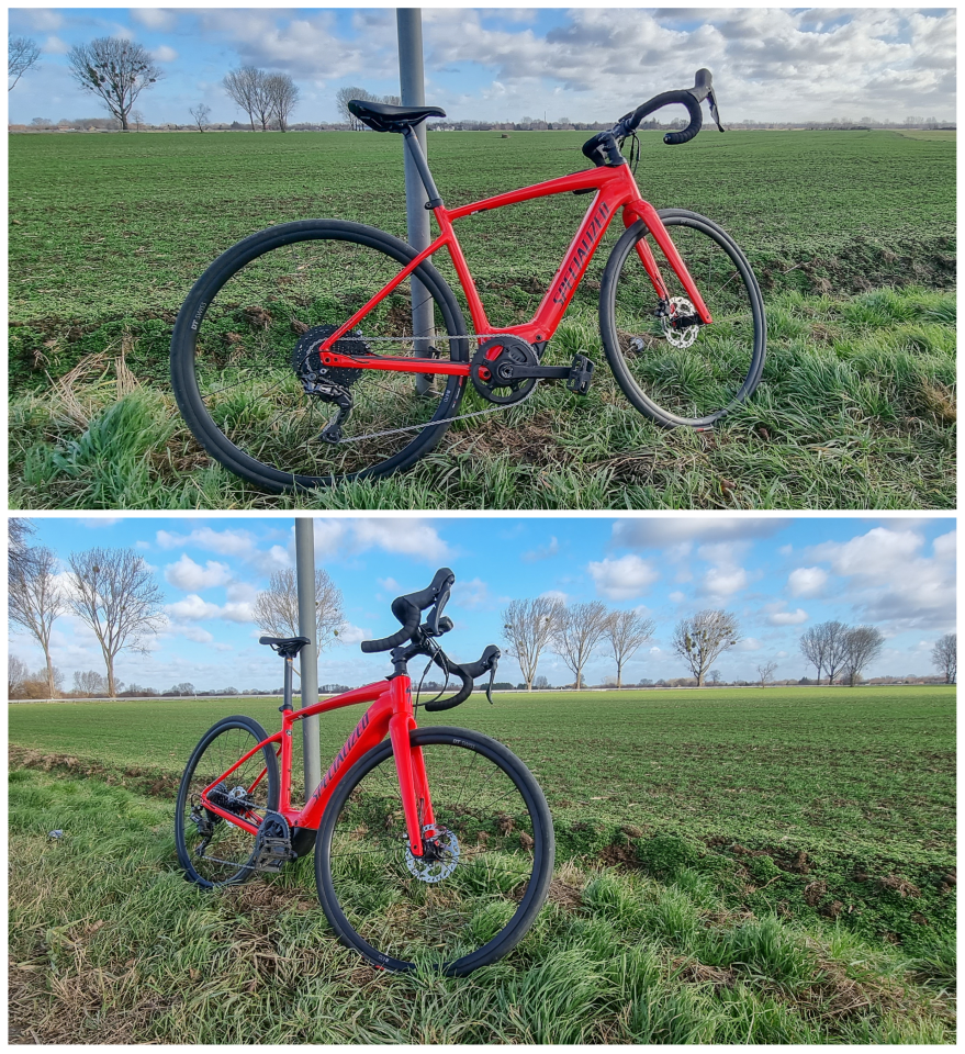

Regarding the range, it can be easily enhanced by adding a Range Extender, a 1 kg (2.2 lb) water-bottle-battery. And, Specialized Turbo Creo SL is at the latest version of the Specialized system, while the Topstone is still using the older Bosch E-Bike system (not the Smart System). The Specialized system ensures full connectivity with sports devices, and it is fully tuneable (so the rider can easily manipulate assistance levels for either long distance or fast riding).
The OP is already a Specialized e-bike rider. This is my explanation for my curt "Specialized Creo is the answer".
The aluminium version of Creo SL I demo-rode.
The real disease of this Forum are some people like Tom who have never ridden a premium e-bike but form opinions (you Alaskan are a different person). I took my time and spent money to give a Creo a long demo ride on a very cold Autumn Saturday. I decided that e-bike was not for me just because I could not really ride with drop bars. Otherwise, it is an excellent road e-bike. Besides, my big Specialized e-bike is a Euro equivalent of the OP's Vado 6.0, and I also ride Specialized Vado SL.
There is a big community of Creo riders in these forums, and I am sure they would like to share their experience.

It’s super light for an ebike (claimed weight of 26.8 pounds), the Future Shock 2.0 works great, and the carbon seat post that came on mine has a noticeable amount of compliance, but not too much.
I have a Range Extender, so I don’t worry about range at all. My longest ride thus far was 49 miles at average speed of 13.8 mph. As I was slowing for pedestrians and road crossings, I actually rode much of it at 18-20 mph, and sometimes faster, and I still had 43% of battery remaining at the end of the ride.
It also came with the SRAM AXS derailleur, which shifts via Bluetooth communication (not every Creo model has this though), and it shifts absolutely precisely every time.

There are certainly trade off between the two bikes. The Topstone weighs six to eight pounds more but its motor puts out 85 Newton Meters of torque, as opposed to 35 Newton Meters on the Creo. The Topstone Neo battery is 500 watt hours, the Turbo Creo is 320 watt hours (Specialized offers a 120 watt hour range extender that adds 2.5 pounds). If you want lighter weight with less than half the motor power and 38 % smaller battery, then the Creo is your bike. I think the range of both bikes is comparable as the Creo with its lower assist, will use less power per mile.
Precisely 160 Wh at 2.2 lbs. It makes 480 Wh altogether. The number of Range Extenders is technically unlimited. I happened to carry three REs (one on bike) and two in a backpack on a demanding gravel group ride with my Vado SL.
