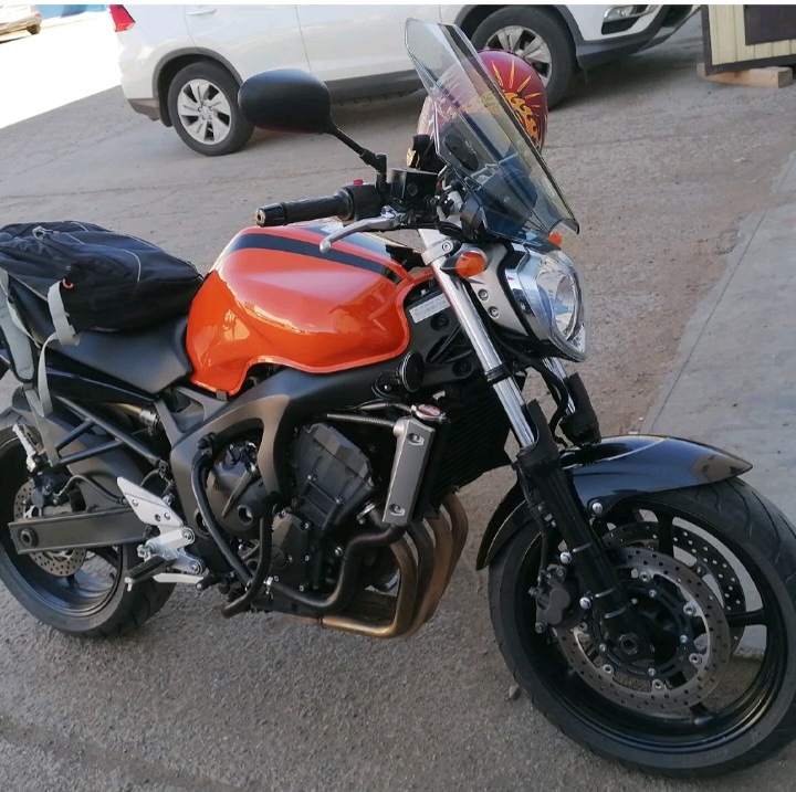

From my perspective as also a motorcycle rider, the combination of wind noise, lack of decent lights and the lack of good rear visual view, makes the bicycle too dangerous to continue riding without improving both situations.
I am looking at installing a light wind screen, moped or motorcycle mirrors a strong high beam headlamp, taillight and a loud horn. Yes this all increases weight and yes the windshield increases drag (really not that bad under 20mph and fairly similar to an upright position rider)
As for the windshield: The first major benefit will be that I can hear whatever is coming up behind me due to the lack of wind noise. I have similar windscreens on my duel sport bikes that allow almost a silent ride. The second winter benefit being that it cuts the direct wind to the face and upper body. This would tremendously improve the winter cold and rain riding experience.
As for the mirrors: Large moped / motorcycle mirrors would not allow anything to come up behind me visually. IMO the mirrors must be in the field of normal view- not something that needs a look away, continuous monitoring.
As for the high aim headlamp and horn: A warning system that I use on the motorcycles whenever I approach an automotive driver setting at a stop or preparing to make a turn. A quick and slight turn towards the car aims the headlamp into their face area, followed by a horn blast. It gets their attention before you get to the point of no return where there is nothing you can do but get hit. Having a bright rear brake lamp along with that tail light, allows you to flash your brakelamp a few times as you see a rapidly travelling vehicle coming up from behind. I personally do not hold the traffic lane as is the practice of many die hard cyclists that think to change the worlds bicycle awareness... I get the hell out of the way. It doesn't matter if you have the right of way if you are dead or wiped out. That is how I see it anyway!

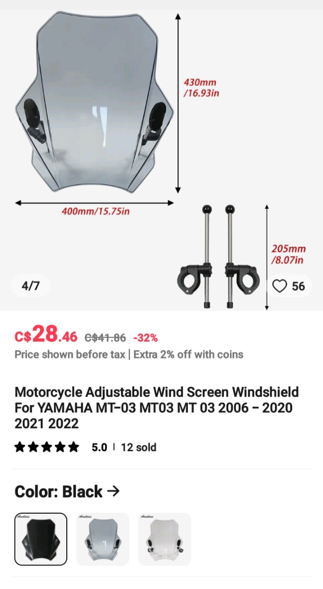

I can across this cheap windscreen to test out: (still looking up other stuff) https://www.aliexpress.us/item/3256805670021274.html?spm=a2g0o.productlist.main.7.5ac57536uiHhyZ&algo_pvid=554667f4-bb42-4c06-b731-4c6144263c66&algo_exp_id=554667f4-bb42-4c06-b731-4c6144263c66-3&pdp_npi=4@dis!USD!27.82!4.46!!!197.74!!@2101f49417031960656028814e79ab!12000034594795241!sea!US!0!AB&curPageLogUid=VmH24fLiq3m6

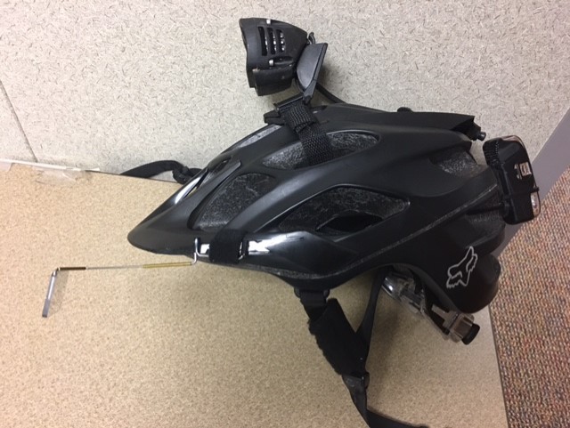

  1. I use a helmet-mounted mirror and it is more than adequate.
  2. I wear hi-vis clothing, usually including a reflective vest and reflective ankle straps.
  3. I mount a light to my helmet in dodgy situations. Experimentation has shown that at the lowest power settings a helmet-mounted light is visible over a mile away.
  4. I use a rear blinky with an complex flash pattern that can be seen at least a mile away.
So far I have survived the onslaught. So far.

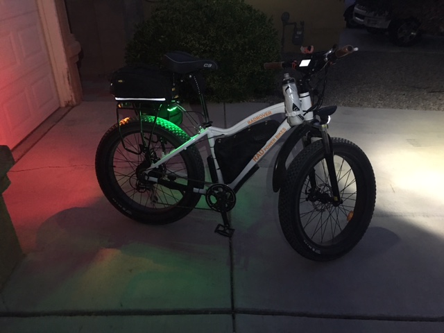

I also have a Radrover I use for work commuting. I pretty much did what @Mr. Coffee suggested for higher visibility when sharing the road with vehicles. The helmet mounted front AND rear lights with strobe/blinking capabilities is what I wouldn't do without.
Vehicles on side streets really can't see my low bike head/tail lights because of parked cars in my direction of travel or landscaping; but, they can see my high helmet lights. I also turn my head towards the car driving up a side street to alert them so they don't do a "no cop, no stop" at the stop sign at O'dark 30.
I also added side illumination to my Radrover. Noticed a lot of front/rear (e)bike lights don't do a good job at side illumination.
Helmet with Vis 180 rear light, helmet mirror, and Niterider 2200 Enduro Pro.
2016 Radrover before 5am work commute with Vis 180 rear light, Niterider 3600 Enduro Pro headlight, and LED 2 AAA rechargeable batteries light under rack for side illumination:

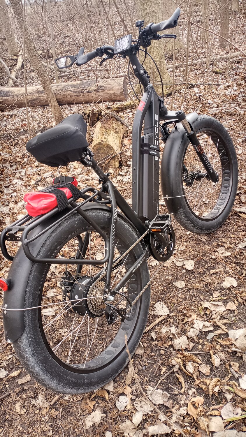

This is what I have but I see it is now unavailable. Not to worry as there are dozens or hundreds of other similar ankle straps on the market

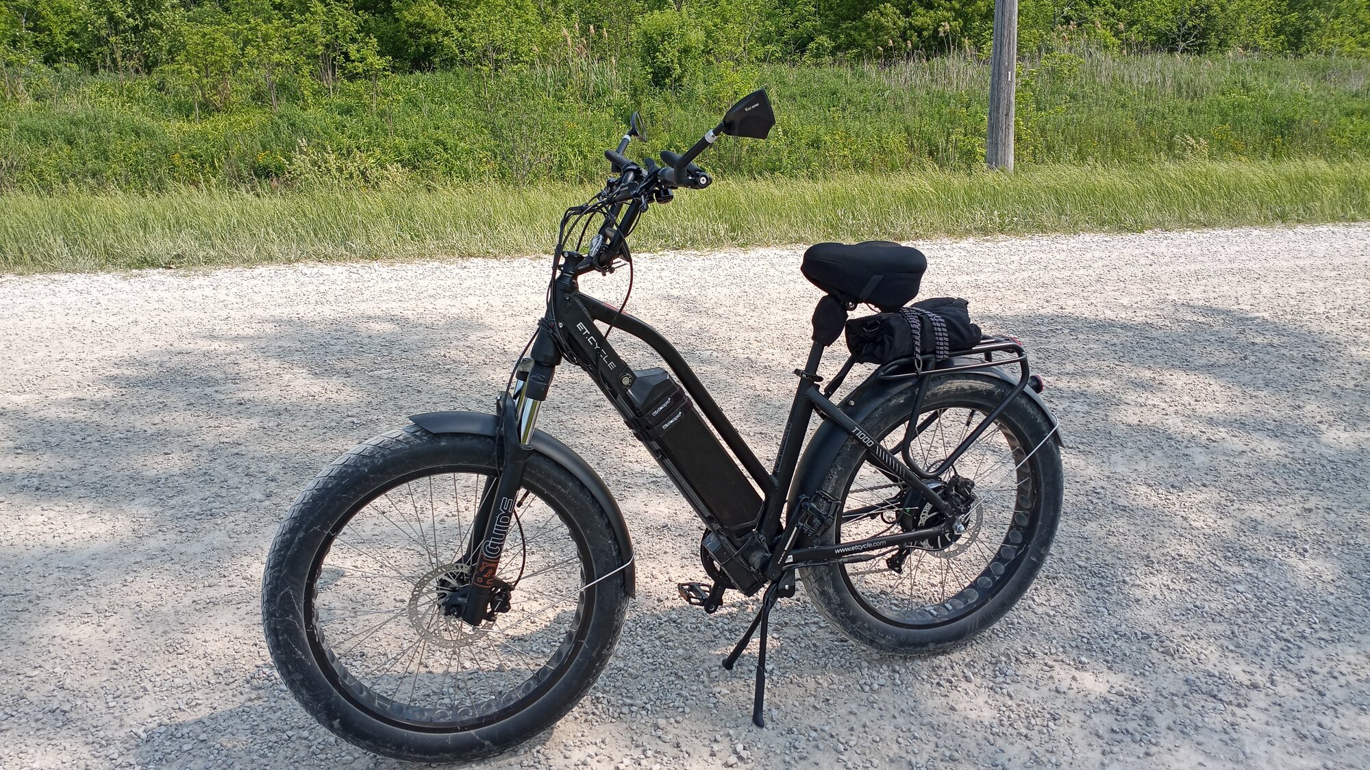

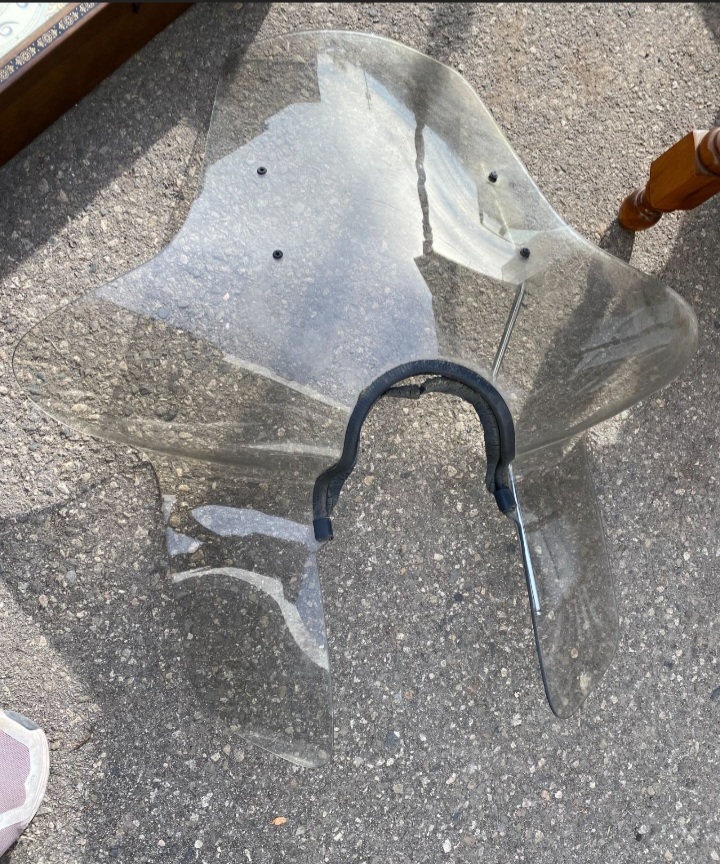

I put a windshield on my e-bike mostly because my e-bike looked really stupid without one. 😂
I checked out all the windshields I could find on AliExpress and I searched the comments about that windshield you linked to, and people said that the windshield is really thin and it starts to fold and flop around at about 20 mph so I chose this one,..
It is more heavy duty but it only has two attachment points so it does move around and rattle a bit.
I sit up straight and my head is way above the windshield so it does nothing for wind noise.
It is meant for a motorcycle and comes in smoked black which isn't intended to be in your field of view.
When I did crouch down to look through it, the view was all warped and the plastic scratches easily.
It needs to be made out of acrylic if you want to see though it without getting nauseated. (I get motion sickness easily 🤮 😂)
I never did try raising it up high enough to block the wind from my face, but it would be fully extended and teetering on the two support rods, and I'm sure that it would look stupider that with no windshield at all.😂

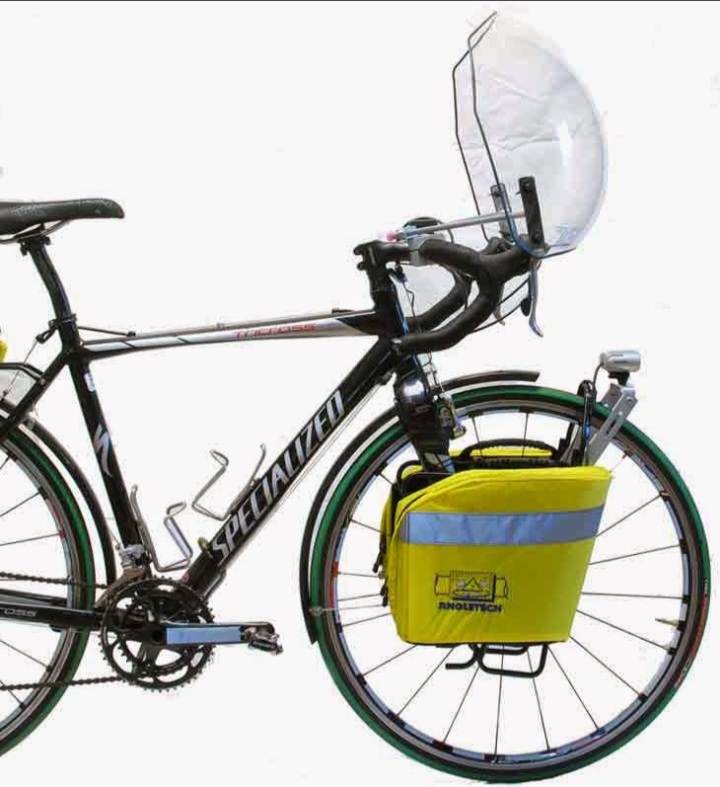

This is how the windshield is intended to be used,..
These are some pictures that I searched trying to find something that would block the wind in face,..
I did find a place that made custom bicycle windshields but they were $700 I think 🤔 and there were some motorcycle fairings/windshields that I found that might work but they were over $200, and I didn't want to spend that much money on an experiment.
Another thing I noticed is that the windshield didn't upset my steering in any really noticeable way. It is mounted to the handlebars and not the frame but the wind gusts didn't feel much different than without the windshield.
(My e-bike does weigh almost 100 pounds though, with my front wheel weighing 15 pounds. It take a big gust to affect my heavy steering.)

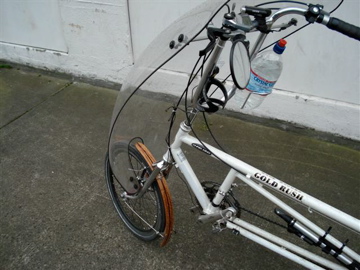

big full size fairings can work well the long wheel base recumbent the gold rush was the fastest bike in the world you could do 65 mph on it with a full fairing and sock. I had the fairing and it really helped at higher speeds. but it was noisy like a giant speaker. Plus it kept some rain off you but not all so the rain would run down your upper body into your pants. you just dont go fast enough to keep the rain and wind off your face.

My mirrors are sticking out so far that I have to turn my head to see them, I can't see them in my peripheral vision.
I have to have them that far out to see past my jacket, especially when I'm sitting straight up.
