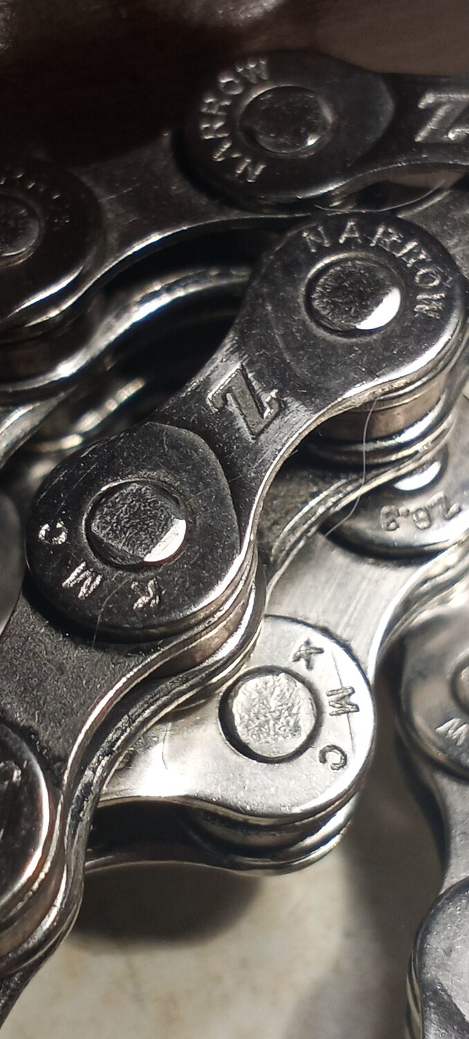

Question, my bike has a Shimano Altus 8 gear system. Will a Shimano 11 gear Quick link work on the chain or do I have to find an 8 gear Quick Link?
No.
The chain gets thinner as the sprocket count goes up so the quick link needs to get thinner too.
It's very speed specific.
Check for a brand name on your chain.

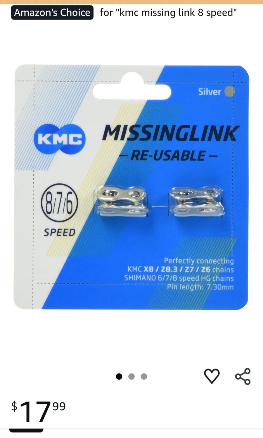

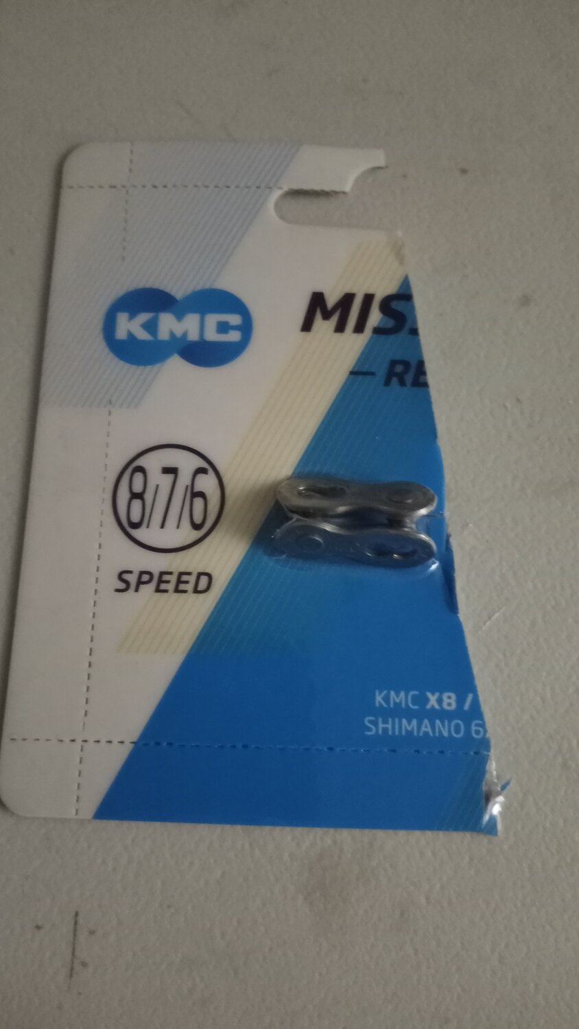

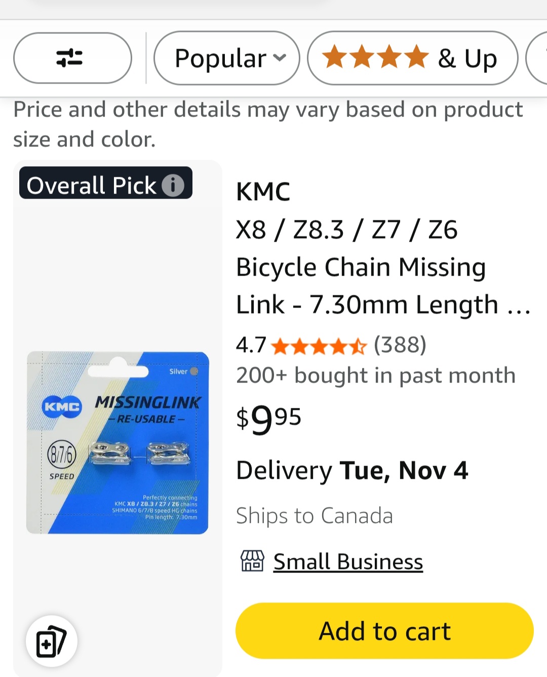

My chains are KMC so I bought KMC Missing Links,..
The Missing Link is good for 6, 7, & 8 speed chains, so it would most likely fit your chain.
KMC calls their Quick Link a Missing Link.

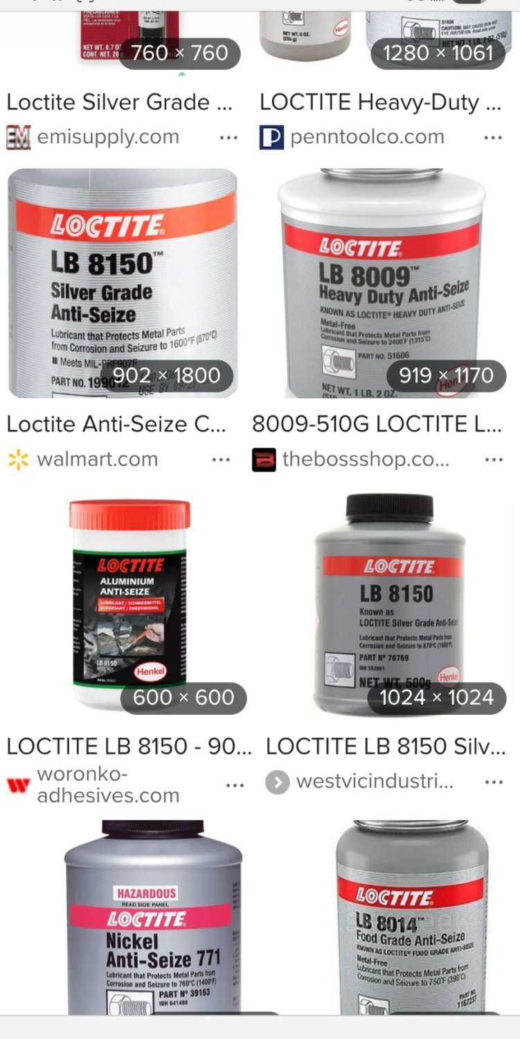

Another other thing that I did when I first got my first ebike was to remove all the nuts and bolts and put loctite on the threads as suggested by @Court who used to own this forum.
Then @m@Robertson said that he uses Anti-seize so I switched to that.
Then @Gionnirocket 's alter ego called me a liberal and said that I should just use regular grease.
I've kept using the Anti-seize but I don't use it liberally.
All you need is a little bit. 😁

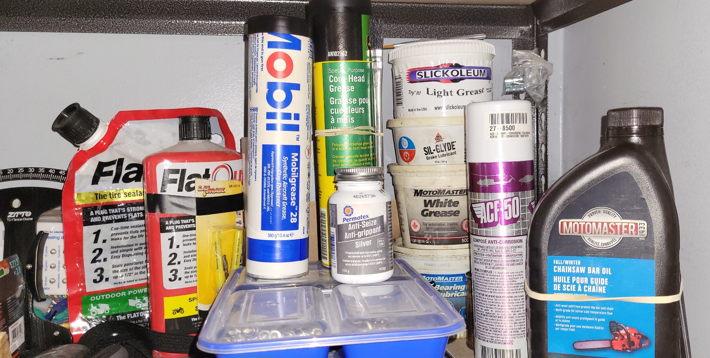

You need to choose your Anti-seize carefully too. There's many different colors and flavors,..
Looking at the list now, I think I bought the wrong one?
Maybe I shoulda bought the aluminum version?
My frame is aluminum but my bolts are stainless steel.
I don't know what to do??

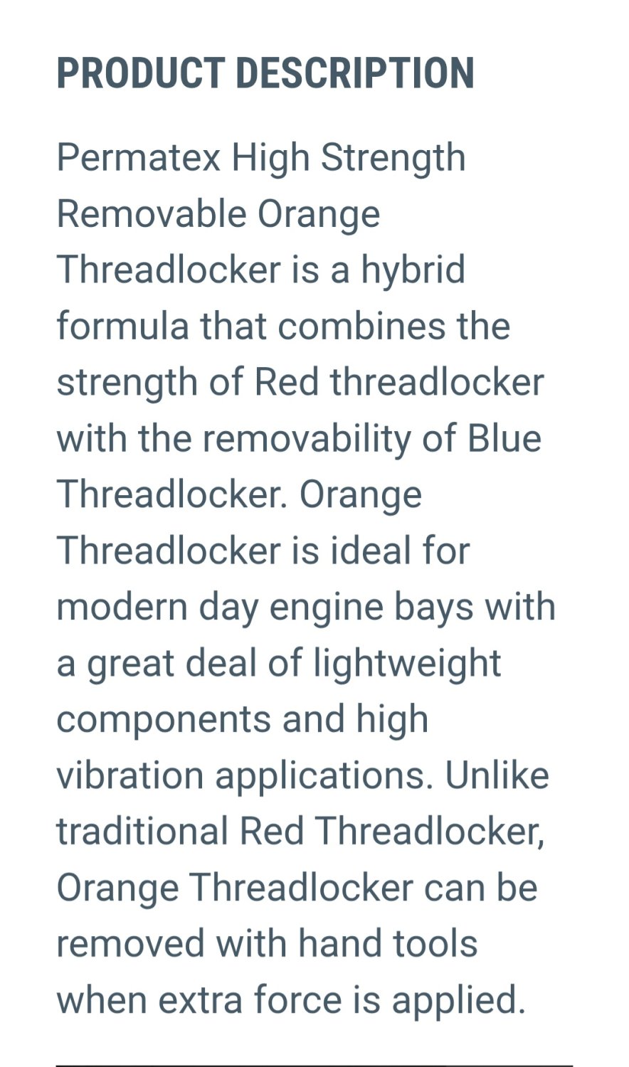

And the regular Loctite has lots of flavors too.
Blue and red are the most common with the blue being removeable and the red being permanent.
I went with the hybrid orange flavor 🍊 because I want to be able to work with my nuts without having to heat them up too hot or force them off. 😁
I can use my regular regular hand tools to get off. 🤪

I try not to keep dozens of products around and use what I have even if it's not the absolute best... unless that is, it's mission critical.
So a light grease works just as well as anti seize for me and I've never had an issue. The dreaded freewheel has never beat me or broken a tool. And when removed the grease was still intact.
Loctite blue on bike has never come loose or been difficult to remove.
ymmv
View attachment 201750View attachment 201751
I always thought that this was the Missing Link??,..
I wonder if that ½ ape ½ human is thinking about chain lube ? 🙃
It is the same KMC Narrow Z chain as yours.

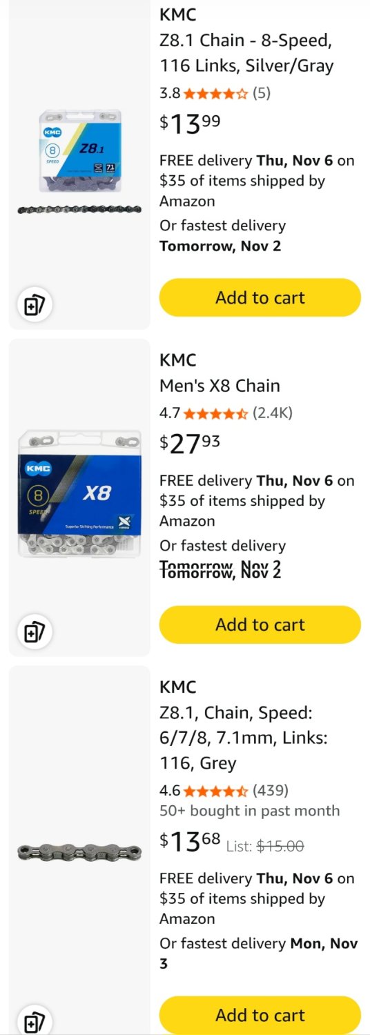

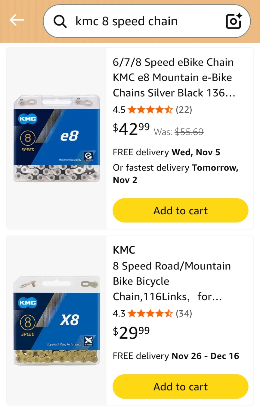

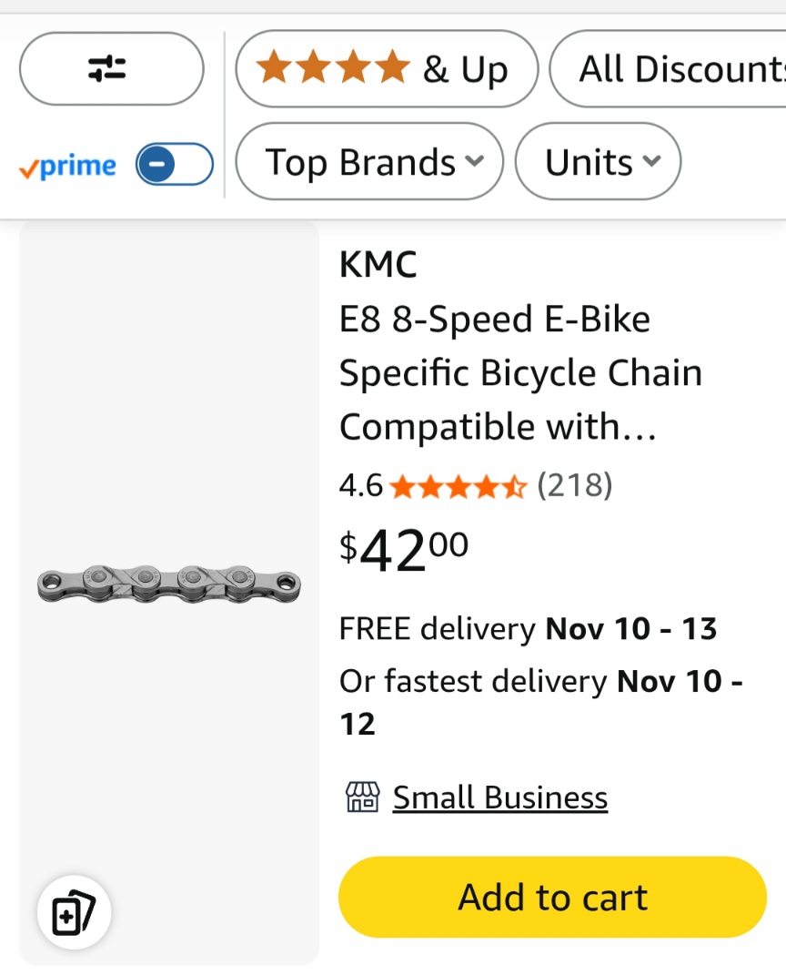

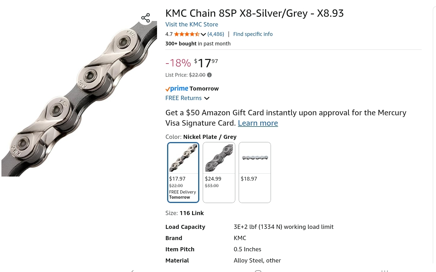

Here's some of what Amazon.com and Amazon.ca have to offer for KMC 8 speed chains,..
It looks like the e8 is ebike specific, and a better chain than the X8 (based on the price, but it could be a scam. 😁)
@GMA52 keep in mind that we have hub drives, and the chain isn't nearly as important as on a mid-drive.
As long as it doesn't rust out, it should last as long as your ebike.
Chain stretch measurement tools really aren't necessary.
(But it's a fun tool to have. I might get one. 😁)
No... The E8 is definitely better as I have owned both. That said with a hub drive it may be overkill.
I spent hundreds of dollars on fancy airplane and jet fighter lubes and sprays. 😁
I like collecting glues and tape too.
I still need to get some helicopter tape.
If it's good enough to build a 🚁, then it's good enough for my e-bike. 😁
ymmv

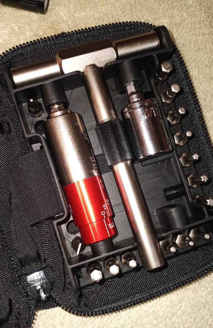

I spent $167 CAD on my very special torque wrench that I finally got a chance to use to reassemble my motor, but I couldn't find the damn torque specs for the bolts.
So I ended up using Blue Loctite, Silver Anti-seize, and Black RTV silicone.
None of the bolts fell out, and it looks to be sealed up pretty good. 😁
I still haven't used my fancy torque wrench.
Wanna buy it ?? 😁

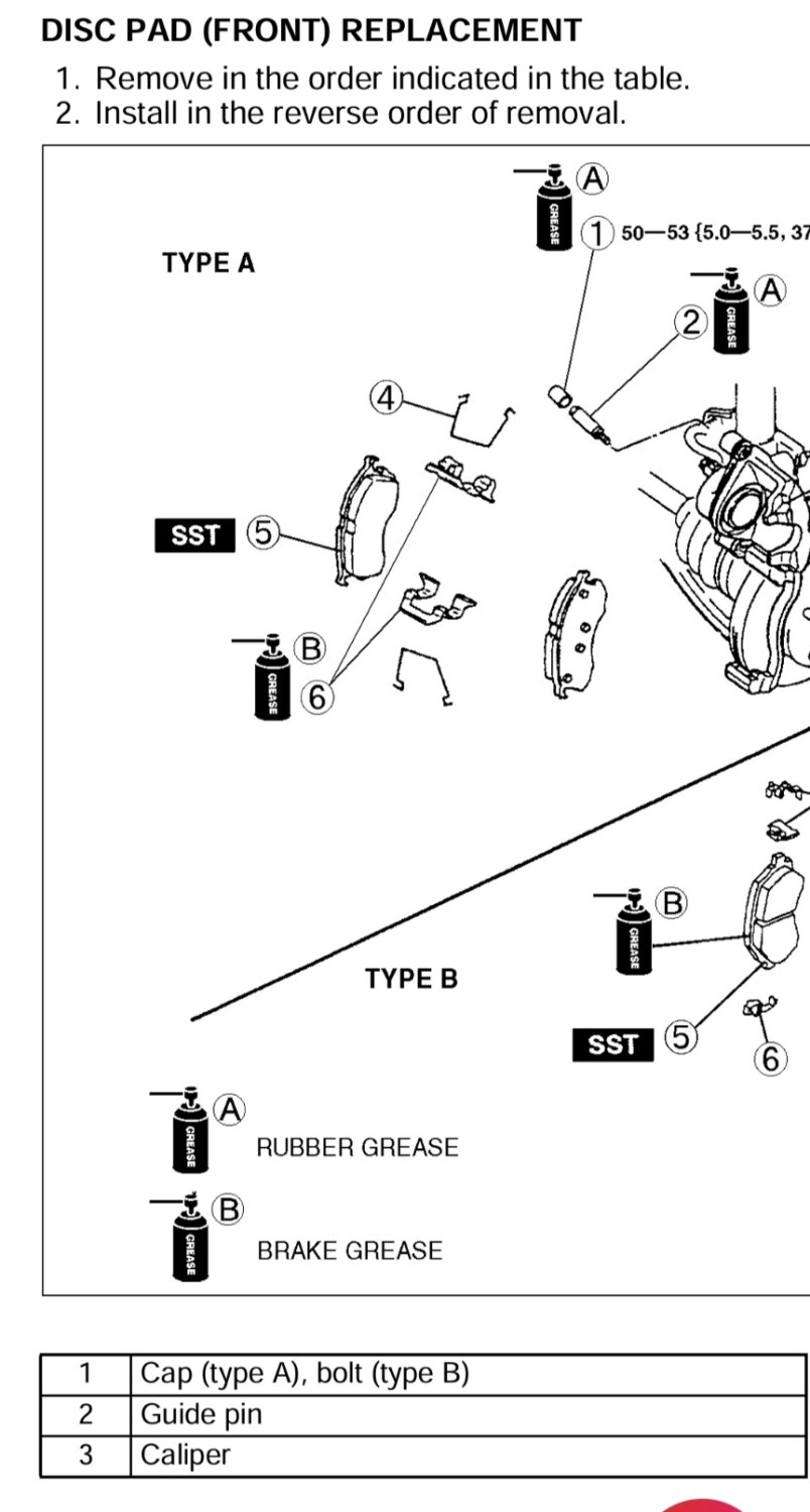

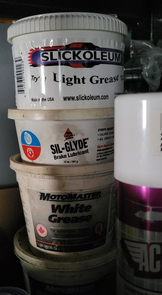

My favorite grease is automotive brake parts grease. It is high temp and is waterproof silicone. It is great for stuff like nylon gears and O-rings. It is tacky so it will hold things like washers in place during assembly.
I love that s*it !
I put it on everything !! 😁
There's two types of brake grease though.
I only had regular brake grease (dino grease) and Anti-seize then spent the $40 for the Sil-Glyde.
I previously had to grease the slider pins on my brakes twice a year, but the Sil-Glide lasted for three years.
Interestingly, silicone grease isn't compatible with silicone rubber, it tends to dissolve the rubber.
And regular grease (and oil) isn't compatible with regular rubber for the same reason.
You can use either grease on Urethane rubber.
