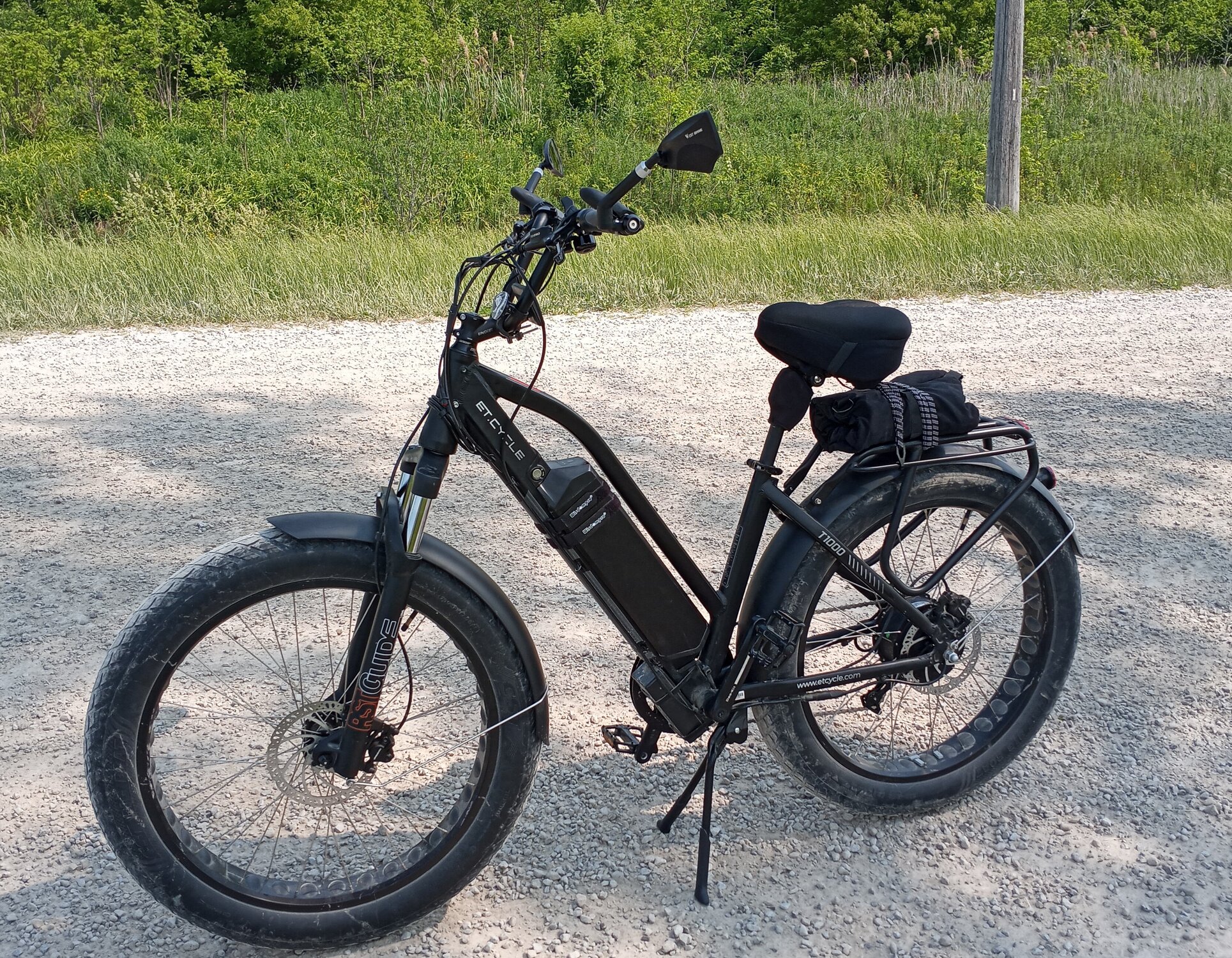

Sorry, I assumed that tire was the back tire.
Yeah, I cropped the picture too much, and it looks like the rear tire.
BTW: Nice Bike! Where did you get the windshield? :)
Thanks, I got the windshield on Aliexpress to cover up my stupid looking front end after I bought new steering stem and installed it backwards to get my handlebars closer, so I didn't have to lean forward.

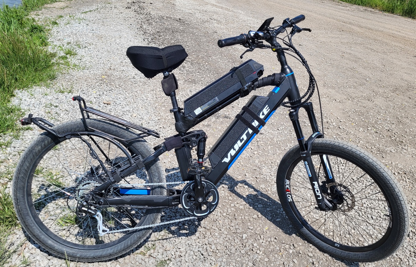

My new ebike is a mile off the ground and I have to stand on my toes to clear the battery that I attached to the top tube.
If I slip off my seat, I'm going to be in a world of hurt when I land on my jewels. 😁

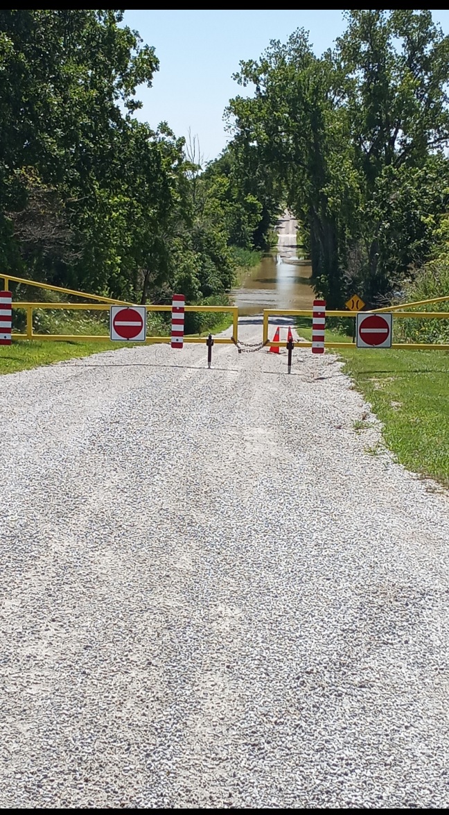

Very few. The only hills are where a road crosses a river then I finally get going over 32 kph,..
I've gone down this hill (when it wasn't flooded) and some others that are steeper, riding no-hands at over 35 kph.

Yeah, I'm 6' tall with a 32" inseam and I've got the seat set quite high, partly because a full suspension frame needs more ground clearance to help avoid pedal strikes when you squash the suspension, and I replaced my original forks that had 95 mm of travel with downhill air forks that have 160 mm of travel.
I also straighten one leg out at a time, with my heel pointing down from the pedal to stand on one leg to help take the pressure off my ass, so I need my seat set higher so I don't lift off the seat.
I kinda lock myself in so I'm less inclined to get thrown forward when I hit a pothole or some washboard roads.
I also have a suspension seatpost that compresses when I sit on it, so I have to raise the seat and fiddle with my seatpost spring tension to compensate.
And I've got a spring seat on top of the seatpost with a gell seat cover on top of that, and they compress a bit too.

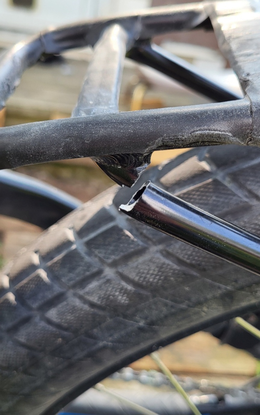

I spent months trying to get rid of a wobble or shimmy that would only happen when I carried a second battery on my rear rack, and only when I rode no-hands.
I ended up balancing both my wheels (by wrapping solder around the spokes), and broke two rear racks off my e-bike before I managed to make battery mounts for my top tube.
That got rid of the speed wobble but I'm down to only a couple multi tools in my pockets now.

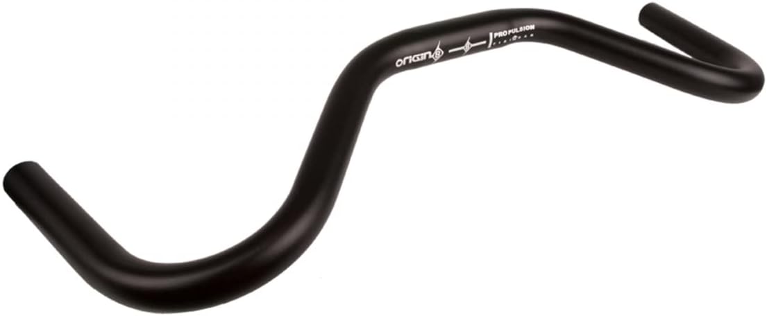

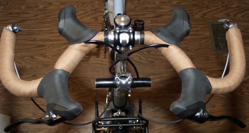

There are 110 adjustable riser stems that work with backswept bars. I am not showing this because it would be for you. Only to show that there are all kinds options. I might use something like this to convert a dropbar gravel bike so I can reuse the dropbar levers. It is called a moustache bar. I don't know why. You wrap it like a road bike. The shifting on that bike is in the lever. I am not sure how well that will work. This spanking new $1900 bike has been sitting here for almost two years. Got it with a bunch of others when a bike shop owner ripped me off with a bunch of others and closed the shop. It went there with four guys just before he closed and took a truck and trailer load of new bikes as a settlement.
The Daffed part is that my first e-bike came with that very same adjustable riser, and it would have worked perfectly for me.
It didn't occur to me to just rotate it 180` 😁
Instead, I bought and installed a new riser and handlebars, then bought a $70 windshield to cover up the ugly mess.
