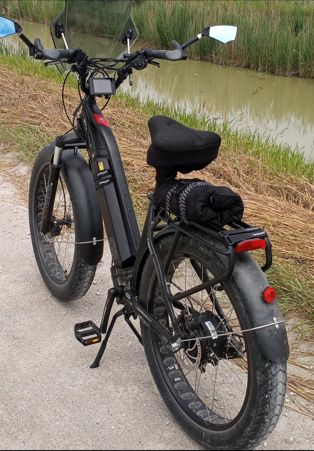

The rear tire looks reversed tread wise. Am I correct?
No, the arrows formed by the sipes in the tread point in the direction of rotation.

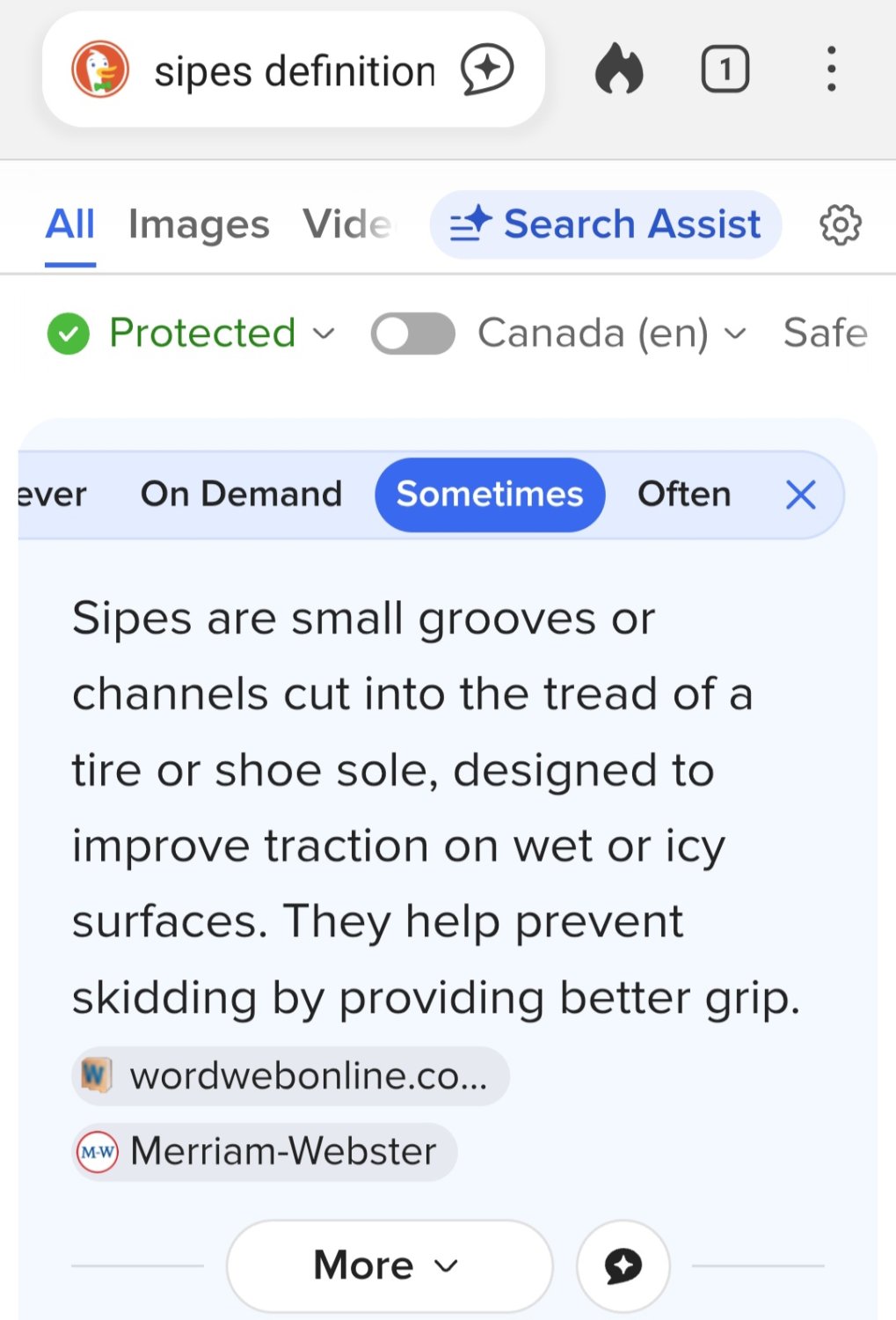

I thought that the sipes were all about channeling water, but there might be more to it?

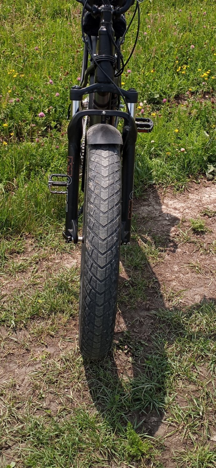

These pictures show it better,..

Directional tires have arrows printed on the sidewalls as well (your tires will have them.)

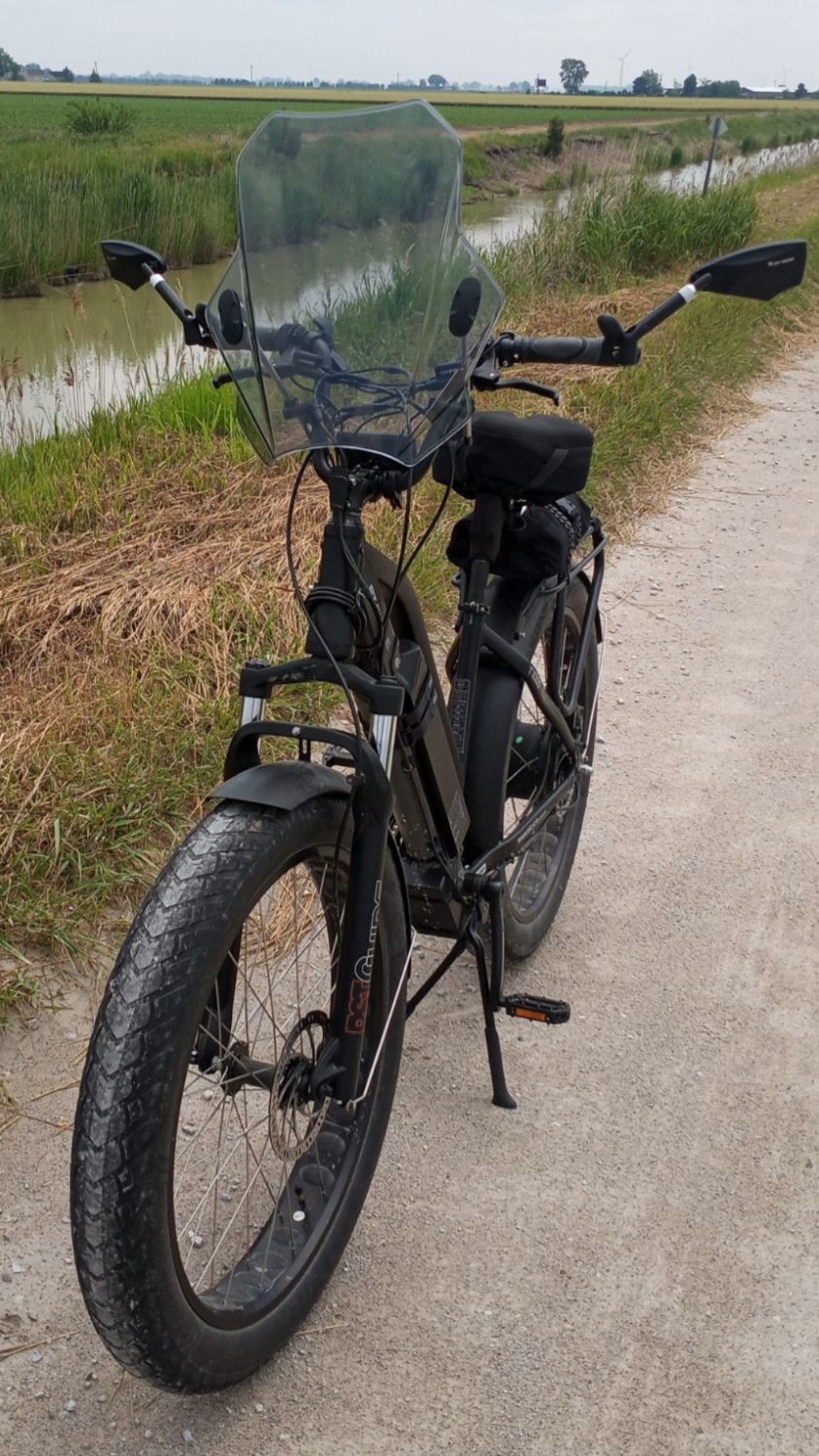

Sorry, I assumed that tire was the back tire. With a closer look I see I was wrong. They are correct as you say. BTW: Nice Bike! Where did you get the windshield? :)
