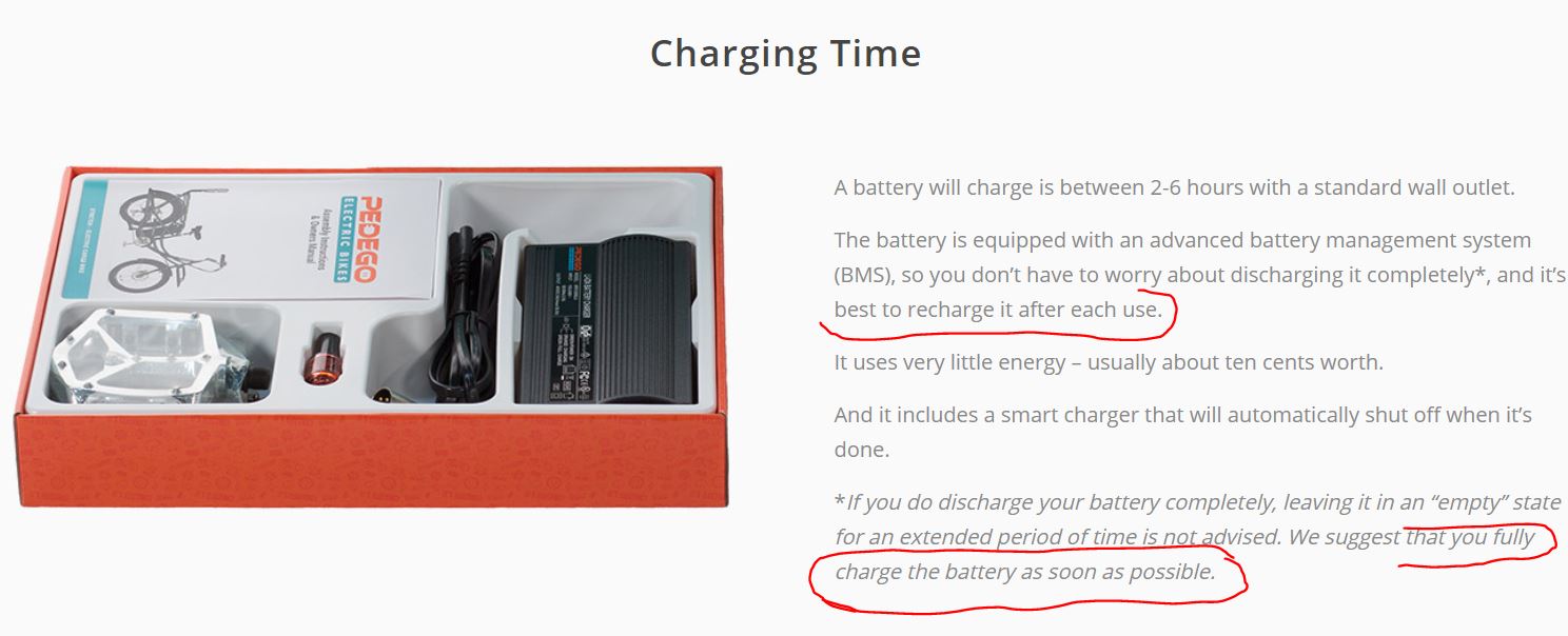

Hi @Alaskan , As a owner of 3 Bosch battery packs, I am yet to find a suitable, satiator-type charger for Bosch powerpacks. I have been using rough gestimates (stopping the charge when the 5th LED blinking) and my packs have sustained good amount of capacity even after 1.5 years. Until you or I find a better solution, that's what I am going to use.
@ebikemom , glad you found it useful. Pedego as a company is very responsive to any warranty claims but it is smart of you to be proactive and try to get max battery life out of your bikes. They have had their fair share of battery pack issues by using generic cells and battery design that resulted in a battery recall of 5000 packs.
https://www.cpsc.gov/Recalls/2015/pedego-recalls-electric-bicycle-batteries
Since then they have moved towards better designs and higher quality cells. I hope your dealer is a friendly one. Some dealers think you are being too anal about small details and they may not know the implications of charging to 100%. But, in the long run, your batteries will outlast other batteries on the field even after heavy use. But, I don't expect them to be experts at battery design. They still have this going.. https://www.pedegoelectricbikes.com/battery-details/#charge

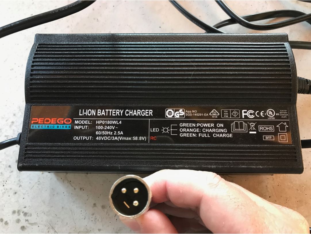

You're right. That's a male XLR pin. @Mr. Coffee posted this image a while ago. You could get XT 60 to XLR-male pin connectors for a Luna charger.
You have already found the solution. Using a timer can be an inexpensive option but it does demand little bit of cognitive effort in terms of guessing the existing charge and time needed etc. Since you say you your use your bike quite a bit and you have 4 pedego bikes, it would be good to have a satiator and by default it comes with a male XLR plug. If you have the 48V, 15Ah battery then it would be a worthy investment for a household of 4 E-bikes because $300 amortized over 3-4 years for 4 batteries is quite cheap.
