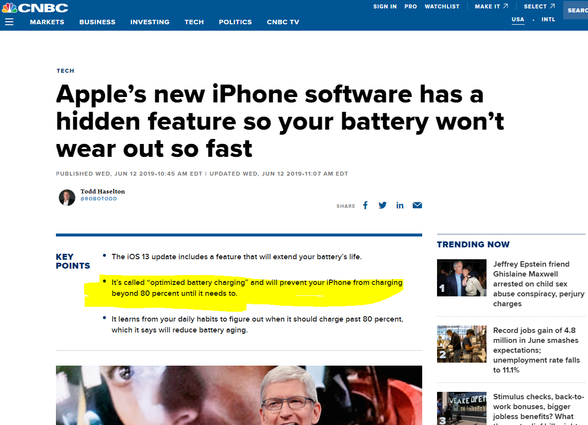

Apple noticed that most people plugged in their phone overnight and the battery was losing capacity rapidly after a year of constant usage. So, in 2019, Apple introduced this new battery optimization feature along with their iOS 13 .update
The machine learning algorithms at Apple servers know that you plug it in at night let's say 11pm and wake up by 6.30am (an approx routine for most people). So, the battery plugged in for about 7.5 hours. With the new iOS13 update, your phone will charge to 80% when you plug it in at 11.30pm and wait until 5am for the last 20%. From 5am, it will start charging from 80% to 100%.
By the time you wake up, it is at 100% but it has spent much less time at 100% charge. Time spent at 100% charge is bad for battery health.
In my opinion, it is one of the well thought out but under-rated feature of iOS 13 update.

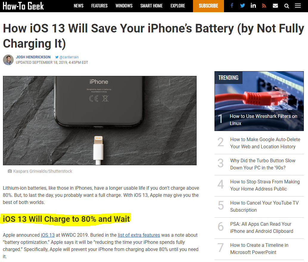

How iOS 13 Will Save Your iPhone's Battery (by Not Fully Charging It)
Apple's iOS 13 update will protect your iPhone's battery health---by "reducing the time your iPhone spends fully charged." Here's how that works.www.howtogeek.com

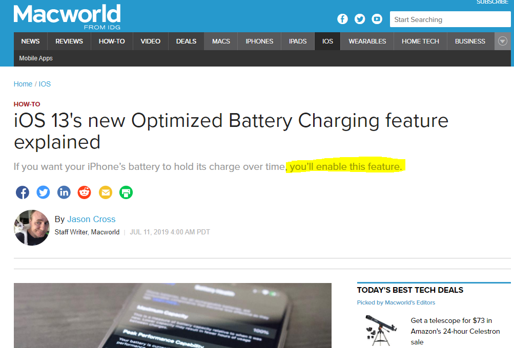

iOS 13’s new Optimized Battery Charging feature explained
If you want your iPhoneu2019s battery to hold its charge over time, youu2019ll enable this feature.www.macworld.com
