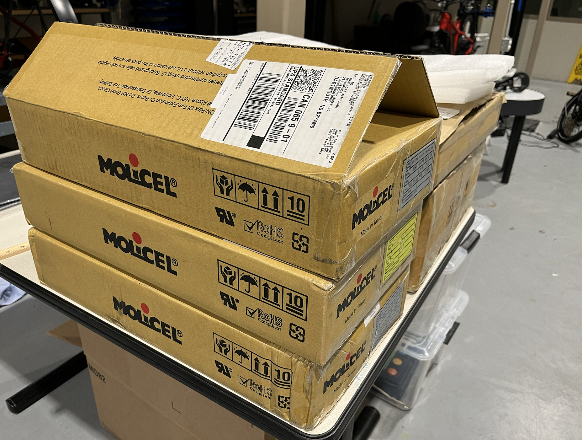

Let's not do Molicell or the pack will be more expensive then the ebike
We just received 500 Molicells for our prototype builds and these are meant for electric boat batteries.
I think E-bikes do not need this much power. Grade-A cells from LG or Panasonic or Samsung with robust connectors and BMS and what we see is that most E-bike batteries have just bare minimum safety and very primitive BMS.
