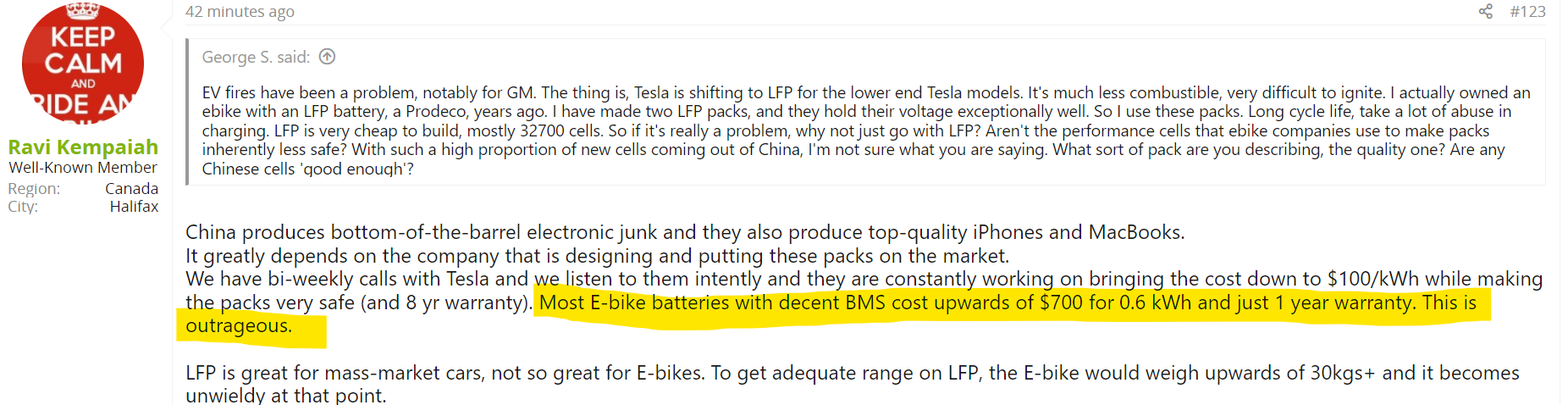

China produces bottom-of-the-barrel electronic junk and they also produce top-quality iPhones and MacBooks.
It greatly depends on the company that is designing and putting these packs on the market.
We have bi-weekly calls with Tesla and we listen to them intently and they are constantly working on bringing the cost down to $100/kWh while making the packs very safe (and 8 yr warranty). Most E-bike batteries with decent BMS cost upwards of $700 for 0.6 kWh and just 1 year warranty. This is outrageous.

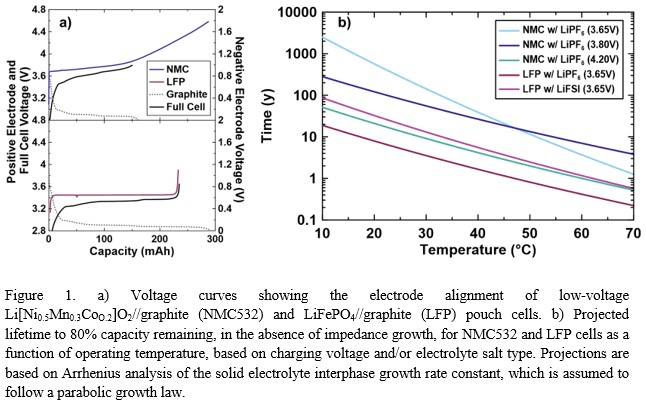

LFP is great for mass-market cars, not so great for E-bikes. To get adequate range on LFP, the E-bike would weigh upwards of 30kgs+ and it becomes unwieldy at that point.
As you can see from the latest paper from our lab. NMC cells can have 2x or 3x the cycle life of LFP and when amortized over time, it would be cheaper.
LFP is rated for 15-20 years, and NMC can have anywhere from 30 years to 100 years depending on the voltage window. When you recycle NMC, you get Ni and Co (which are valuable) and when an LFP cell is recycled, it has minimal value and in the battery communities, there are lots of discussions about the recyclability of LFP.
NMC can also be made very safe.
Paper link: https://iopscience.iop.org/article/10.1149/MA2021-0251893mtgabs/meta

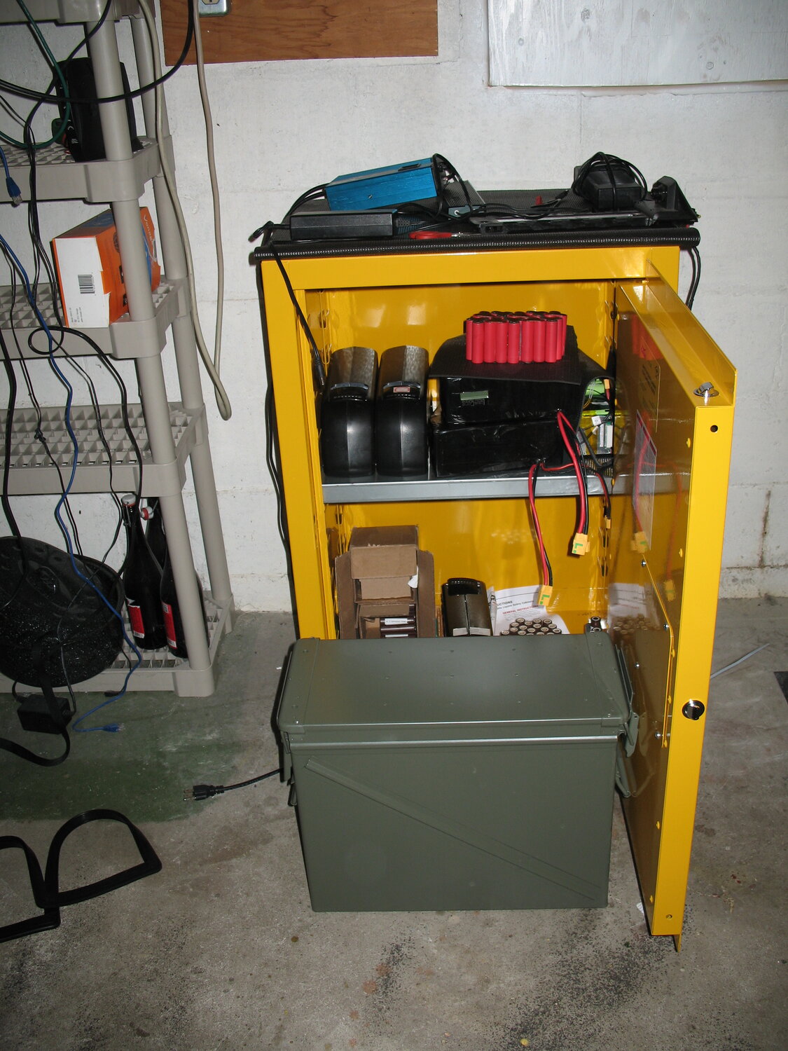

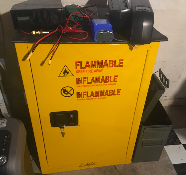

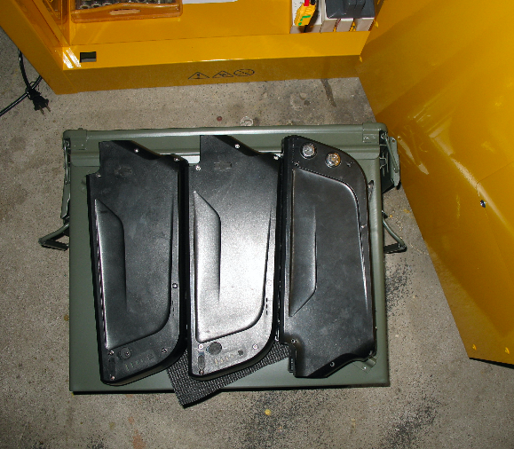

Lately, I've been looking at steel flammable storage cabinets as an added layer of protection. Is this overkill? Am I just being paranoid here?
Lithium cordless tool batteries have been around for a decade or so in the hands of hapless consumers. The number of fire related reports caused by this equipment is far less than those I see on e-bike and other hobby related lithium batteries. Is this due to use, size, cell quality or something else?
I think that tool batteries may have better battery controllers.
I'm definitely in the safer the better club. I waited until Zoro had a sale and shipping discount and bought a safety cabinet AND large ammo can. Because I ride all winter days with dry streets I'm stuck charging indoors.
When I think of the cost of having even the smallest battery fire, the price is minimal.

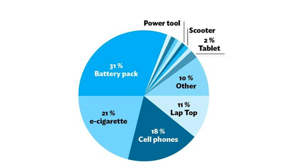

"Most lithium battery fires are caused by cell-phones, vape pens, and laptop computers. It is rare to have an incident with power tools. As the lithium battery technology develops, these fires are on the decline yet they still occur. Be very careful when buying replacement batteries for any device. The vast majority of battery failures are due to shoddy-made batteries and counterfeits made in China. The most common distribution of these defective batteries are sold on websites; the most notable being Amazon."
"There are two basic types of battery failures. One occurs at a predictable interval-per-million and is connected with a design flaw involving the electrode, separator, electrolyte or processes. These defects often involve a recall to correct a discovered flaw. The more difficult failures are random events that do not point to a design flaw. It may be a stressful event like charging at sub-freezing temperature, vibration, or a fluke incident that is comparable to being hit by a meteor."
