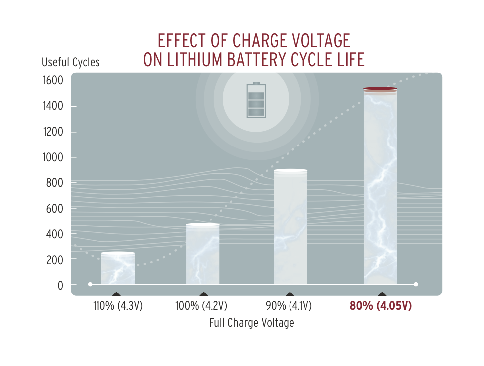

    You can double the cycle life of your battery by charging it only to 80%. Here is a neat infographic from Grin Tech in Canada, one of the innovators in the space.

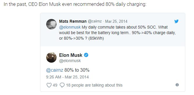

    Everyone in the electric vehicle space knows who Elon Musk is, so I am attaching a pic of his response to this question.

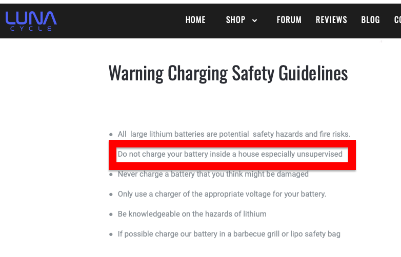

If anyone is still reading this thread - I just bought a Luna charger with an 80% cutoff setting. Is it okay to leave it connected overnight if I set it at 80%? I am not great about remembering to go out to the garage and unplug
it (which is why I bought a charger with settings instead of my original one). So will it give me fewer cycles if I charge to 80% and then leave it plugged in until the morning? thx.
NO! It's not OK to leave a battery charging unattended. If you must get a timer that will shut the charger down. They are cheap.
Luna is cavalier, more so than any other reseller.

It is not in a house, it is outside in a garage, lol. What I want to know is whether the charger, when set at 80%, stops charging even if plugged in. I'm not asking about fire safety. I'm asking about
the effect on the battery. I'll unplug it just as often as I unplug my current charger, which means sometimes I will forget. I've had ebikes/batteries for many years and still haven't blown myself up.
If all is right with the charger, it does stop charging when it reaches your 80% setting.
But still not a good idea.
Add a timer and be certain the charger is shut down and not cycling.

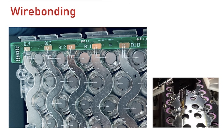

Wire bonding is the method Tesla, Lucid, Rivian etc. use in their batteries. A proper design with Wires + bus bars + advanced BMS offer a level of build quality that can handle high-G forces acting on E-bike batteries.
dont they also have water or fluid cooling too?
