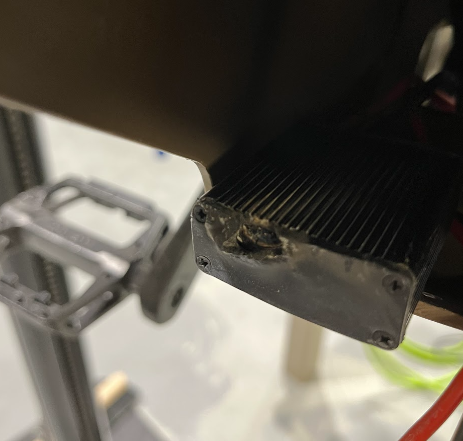

Early this Spring, we were testing a dual-battery balancer module using two 52V batteries, and this electronic piece caught fire.
I am so glad that the battery was not affected, but it burnt the battery base. Since then, we have been wary of dual battery balancers because the QC can vary widely and you need to have done your due diligence before using something like that. One fire can ruin all the fun. At least make sure that the dual battery module has UL-certification.
Until we are confident of long-term safety, on most of our bikes with hub drive or custom mid-drive, we will only offer single battery versions. We were lucky that this incident did not happen with any of our customers, and our testing efforts helped us identify this issue.
So, the takeaway is, if you don't know the source and don't have full engineering details of the wiring and electronics, be very cautious using dual-battery module with high-voltage batteries like 52V. If you have positive experience with dual battery modules on hub-motor bikes, please do not hesitate to share.

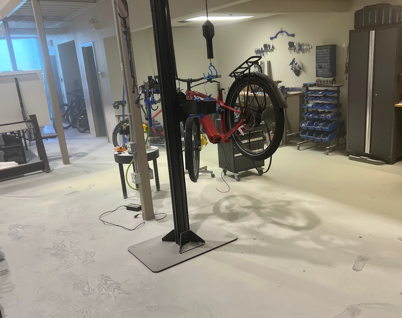

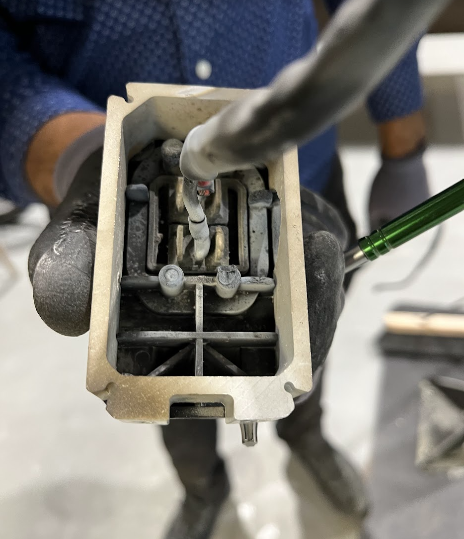

Some pictures of the incident at our facility.
Burnt battery balancer module.
Semi-burnt battery base
Our testing area after using the fire-extinguisher

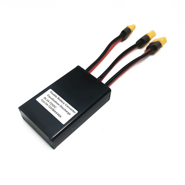

Another sample we are testing, and we have a few samples like this.
Something such as this needs to be constructed with only the best quality components.
I've seen many of these on Amazon, eBay and Ali and have never felt confident enough to purchase.

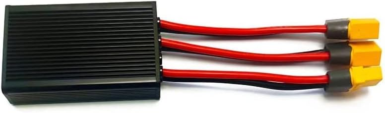

Of the units that you are testing.. are they paralleling the batteries or switching between as the voltage drops?
ya too bad you canto do it like bosch just sip form each one one at a time.
We will have to engineer a solution like that, and it can be done, but it would cost $500K to get this into production. Bosch has done an excellent job!

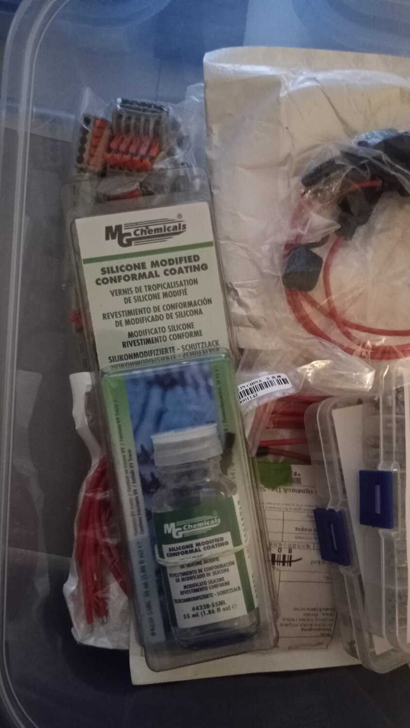

If the PCB inside that box is conformal coated be aware, that the coating is highly flammable even after it's set and will continue to burn after voltage is removed. Conformal Coating is used to keep moisture away from the circuits, but if something overheats on the board it quickly catches fire and spreads. It's also very difficult to rework a board that's been coated.
Thanks for that tidbit. 👍🏻👍🏻
I was planning on coating the circuit board in my controller of my new e-bike.
I have now changed my mind.
