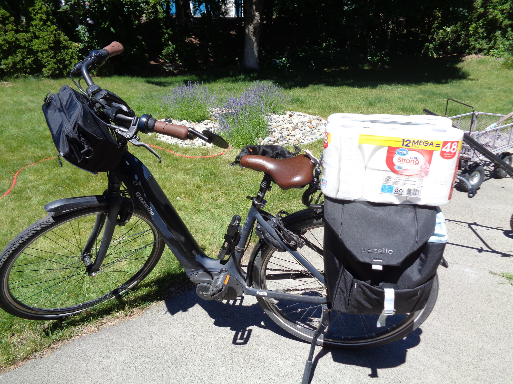

We have both a mid-step through and a high-step Gazelle ebike. I don't regret getting the high step due to the extra strength and rigidity it provides (I am 6'6" and 275lbs - big guy). My wife is also tall but wanted the low-step but it was not available, so she got the mid-step. I like both, and if I was lot smaller and didn't need the strength of a diamond frame, I would have opted for the mid-step through or possibly the low-step through. I'm 67 and don't have any issues getting a leg over the top rail now, but in 3-5yrs, who knows.
Also, note that there are different ways to mount a high-step bike that you might find easier.
- I like to place my left foot on the left pedal, push off with my right foot, and then swing my right leg over the bike. Starting from pedal height vs from the ground is a lot easier for me. This also overcomes most issues I might have had with items on the back of the bike, as one is much higher when swinging their leg over when standing on the pedals. I started doing this when I was a kid riding my older brother's bike, so it is natural for me.
- You could also lay the bike over (toward you) and swing your leg over. This works well as long as you don't have much weight in a trunk bag that sits high on the back rack, which can cause the front wheel to come off the ground at times. Mostly not an issue, but I have had this happen a couple of times when I had some heavy items in the trunk bag.
Hope that's helpful.

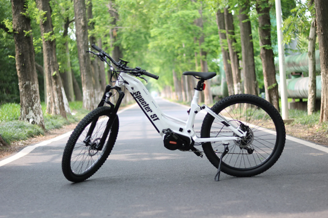

My Specter ST looks pretty robust and reinforced, I know the battery section is hollow but it looks like it will hold up. The bike has a payload capacity of 440 lbs. and has a five-year warranty on the frame.

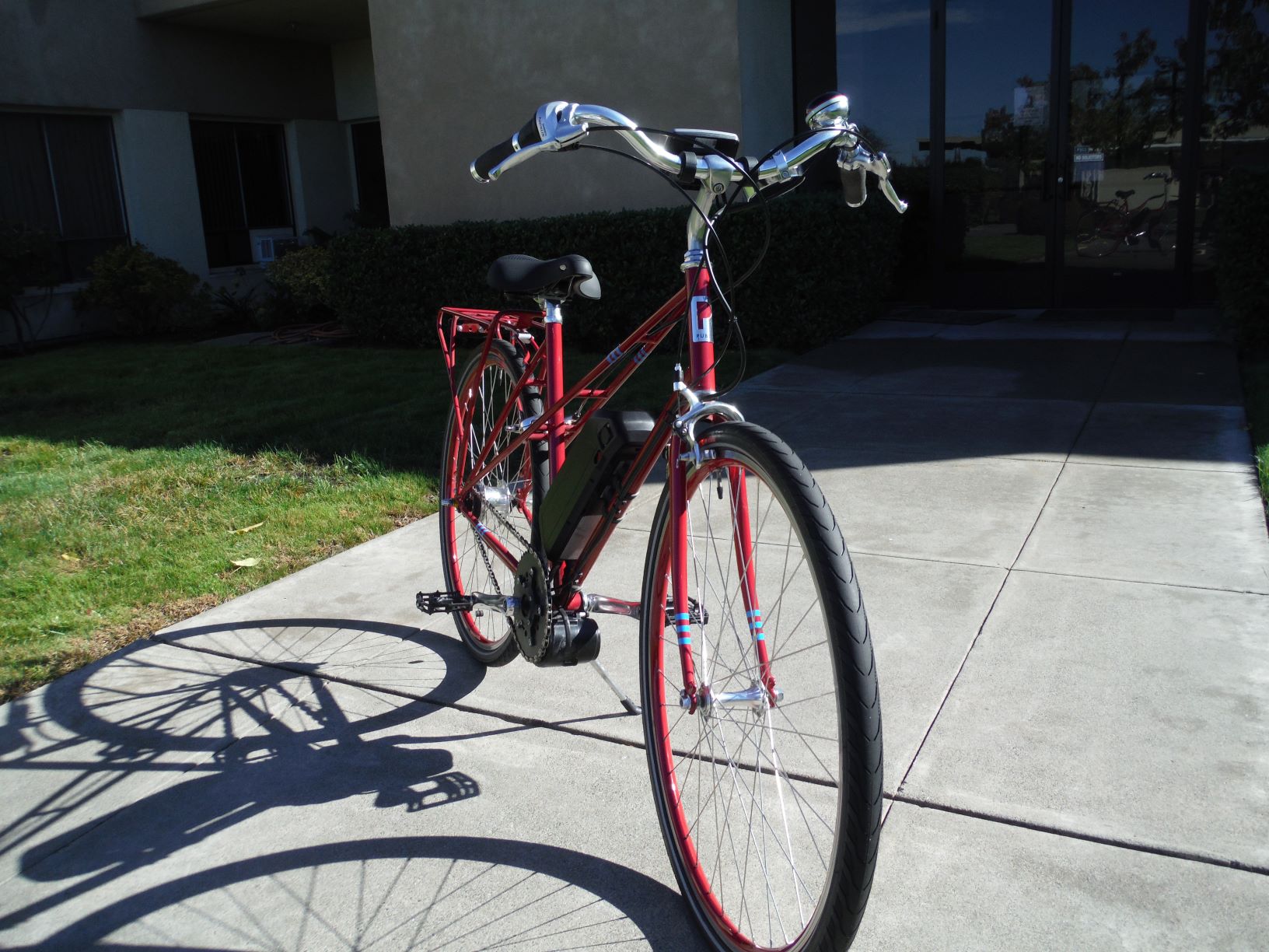

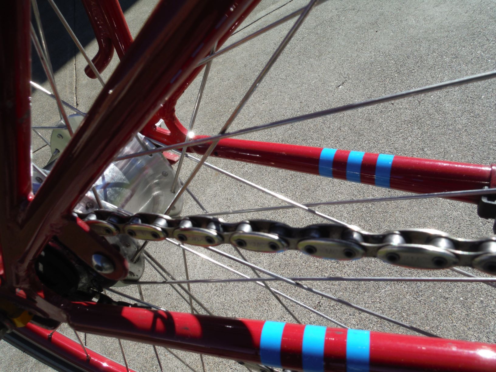

Mixte and a Diamond

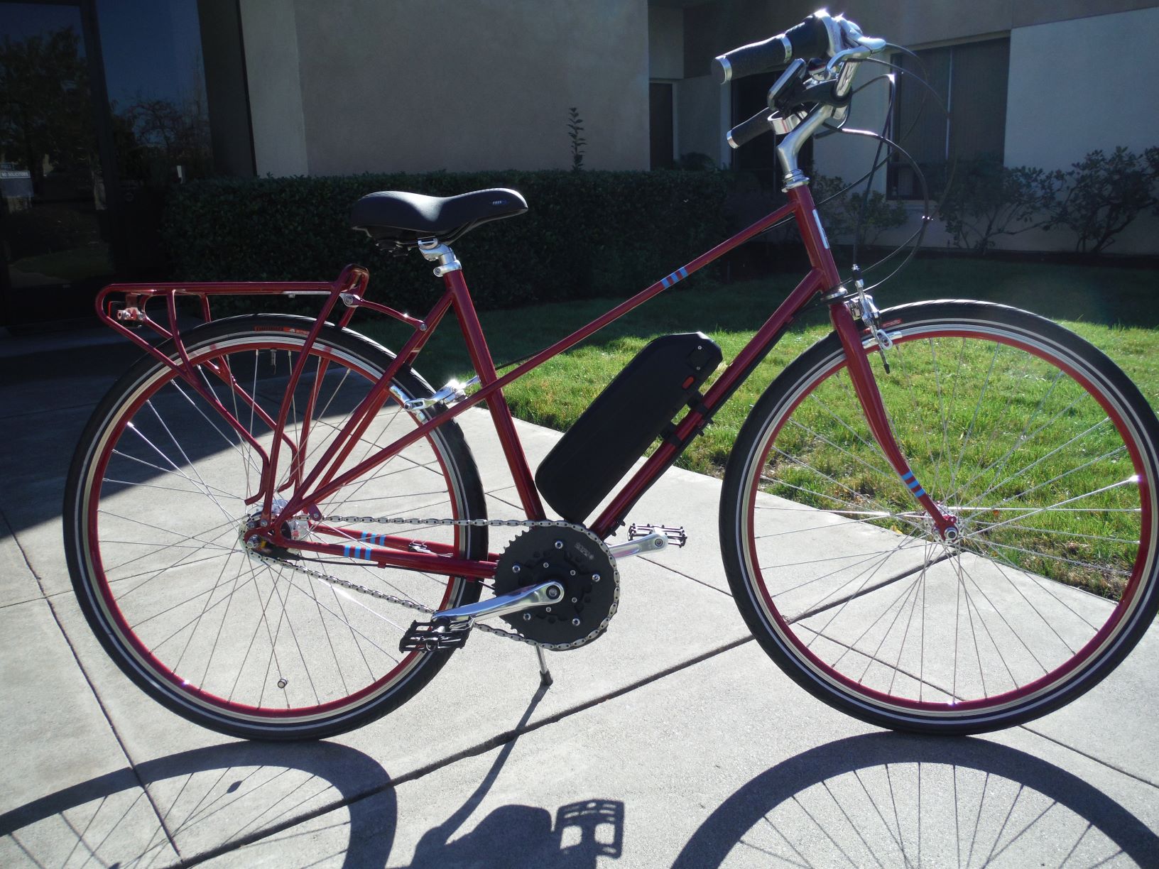

They are both strong. The diamond is stiffer. The Mixte more ductile. One Al and Carbon roadie, a former boss, described one of my mixtes as a wet noodle. They are forgiving and have flex. It makes the ride smooth. Race bikes like race cars give a harsh ride. Would you want to ride a race car to the supper market? They are stiff as heck. I haven't made an electric mixte in four years. Back when batteries were hefty.
Wow - that is quite the payload! I'll have to keep that model in mind for future purchases. Everyone in my family is tall/big. My daughter is 5'7" and we all refer to her as "tiny"!
Regarding my earlier comment about getting the high step model Gazelle, in the Gazelle literature they state they test their bikes to a German standard where they use a 285lb rider.. . so rider + bike weight. Since this includes the low step models, one would assume they could also support the 285lb rider. Gazelle goes on to state that customers wanting more strength should consider the high step model, which is why I chose it for me. Just an extra margin for error.
Cheers!
